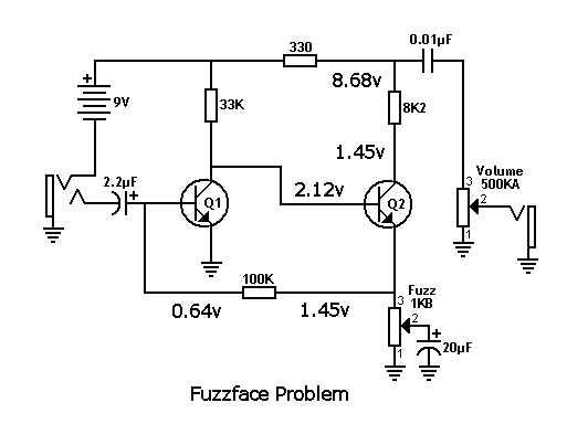

The voltages suggest Q1 has 8ua flowing into the base ,but does it? 8ua is more than enough to switch it on and so give 0.63 volts .I still believe this is the area where the fault is .
Careful with that voltmeter Eugene!
Ok, so 8uA base current into Q1 and 0.64v on base...(thanks a bunch Eugene!) 😀
Humble pie for me epicyclic.
About 200uA down the 33k connected to Q1 collector, 0.67v across the b-e junction of Q2 and as with the previous set of err...."readings" (rrrrr!) Q2 b-c junction still forward biased.
Voltage at node between 330 and 8k2 indicates that the gain off the transistor you've used for Q2 is too high for an 8k2 resistor in that location. Either test and select a lower hfe transistor (it is worth the bother sound wise) or just drop the value of the 8k2.
Incidentally, the "C" at the end of BC109C means it's a high gain type, not so good in this application.

@Simon: Thanks for the floyd reference and the greek lesson, not to mention the nice pic 😀 It's not 109Cs though but BC 108 (no suffix that I am aware of).
So, any suggestions as to what values to try based on these numbers?
Yes, I'm aware of that. With 1.45V across the 1K, Q2 has no choice but to saturate with the 8.53K collector load and 9 volt supply. It would work with a 24V supply, or simply reduce the 8.2K to something like 4.7K to get the collector of Q2 to mid supply. I think the 1K and 8.2K were predicated on using Germanium transistors.
If the Fuzz pot is correctly wired and the capacitor on it is good, rotating it will not affect the bias of either transistor.
The voltage at the emitter of Q2 looks about right to me, feeding through the 100k resistor it gives about 8uA bias current into the base of Q1, which should be bumping along the bottom rather. Negative input half cycles get clipped first.
Q2 has reasonable forward bias across the base-emitter junction, 0v68, given the apparent lack of current flowing through it. I'd be looking at the 330R and 8k2 first of all.
Good point, 1.45mA is too much for the total 8.53k collector load. More humble pie for me Loudthud.

I'd go with Loudthud's suggestion of 4k7 to start with, but you'll probably need to cut and try for best results.
Any value is ok - even 0R shouldn't blow a BC108, given the 330R upstream. The max current that can flow is about 25mA, and a BC108 is ok up to 100mA & 300mW.
It is worth experimenting. Don't bother getting the old resistor off the veroboard, cut its body out to leave the two leads sticking up.
Then either temporarily solder resistors on or perhaps use a small bit of connector block, until you find what works best for you. Possibly try a 5k or a 10k pot or trimmer, connecting to the middle and either one of the end terminals to start with.

pot measures at 1,003K (and says 1K on it). I turned it all the way off and remeasured Q2, results:
b- 2,18 (i thought i'd include this as it also came in slightly higher) c- 1,52 and e- 1,51
rail (both at input jack and 330 resistor) comes in at 9,16
Just rechecked every resistor and the 33K resistor on Q1-c / Q2-b seems to be a 3.3K one. Damn! Can't believe i didn't think to do this before (or that I actually placed the wrong value in there). But does the 2,12/2,18 reading here seem too high? and could that be drawing the current that Q2 collector should be seeing? I'll have to change it to a 33K one and check back. I'll have to order new ones so if you think that my choice of transistors would prefer a different value in it's place give me a shout and i'll order some of those as well.
Both of these will prevent it working.
Always a good idea to check components with a meter before soldering in. Especially resistors and pots, are they're so easy, and so prone to confusion as to their values!
Have to admit that I'm now a bit baffled how the voltages around Q2 are so low! Where's the current apparently flowing through the 8k2 resistor going to?

BC108, without the C at the end is listed as having gain (hfe) in the range 110 to 800. Popular folklore has it that the ideal values of gain for Q1 and Q2 are 70 and 115, respectively, but you don't want to get too hung up on that.
BC107s, gain listed as being 110 to 450 would be worth a try.
At the moment, your accidental use of 3k3 instead of 33k in the base feed to Q2 means that there's loads too much current flowing into what is probably a high gain transistor at Q2.
As you've got a meter, do think about testing transistors for gain, as detailed by RG Keen / Geofex, at the page I linked too earlier.

I wouldn't try changing the circuit as per the runoffgroove schematic, at least not til you've got it working, though the point about getting the collector of Q2 around about halfway between the two power rails is a good one.
Good you feel like sticking on til you've got it working.
Don't stick anything like 30k in the collector of Q2 - if anything, you'll want less than 8k2, not more.
First of all get the Q1 collector resistor sorted - I'll mail you one if you want!
Also Eugene, please tell us, is the convention for decimal point/comma in Norway that 1,003k means 1003 ohms, or that it means 1003000 ohms - it varies country to country - I think in Italy for instance, it means 1003 ohms, but don't quote me on that.

Simon is right, just FYI that link was to give you some typical voltages to look at for Si transistors. Q1 needs to be under control or you will drive the base too hard on Q2. Once that is done you should check Q2 collector at halfway point.
Breadboarded the circuit earlier today for my own curiosity....results
BC107Bs
Q1.................. Q2
B 0.613V.......... B 1.330V
C 1.330V.......... C 3.18V (8K2 and 330R) , 5.03V (5K6 and 330R)
E 0.00V............ E 0.691V
mid point 8K2 and 330R 8.9V 5K6 and 330R 8.9V
