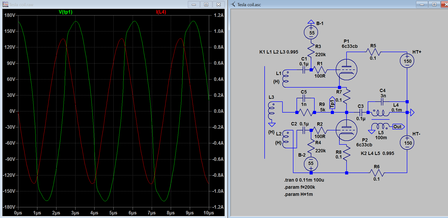

"Im curious to see this bad waveform you are seeing in your simulations… could this possibly be the area for my dilemma?"

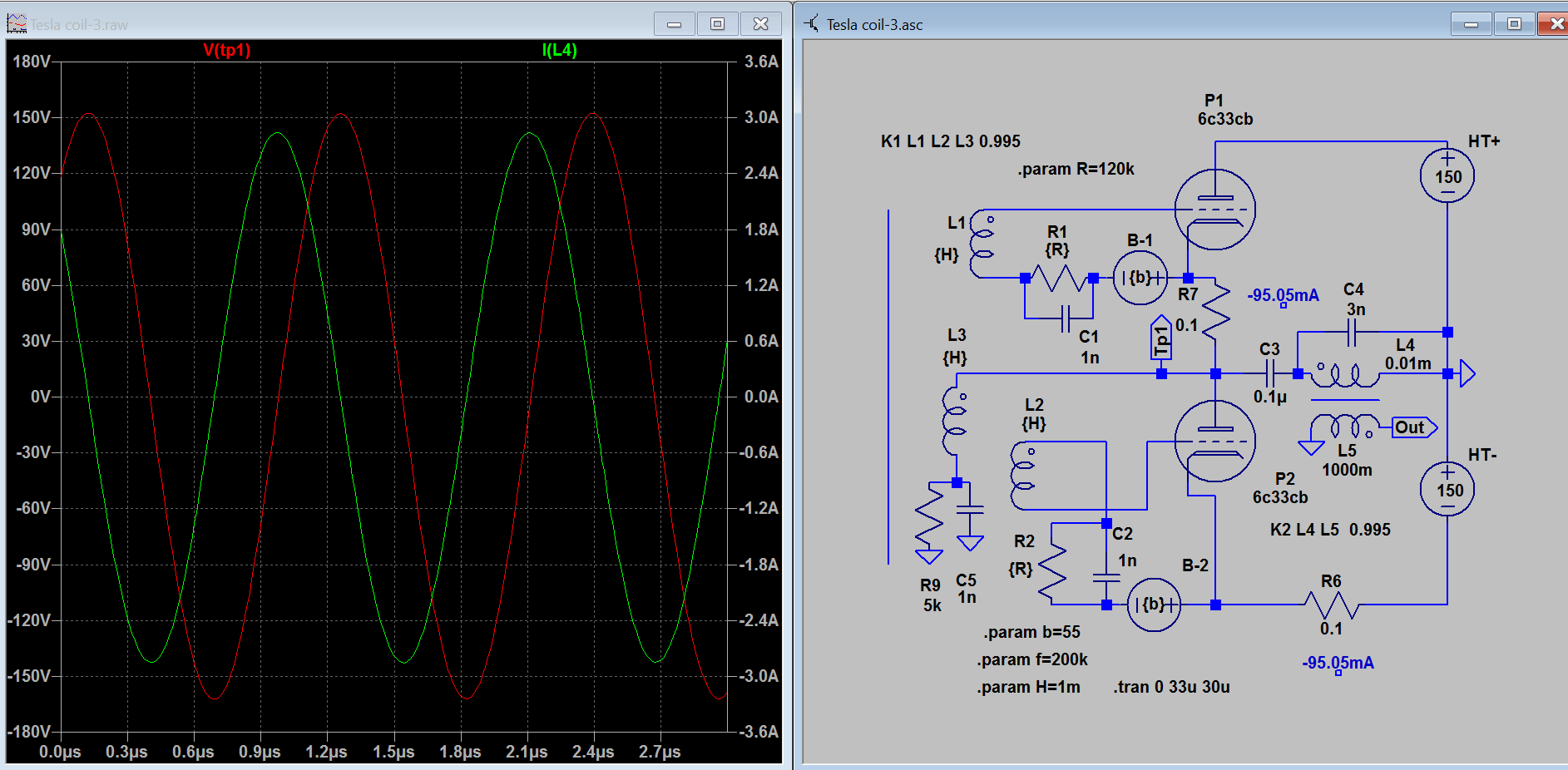

I found it's the value of grid resistor and cap that cause the distortion and large current pulse. Using 30k/50p seem to be ok, much the same as if separate grid leak circuit. So I think you can try to change the value only not the circuit for now.
"I also noticed that in your simulations that you put a smaller 50p bypass capacitor at the grid leak resistor as well. Do you think that the shared grids were causing asymmetric loading in your simulations?"
To same extend but not as serve as the component values in use, separated one is better as one does not influence the other, and it's combined value is not the same as separate one. A separate grid leak has fixed value free from interference.

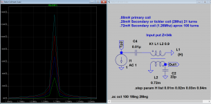

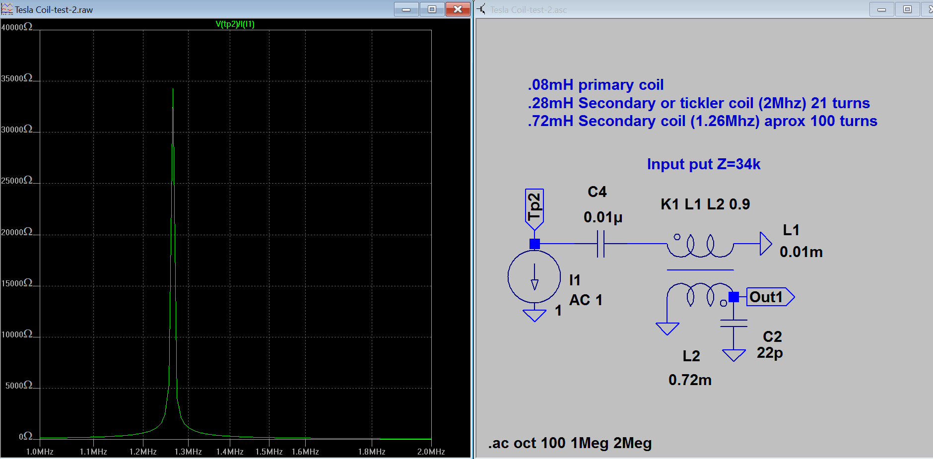

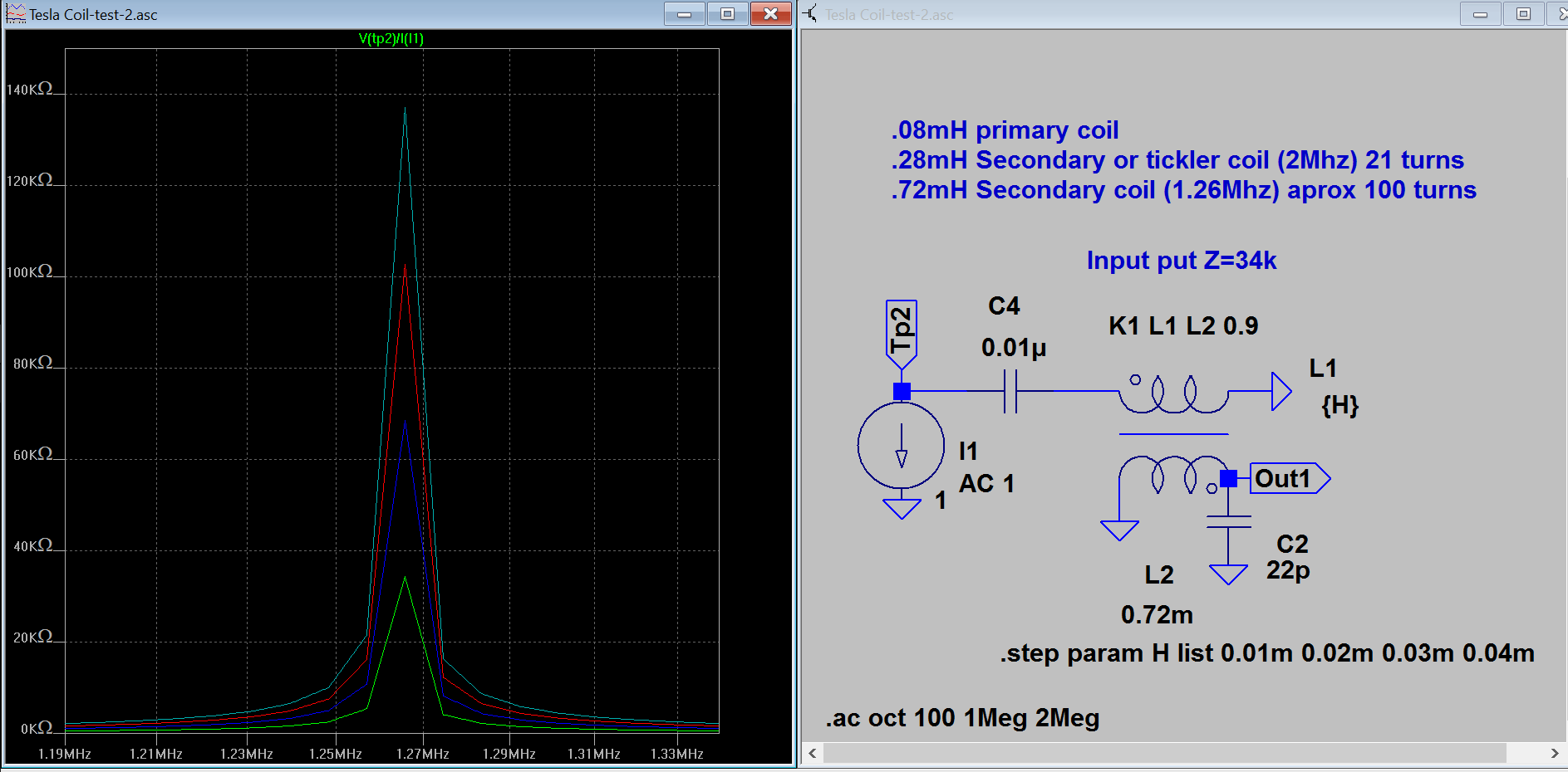

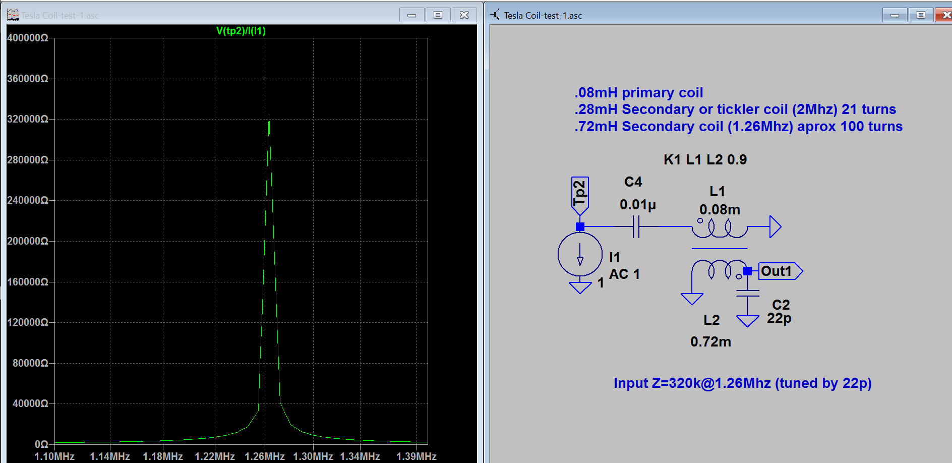

"In your post here, you show some different tapped turns in this impedance graph for the totem pole setup. Im having a bit of a hard time comprehending how the lower impedance tap will benefit the current draw… Maybe I’m conflating my short circuit like results (in my videos) with what I’m looking at here with the totem pole setup."
The final load presented to the output is important as maximum power can be only transfer with the output impedance matches or lower than the load applies. So if the pri has 1kv rms on the plate, to out 1A rms, the load is 1k ohms, and if Rp, internal resistance of tubes combined is also 1k ohms, the max. power is transferred, i.e the power on the load is the same power dissipated in the tubes, this the basic consideration. It's easy to get an oscillation but the power out is really unknown, unless you dealt as if design of Class C amplifier in mind. I have a telecommunication background, there are many theories we learn and forgotten because of lack of practice. So if you have a BE and don't practice in 5 years it's all returned to the teachers 🙂. This forum is a great place for practice and test of your knowledge.

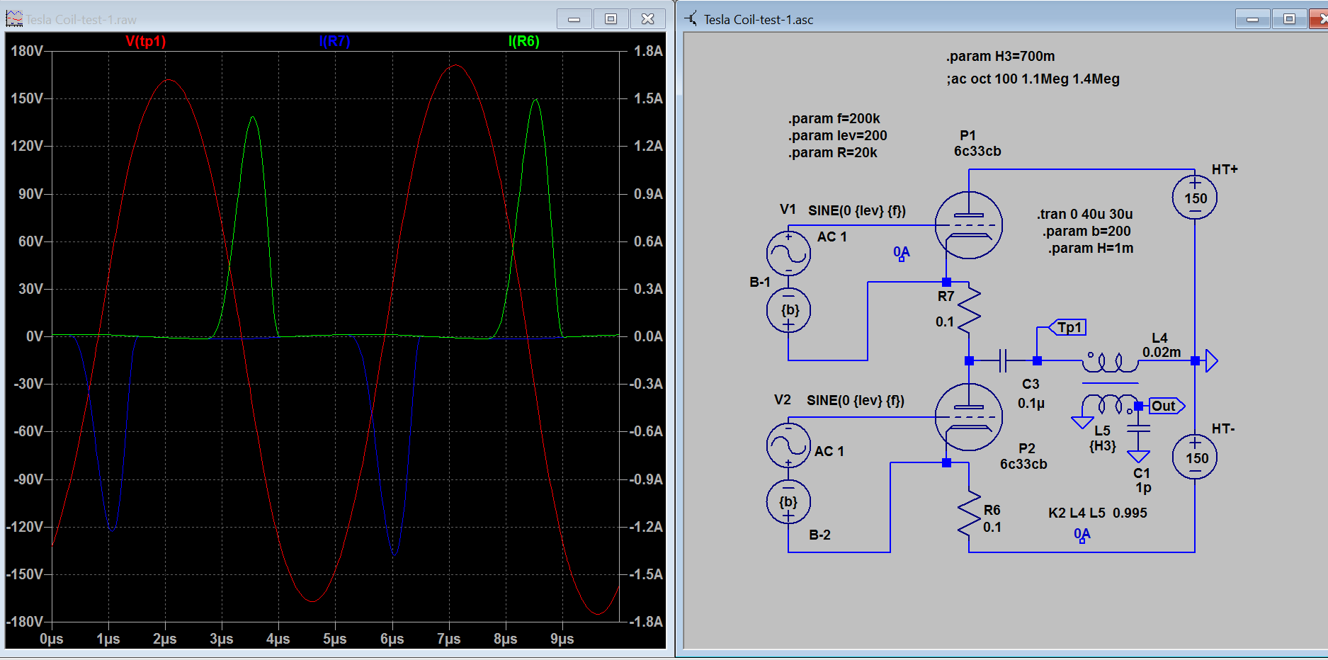

Increase the value of grid resistor reduces the drive width, level as well as the current in the cathode, it also reduces the conduction angle so the current pulse is narrower, which help to reduce overall current drawn. The other current limit can be done by add resistor in cathode, the current can be adjusted to same level and to desire gain level so the dissipation become acceptable.
Not sure you can pick up the drive level at the grid, you can try to measure it, maybe few hundred to few kv, the actual level that matters is the level above the bias level, i.e. < 600V.
