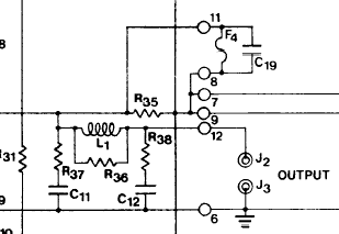

what about concern for output fuses, anyone?
Sherman and Peabody's "way-back" machine pointed me to the venerable (?) Hafler DH200 schematic (page 14) from which the pic below was cut.
The fuse is incorporated into the overall feedback loop. The cap across the fuse (C19) is a 4.7nF/100V film of some sort. The resistor across the fuse (R35) is 2K2 ohms/1W, probably carbon film in those times. I'm sure you guys can do better these days 🙂
Curiously, this approach doesn't appear to be used in the later XL280 or the even later TransNova stuff.
Have fun ...
mlloyd1
Have fun ...
mlloyd1
