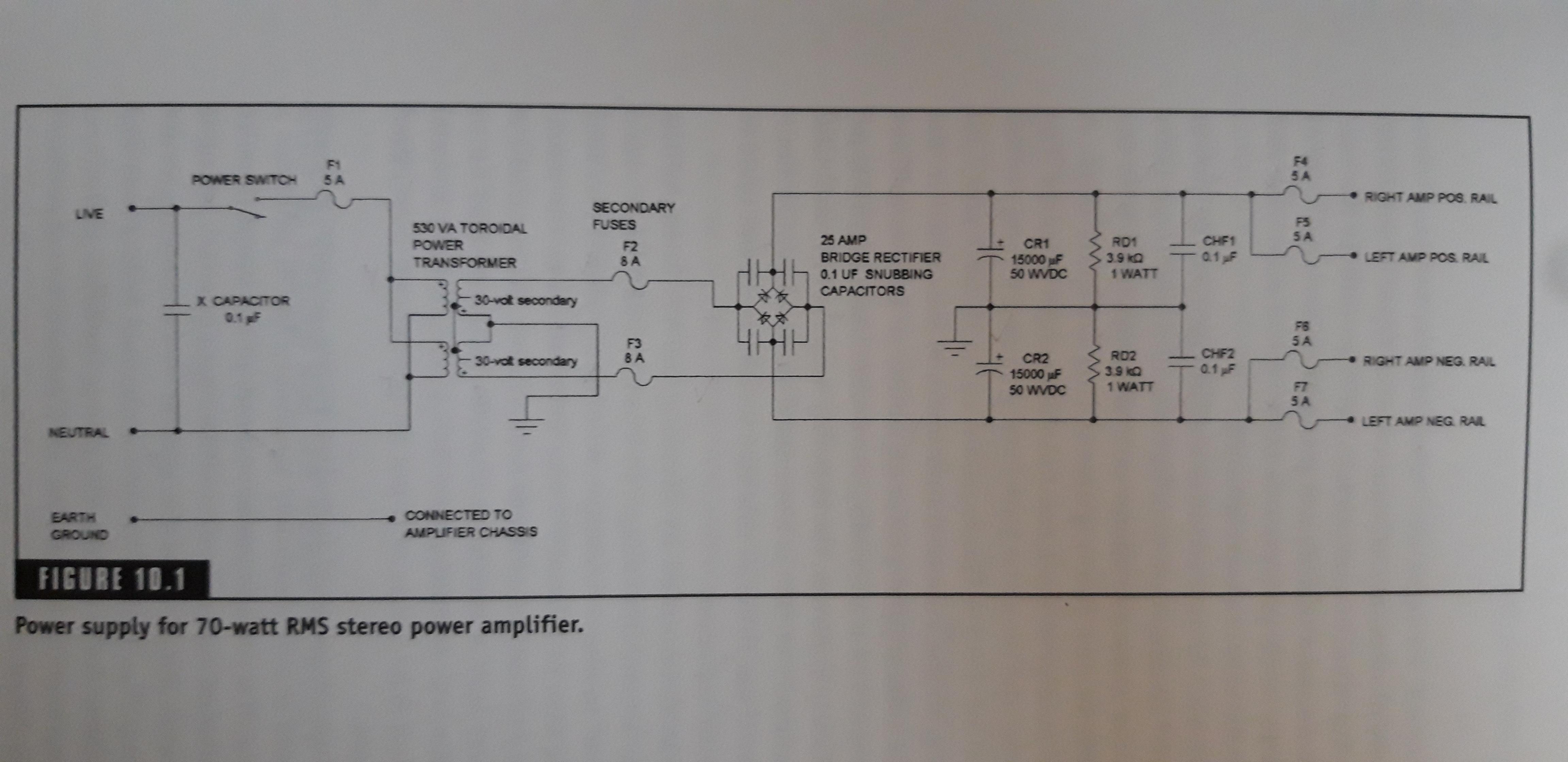

I'm building a very classic 50W class AB power amp in metal chassis.
How do you mount fuses on secondary windings and HT rails of a PSU?
I refer for example to Randy Slone's circuit at p.317, fuses F2 to F7.
Do you use in-line fuse holders, or some sort of buss blocks to be screwed on chassis like in car-audio?
