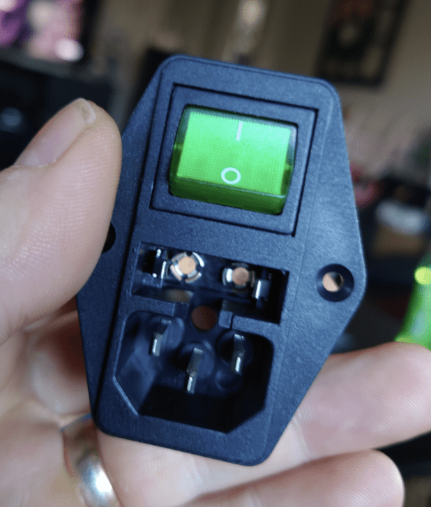

Can someone please tell me which fuse holder I need for this IEC inlet?? Also explain why Schurter wouldn't include this with the IEC inlet 😕. Thanks in advance!
Schurter 4304.6091 IEC
Hi. It looks like fuse cover is missing ,or needs to be ordered separately, that would be strange. Try to recheck datasheet, maybe it contains info about additional items or what's included. Or contact a digikey , maybe package was opened before?
Appears to be missing the little drawer. The datasheet shows it in place. Send Digikey an email, and that pic.

I definitely see fuse contacts and a window to fit a little tray, including the bottom cutout where a holding tongue fits.

I bought some IEC inlets that did not come with the tray just like that. Luckily, I noticed before completing my order, with Mouser, that they didn't include the drawer. I ordered them at the time but - WTF?
After talking on the phone with them and sorting this out, Digikey is (finally) sending me what should have come with this. Hopefully it's the correct part, after the phone conversation with their tech support I'm about 50/50 this might actually be the part I need lol.
