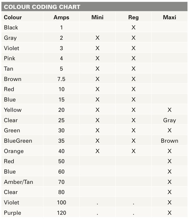

Here are the standard automotive blade fuse sizes and amperage ratings. I wished there were a few with ratings in-between 5 amps and 7.5 amps. I think I'll try both and see how it goes. 5 amps @ 4ohms = 100 watts, 7.5 amps @ 4 ohms = 225 watts. Anyways what's a few bucks for a little experiment that might just turn out to insurance. I'll let you all know how it goes. Thanks for all the replies
