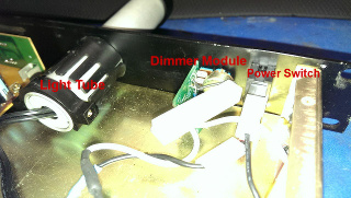

I have a Furman Power conditioner with two light tubes. Each has (had) a 3-watt(?) X-mas tree type bulb, dimmable. I want to convert these to LED's, also dimmable.
After looking around at conversion formulas, different LED's, resistors, the dimmer setup in the unit, capacitors, etc, I'm stumped, and I feel dumb. This ought to be easy! Can someone draw me a really simple picture? Maybe even specify the parts to order?
I'd like to put one really bright LED in each, or perhaps 3 purple ones, etc.
Thanks in advance!

I think what needs to happen is to step the 110 AC down to something like 12 volts first, but then I'm sure the dimmer won't work...

For an off-the-shelf solution... there are dimmable LED lamps in various form factors. Or, dimmable LED power supplies. That assumes that the Furman dimmer is similar to a regular dimmer, and puts out 120 VAC.
Starting from scratch, the "best" way to dim LEDs is to vary the duty cycle (PWM). The colour of LEDs can vary with the current, (at least it does with the white ones). Search ebay for PWM dimmer and you'll find various things with convenient knobs. Or, there's mini LED dimmer controllers for about a buck; those have push buttons on the board which presumably could be wired to a front panel control.

I think you probably just need to purchase a pair of dimmable led lamps to replace the ones in your Furman. Are these C7 type bulbs?
I think I figured it out. First, I can't use the dimmer in the unit, because it dims AC based on Voltage. I need a DC dimmer based on Current. So, I ordered a cheap one from China, I will disassemble it and use its knob in my unit.
Second, I have to both transform the voltage to DC, and step it down to 12 Volts or less. I think I can do this with any wall wart transformer. which will feed the dimmer the amperage it wants.
From there, I think I'm all set - just use a resistor calculator, wire a couple LED's in series and I'm good... I hope, LOL
