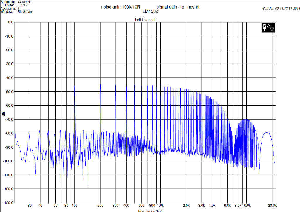

PMA reported Sensitivity of opamps to air coupled EM fields, especially of the LM4562/LME497X0 family are worse than others, measured on shorted input @ gain of -1. Perhaps shorting plugs can help on similar cases.A properly designed audio input circuit already has a resistor shunting the input. This product seems superfluous to me, even if it was reasonably priced.

I have not had a problem with excessive noise on unused inputs since the tube days.
It depends (partially) on input impedance and type of resistors used in the input circuit. It's worth noting that virtually all sources will shunt the input to around 100 ohms (it varies).
For testing, I short the inputs with shorted RCA plugs, or if testing a board out of the device I'll use alligator clip jumpers.
You could easily make quality input shorting plugs for a few dollars. Solder a 100 ohm resistor inside a couple of RCA plugs and you're done!

Sure, for me shorting plugs only cost a few cents to make. My only point is that a shorting plug should not be dismissed outright, there are situations where it may actually help.... You could easily make quality input shorting plugs for a few dollars. Solder a 100 ohm resistor inside a couple of RCA plugs and you're done!
