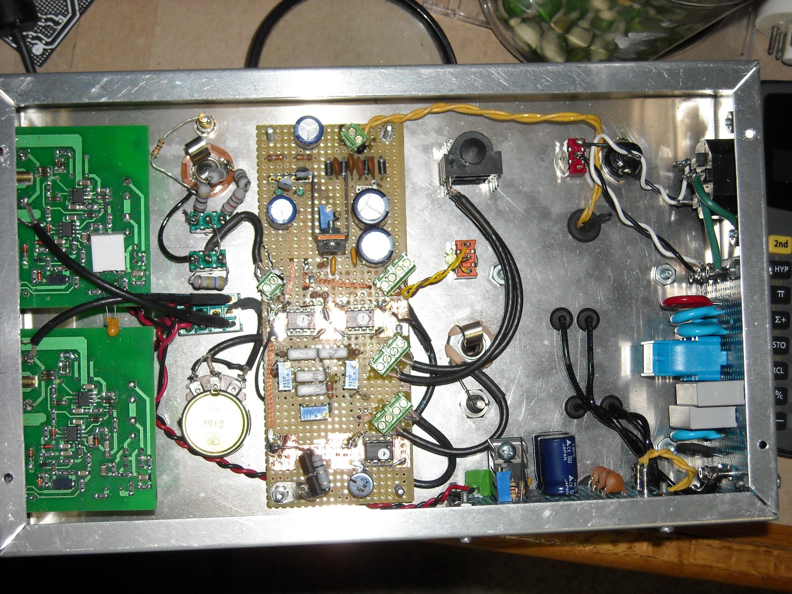

For less than $100 you can get the ASUS STRIX RAID PRO which claims 110 dB s/n on the input and 115 on the output.
Couple that with some software, a pc, a notch filter (if you are in this as a hobby you should be able to build one for less than $100) and the Cordell distortion reducer (<$200) and you should be able to get reasonable results.
Throw in an IG-18 and do "The Greening of the IG-18" mods (currently available on ebay for less than $100) and you have a reasonably low distortion variable signal source.

It's 20 Euros just to look at the schematic and see if you are interested. That probably doesn't help popularize it.
€2.99 actually Linear Audio | your tech audio resource
If you don't want to pay that then you are not serious about measuring anything.
Get serious this is a junk box project.
There are articles on the internet describing the function of the reducer. A competent engineer can design one from the block diagram.
130 Euro for a complete parts kit with PCB .
I'm too cheap to pay that much considering I have most of the parts.
I wish they still sold the PCB and critical parts as a sub-kit.
