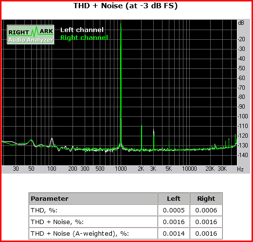

noise shaped dither specifically delivers more than the nominal 16 bit 96 dB dynamic range "at midband"
or the performance of US$150 soundcards
shows fine perfonmance in midband of underlying ADC, DAC - the math for proper dither would preserve the distortion performance, A-weighted noise could exceed 110 dB with RedBook
