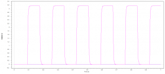

Some quick sims:
600mm-mismatch-200mm
200mm-mismatch-600mm
and terminated quickly to remove the effects of the mismatch.
Sorry about the different sizes did it in a rush as I am away on site (doing ANR stuff) and don't have access to my earlier SPDIF stuff.
In the real world though cables tend not to have an impedance mismatch, these will occur at connection points. I will also do better sims when I get the time and match the images better.

Oh the mismatch in the above example is over 30% - 75R down to 50R, never going to happen in a real world cable, unless you really twist the co-ax and change the geometry between the inner cable/outer sheaf.

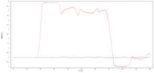

Er yes the original claims are for analogue signals. Impedance mismatches can be used to determine breaks in cables. As such even a 5% impedance mismatch in a co-axial cable will be down to some damage. When time permits I will do a more complex model of the cable, and try and model different types (co-ax, twisted pair etc.) like all simulation it does take time putting in all the parameters. here is a 5% mismatch superimposed with the slight difference shown in blue:
Will any of this be audible, no and I have also used worse case drivers and receivers and no termination, as soon as you add termination to match the line the cable becomes invisible.
Also did some modelling of 500mm Vs 1500mm cables, the 1500mm plot looks worse than the 500mm so the myth that a longer cable for SPDIF doesn't seem to hold water either, but again terminate the line and the problems go away (apply engineering practice and things seem to work!).

What, cause they are inaudible, this is a square wave, there is no correlation between the shape of a square wave and the resultant sound that comes out of a DAC, unless they are that bad to cause drop outs. The waves shown are worse case scenarios, but even these will be read and the data recovered correctly. How can these signals sound different from a neater wave, the crossing points where the gates will switch are the same for waves with ringing as they are for waves with the high frequency content attenuated by termination.
How can you think there would be a sound difference, for that you would have to put a DPS between the SPDIF output and the SPDIF input!
I am showing the effects of a severely mismatched cable being turned round, basic digital signal transmission, terminating the lines makes everything pretty so they are shown in the raw state with no termination, a driver that is over the top (faster rise time than required) so that the minute difference can be seen, and it is minute, but even these worse case scenarios will sound exactly the same...
Neither case will increase jitter to a level where it becomes noticeable, if at all.
