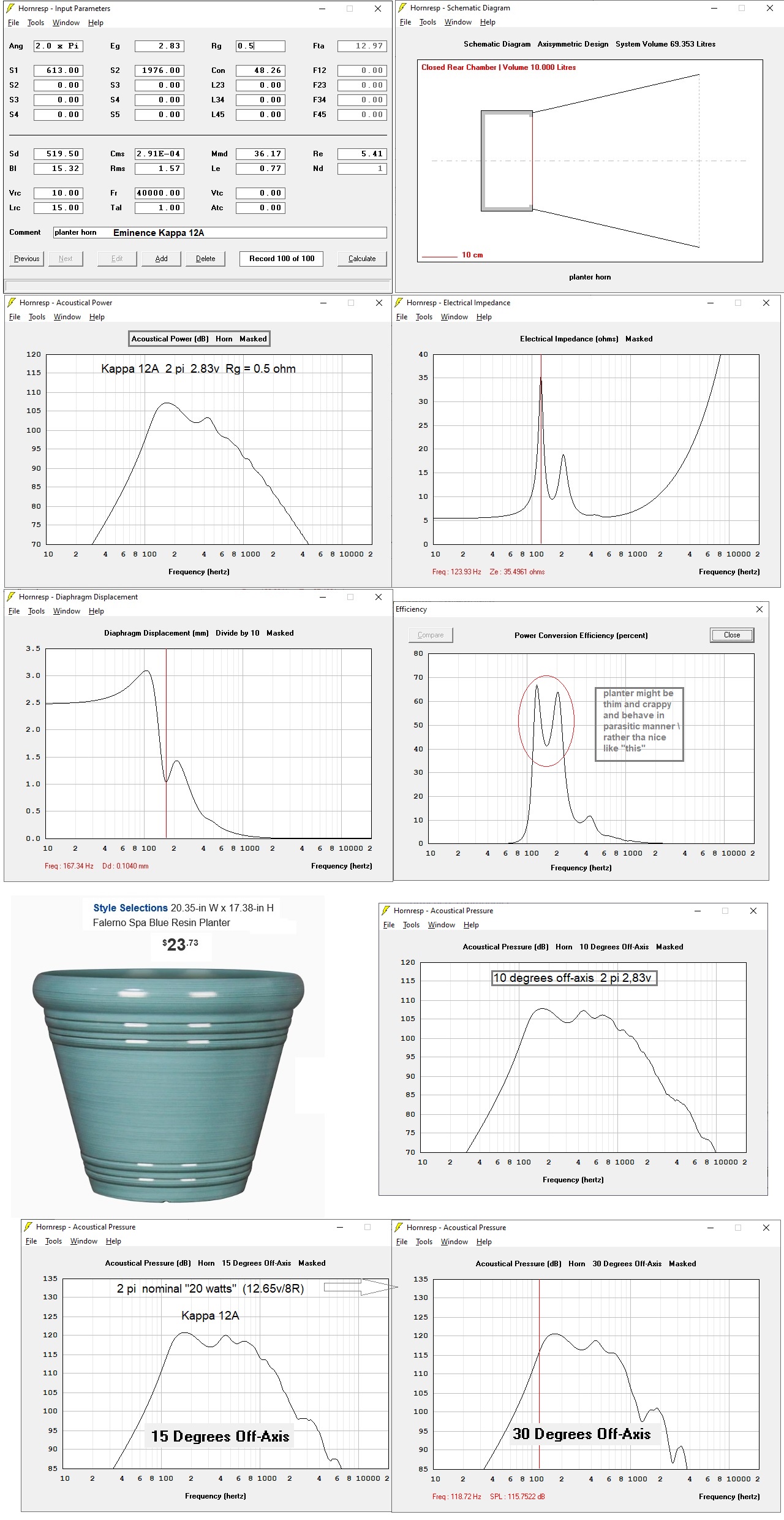

funnel of love - would a cheap planter function as a horn?
it would need a nearly ready made and cheap 10 liter back chamber
Hi AllenB
with expected top end of around 800Hz, perhaps the angle won't matter so much (?)
Without seeing the product I'll assume its something like a trash bin in its size and price area and may flex far too much to work (?)
Do you think the directivity response sim will ballpark its real balance?

I look at those things every time I'm at the store in the garden section and dream of what could be done with them. I agree with Allen, that pot would be more of a wave guide than a horn. Nice that you ran the Hornresp sims on that one. It works better than expected. :up:

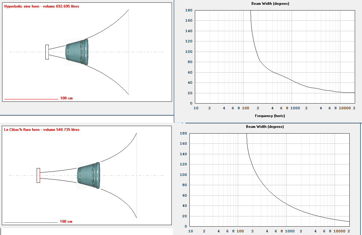

What we have is proof of concept regarding the beamwidth on the assumption of 45-55 degrees at 800 and 2 octaves. (Which was my first guess as to what Freddi wants)
In reality there's much to be trimmed. 😉
(reality sometimes ain't a good place to be)

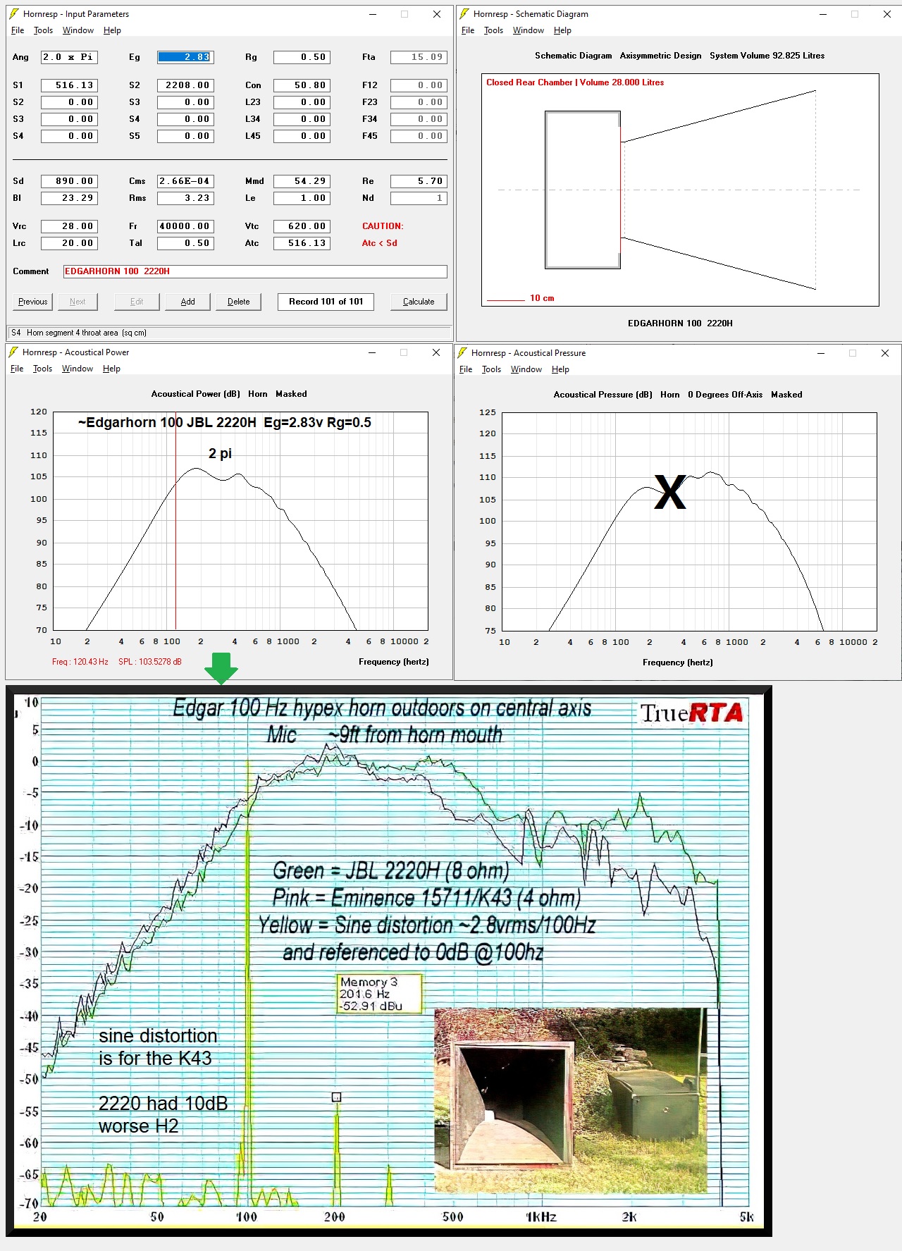

does the predicted rise considering directivity effects in hornresp occur with some speaker -horn combo and not others?
Consider my Edgarhorn100 midbass measurement vs a rough estimate of it with hornresp. The power response prediction looks pretty close to what I measured on-axis. (there may be a bit of rise - what do you say?)
