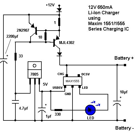

I'm posting the circuit used for the battery charger. The power PNP is heatsinked on the aluminum bottom of the project box, that's then mounted on the handlebars.
By itself, the Max1555 only charges with 300mA MAX and runs hot, but with a PNP transistor, you can make much more, while the chip runs cool at only 100mA, I get over 650mA of charge current.

Now I'm good with single cell Li-ion setups, but have to make a good charger for a multicell pack. I figure since this is the power supply design forum, battery chargers go here too.
I realize a 14.4V Li-Ion pack for a portable amplifier is MUCH smaller and lighter than a NiCd or NiMH of nearly the same mAh.
I also have a few questions, as everything I do is DIY and I'm always learning more.
Now a typ 3.7V Li-ion has absolute max charge voltage of 4.2V for max life. Very crucial it never goes over that for each cell.
In say, a 3 cell pack, should I just hook them in series and charge with 12.6V , or should I use special circuits to balance the cell voltage?
I'm thinking of trying to make a discrete charger for many cells, but if you know of any good IC's let me know.

If you are going to use muti-cell Li-Ion packs you should take into account a few precautions. Commercial cells are often equipped with an internal protection against overcurrent, and sometimes even over-voltage. If you don't know what you're dealing with however, it's better to make sure you keep the batteries within their specs.
- NEVER overcharge above 4.2V per cell
- NEVER overdischarge below 2.5V per cell
Then, if you want to extend the life of your cells, it is best to:
- Limit charge/discharge currents to C/2 or C/3 where C is the battery nameplate capacity in Ah
- If you're putting cells in parallel, you multiply the max. charge/dicharge current with the number of parallel connections
- If you're putting multiple cells in series, it is best to have some cell balancing. The easyest way to do so is to interconnect the parallel branches between each series connection. This way, the batteries will balance themselves.
Please don't mess too much with Li-Ion cells... Lithium fires are particularly difficult to put out...

I'm well aware of the fire hazards from Li-Ion. NO worry at all. I've never had an issue with them. In my first Li-Ion days, years ago, I even destroyed a few cells with over 4.5V (oops) from overcharging, but never had them even get hot. Since then I have always made precautions to never overcharge them.
Most of my cells have the built-in protection board, but the 18650 paralleled cells I'm using are naked, and have no issues, because the charger limits it to under 4.2V (4.18), so there will be plenty of cycles and no fires. 😎 Main concern I had was cell voltage going over 4.2 if in a series pack.
*I'm designing on paper right now, a series charger that senses the voltage at the series connection points of the cells, to balance the voltage, maybe using opamps or other sensing. To be continued.....

there are ready made chargers controllers IC's with balancing functions from linear technology and maxim, to name a few.

I have made a first draft schematic on paper of my 3-cell charger, and uses an LM317 for each cell as a reference, and each cell is measured independently by a comparator, and if the cell goes over 4.18V, it gets bypassed by a CCS to keep the other cells charging. 4 LM317's total.
However, I got a newer idea..............
I may just parallel ALL of the cells to make a really large 3.7V battery, and use a small SMPS to get whatever voltage I want from the cells. Then just make a larger MAX1551/1555 charger, and no worry about individual cell voltage!!!
Heck, even make the SMPS output variable for running whatever I want from the 3.7V pack!
No balancing required at all in that case, and easier to take care of, and easier to charge from lower voltage sources!!!
Only concern I have there is a slight bit of wasted power as heat, but i'll just make an efficient SMPS, and not waste power with snubbers or other components, just straight power and some caps to filter.

http://datasheets.maxim-ic.com/en/ds/MAX1551-MAX1555.pdf
This datasheet has circuits for the MAX1555. It is a very simple chip to use. You connect a DC voltage to it in the ranges specified 3.7-6V (USB) and 3.7-7V (AC adapter) and you connect it to a battery.
Power is taken from the AC adapter input if it is connected, otherwise the USB.
The capacitors are 1uF ceramic, can get these readily on ebay in 0805 SMT.
The POK output goes LOW when power is connected. The pullup value for this is 100k, it can be used to tell a microprocessor the circuit is working, but you can leave it unconnected.
The chip looks after the battery, that's all there is to it.
