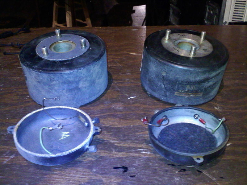

Driver ID
Well, I posted this on the Altec hostboard and am still not sure. The driver on the right is the 288c. It has a gold color where the bolts stick out. It also has a diaphragm cap with a rubber gasket and felt backing. The driver on the left is unidentified. I think it is an older 288c. It has a gray color where the bolts stick out and the diaphragm cap has a rope gasket and no felt. Any ideas?
Sorry about the picture. I took it with my phone.
Tom
