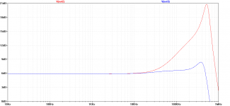

I was able to bring the peak down considerably by using 4n7 instead of 1n in the input LPF. This brings down the gain at 20kHz by about 1dB too though, but the amp remains stable. I have yet to re-check the THD values.
The graph shows a rough approximation of the frequency responses with 1n (red) and 4n7 (blue) input filter cap, which I arrived at by tweaking the LTspice opamp model to resemble the measured peak.

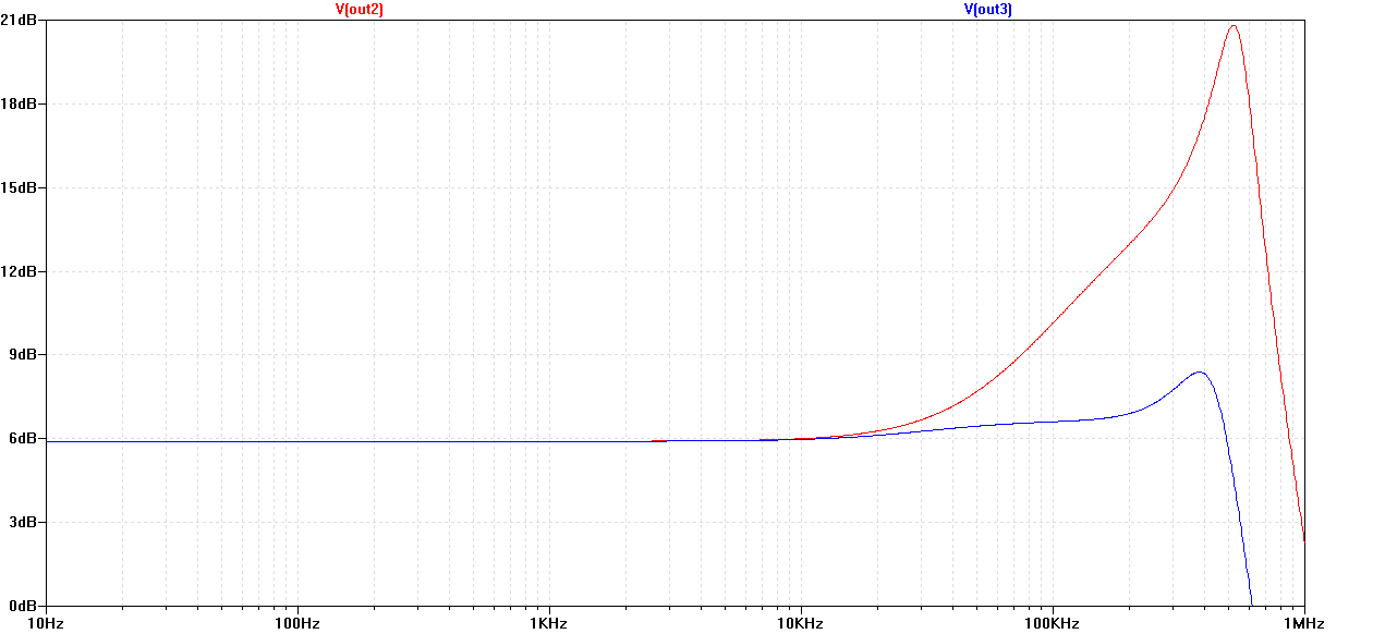

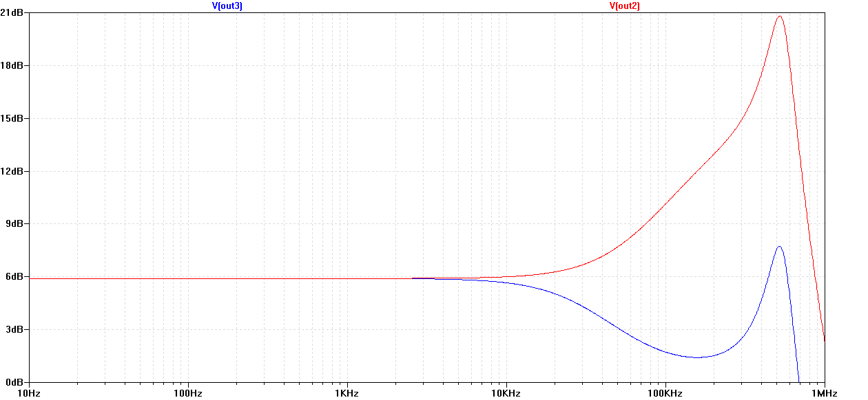

Adding another 4n7 in parallel with the 4n7 which is already there in series with the 47R on the inverting input makes the frequency response look a lot nicer. The peak is only slight now and moved a little down to around 330kHz. The tweaked model is not exactly spot-on here.
I'll see if I can find enough capacitors in the parts bin and then add them to the stereo version for a comparative THD measurement.

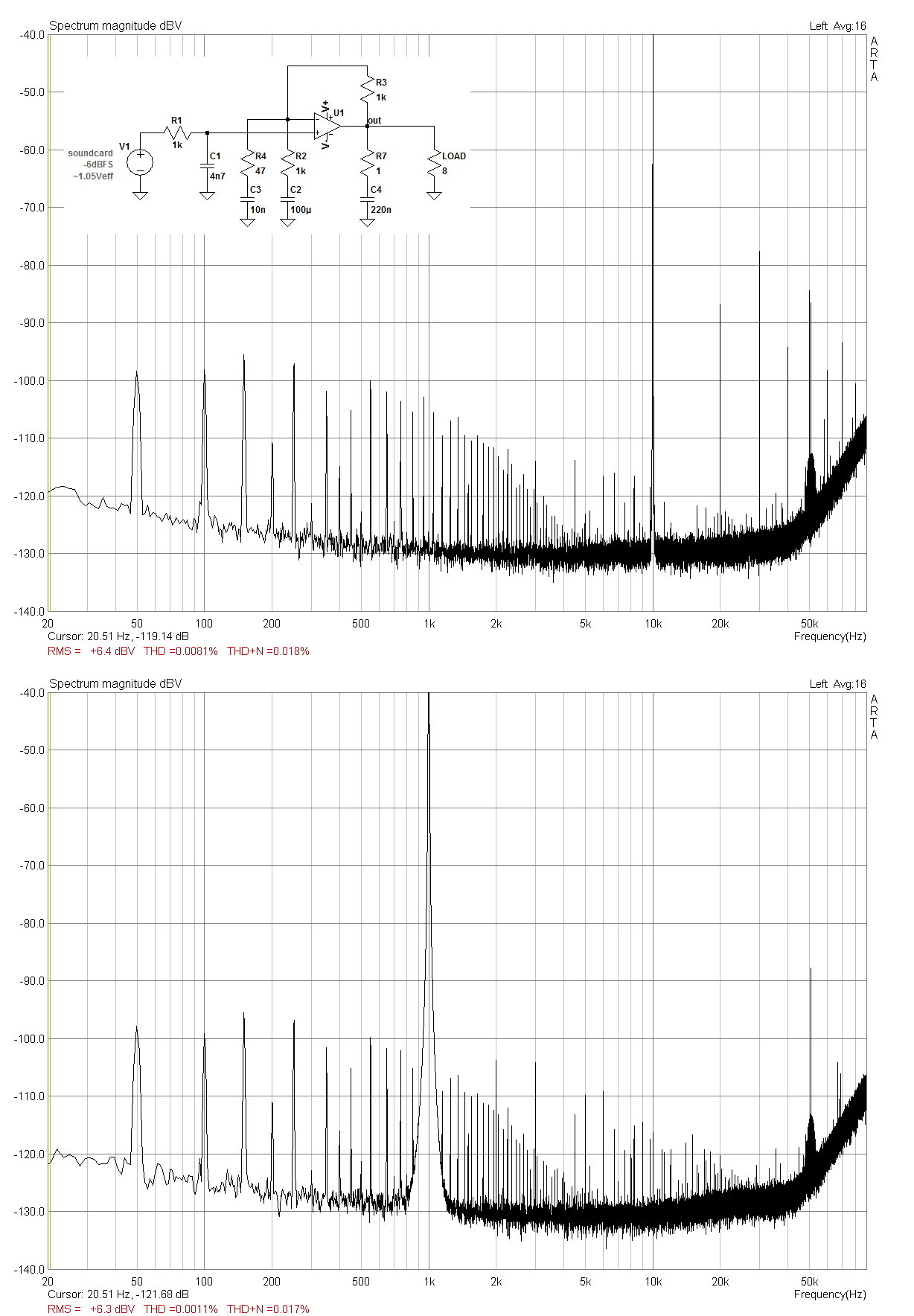

THD at 1kHz skyrocketed to over 0.4% 🙁.
That's fishy: the 1kHz THD should only be very marginally impacted, and the variation should be gradual.
Shifting from 0.00x % to 0.4% with just a small change means you are measuring something else or wrong. Double-check your connections, solders, etc, listen to the result, extract the THD residue and you will find something abnormal.
Revert to the initial situation and remeasure the THD: you might find it has also become 0.4%

Fixed the blown TDA and measured THD with the new modifications running on the lab supply. The measured values are about as good as before, with 0.004% at 1kHz and 0.022% at 10kHz (the 10kHz values were a '0' better with the unregulated supply).
The only obvious difference is that I used two 4n7 WIMA foils in parallel on the now running amp, and 10n ceramics in the defunct amps. I doubt that that's what's causing the fault though.
High K ceramics like Z5U Y7R are highly nonlinear, and in the right conditions can generate a huge amount of distortion.
To be used for bypass/coupling only. Otherwise, use film caps, group I ceramics (COG, etc.), mica, etc.
Capacitor distortion it is 😱. Now I feel stupid 🙁.
According to SPICE the cap only sees the full input voltage, which was 1V RMS in this case. Never had I thought that that would be enough to cause such a dramatic increase in distortion!
Takeaway message #2: Be careful with any ceramics in the signal path, as long as they are not C0G/NP0 (probably...).
(Takeaway message #1: Be careful with any wirewound resistors in the signal path)

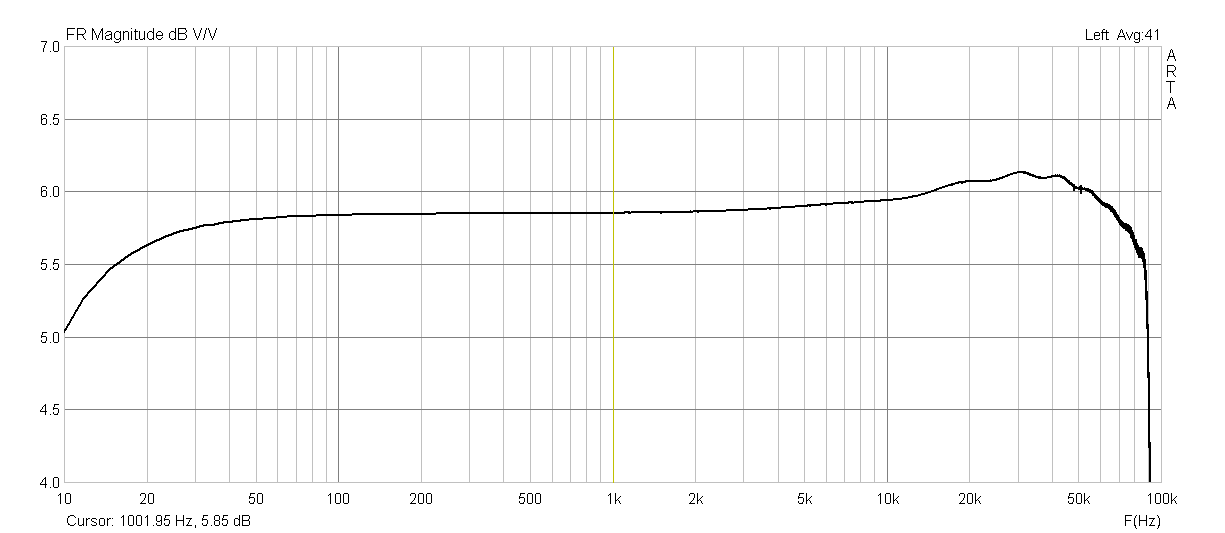

Now everything looks nice. Frequency response is reasonably flat and starts to slope downwards around 30kHz - no nasty ultrasonic boost anymore. THD is 0.0011% for 1kHz and 0.0081% for 10kHz now (measured at 192kS), which is quite a bit better than the datasheet circuit. With 44,1kS sample rate the 1kHz THD even shows as an impeccable 0.00049% 😎.
Thank you again Elvee for pointing me towards the fish! I would have probably tossed the whole thing without giving it another chance.... 🙄
