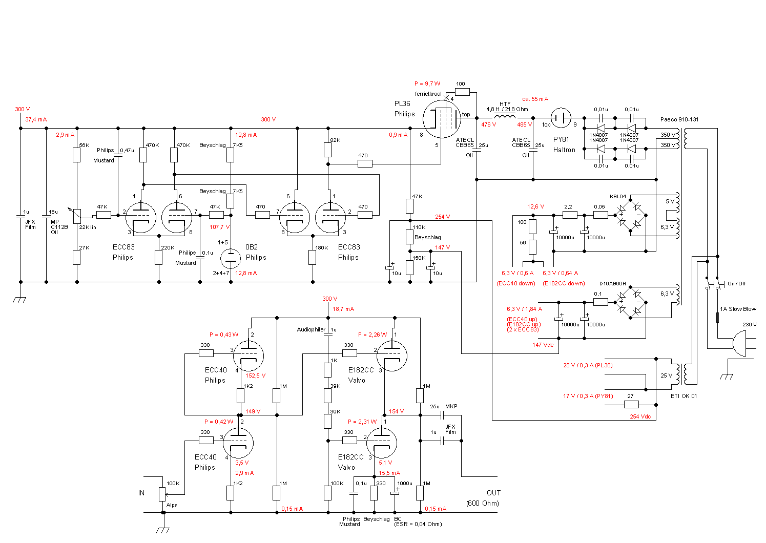

I used one of the schematics (with some changes, like a VR tube instead of a Zener, and a PY81 for delay) described in the attached article (AudioXpress 2008) in my Aikido headphone amplifier.
  • Valve (Tube) Regulated Power Supplies (AudioXpress 2008).pdf

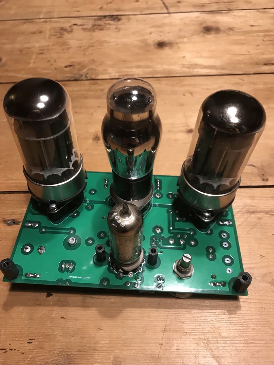

I did a board design once for 2x 6080/6AS7 EF184 CCS loaded, and it works quite well. Not as well as the cascode loaded error amplifier versions.
