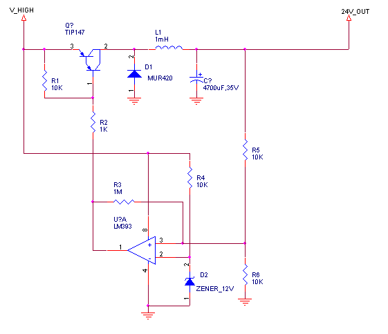

When I was young, I built a lot of idiotic things, one of them - relay-type buck regilator 30V to 24V 5A, The main idea - a comparator with small hysteresis, when output voltage drops a little - it opens the switch, when grows to much - closes it. It even worked 🙂 ... (see picture) . You can adjust Vout vith R5, and output ripple with R3, of course You can't us LM393 when Vin more than 30V, just build another "full-discrete" comparator...
About boost - I don't think that it's a good idea, and transformer will not cheaper - it will lower voltage, but higher current, so it will have the same power, and tr-rs with same power cost the same...
