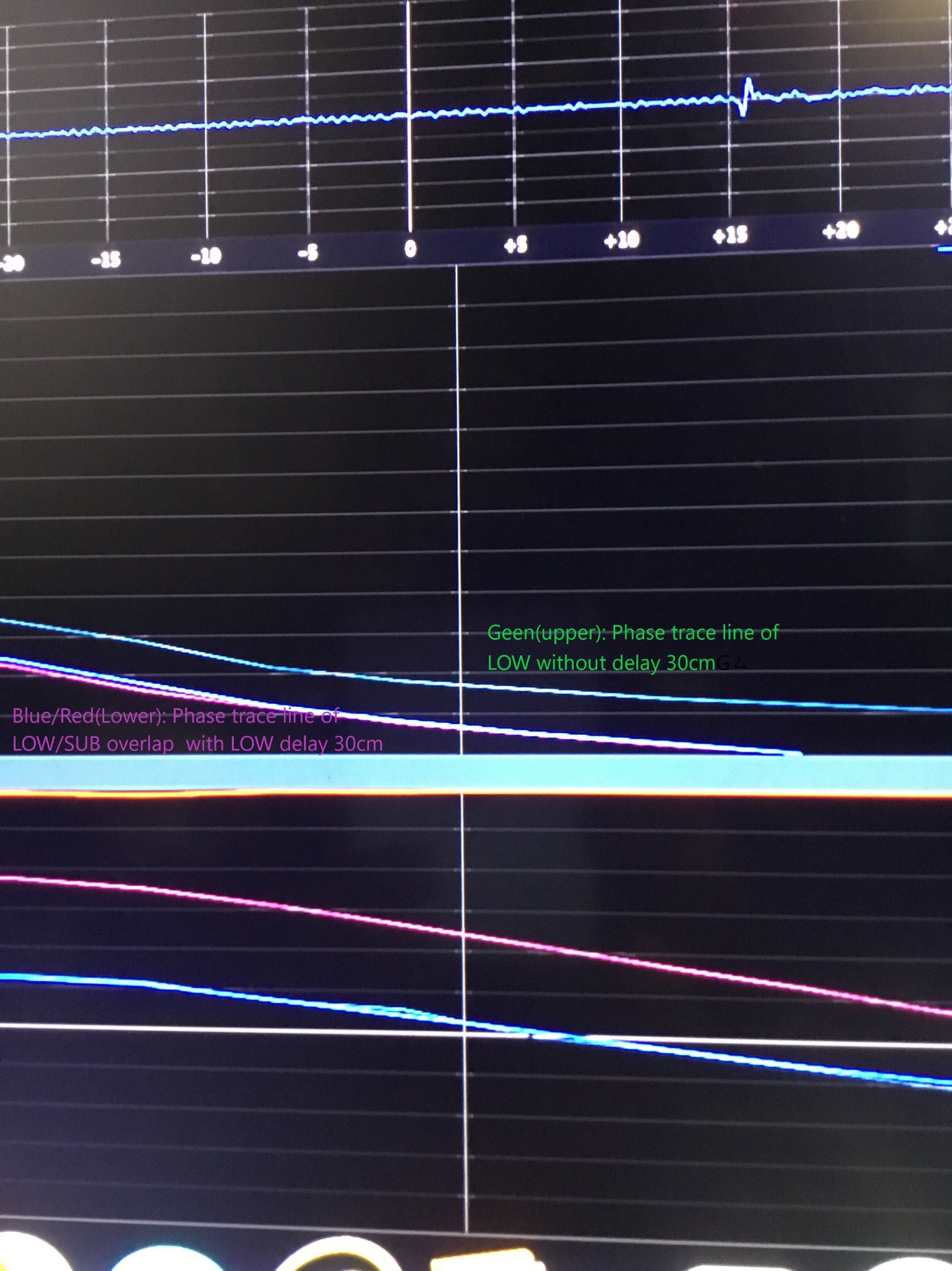

What was the gate setting? It would be easier for me to interpret if you showed 5dB scales, and possibly used some smoothing. Might need a shorter gate. I can't tell.Thanks Temp25: I try 2-5ms gate
Would you want to improve on this? I guess what I should ask, is do you want to experiment further?

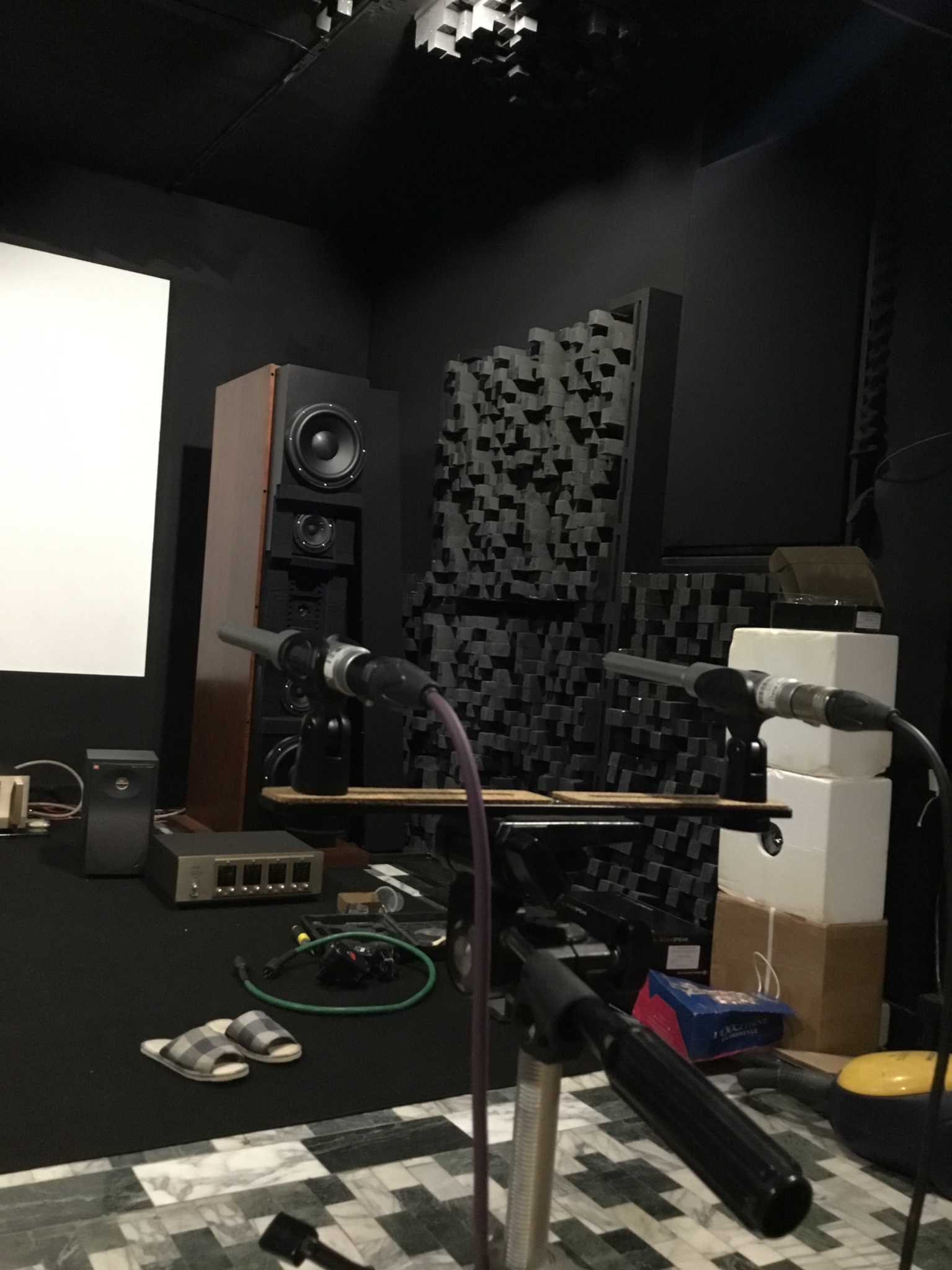

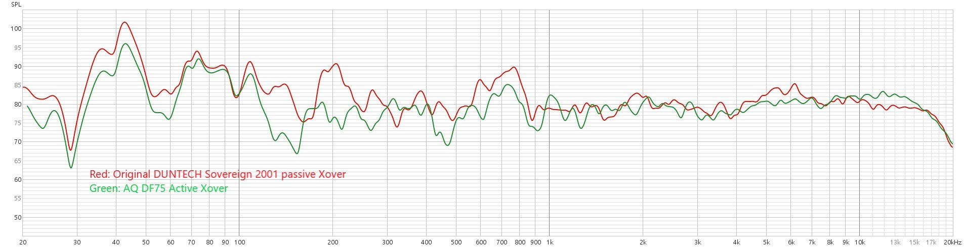

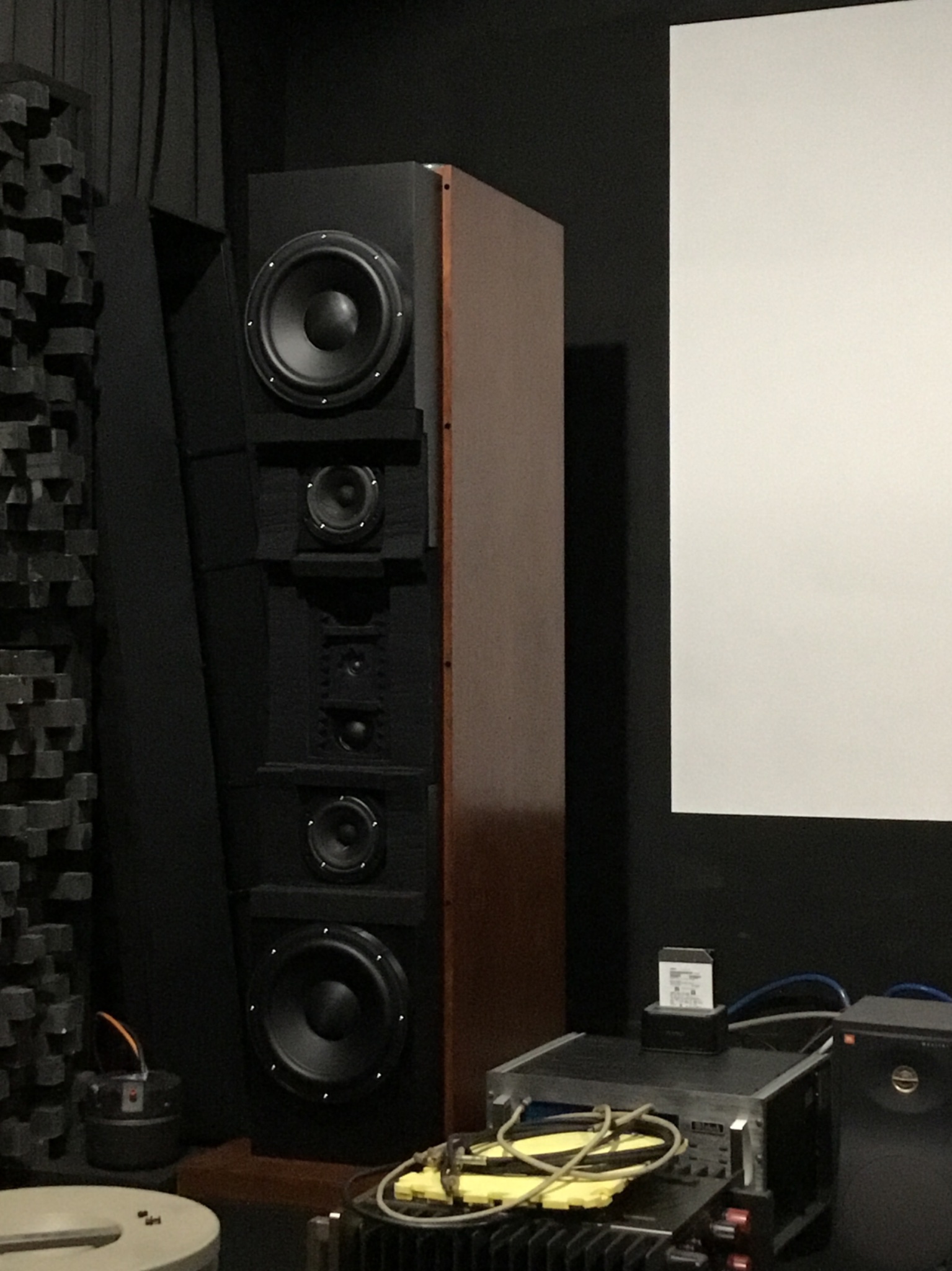

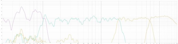

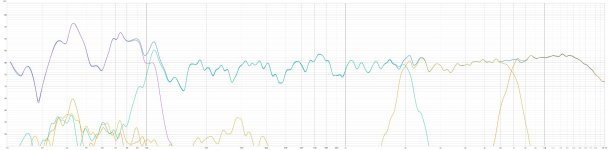

A couple of thoughts.

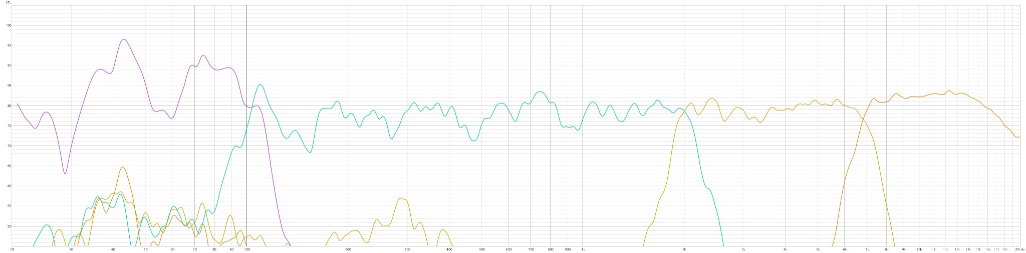

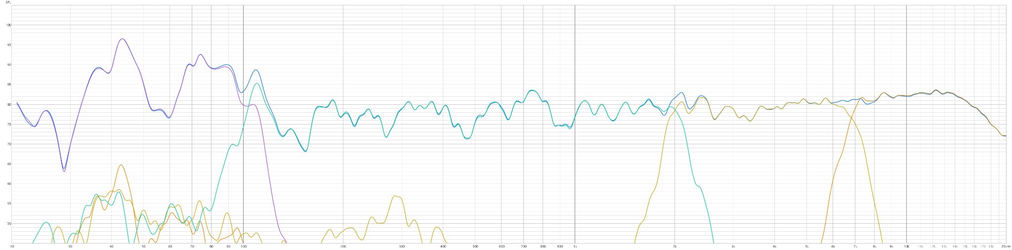

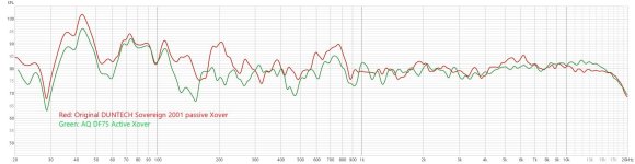

The mids could probably be crossed lower than 2k. What was the original 6dB x-over point?
The woofer spec sheet shows a rise at 2k. Since you don't have EQ, maybe you can spread the filter frequencies. In other words, low-pass the woofer at something like 1.8k, while leaving the mids at 2k. Maybe you are already doing this, but your measurement looks like there is more overlap at 2k than ideal.
Actually, I wonder if you can cross even lower. Maybe 1.2k is reasonable. Some power handling may be compromised, but I suspect that the mids might sound better at 1.5k than the woofers.
Do you play the system loud with music, or action movies?

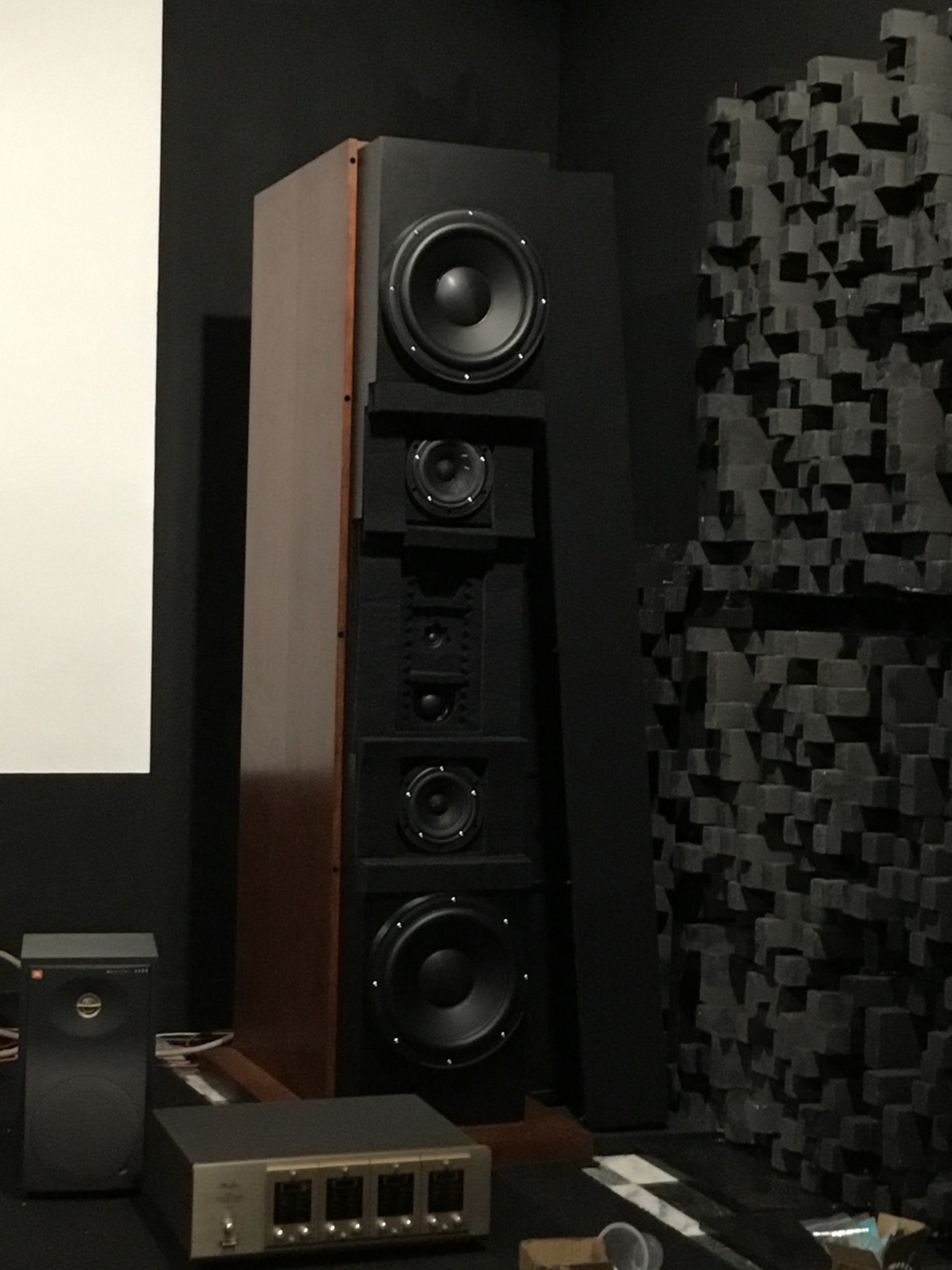

I can remember reading in Audio magazine when this speaker was first sold. The midrange drivers would have been fine crossing over at 100HZ. Guessing a passive crossover was easier to pull off at 290HZ instead. Bi-amping was not done near as much back then.
The original 17W75 mids were designed to work with a first order crossover at about 2K. They would drop off fairly fast above 2K and not show any breakup peaks in the 2-4K range.
