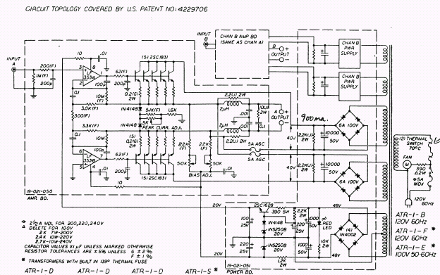

"Here's a schematic of a Sumo Amp. May be of some help."
That is a Circlotron, not applicble here.
It is worthwhile to note that the gains of each half are different.
djk said:"Here's a schematic of a Sumo Amp. May be of some help."
How is that the gain is different ? They seem the same to me.
mcp said:Mike

I don't know what a Circlotron is but it says quite clearly that it is a Dual Differential 70Watts Class A Sumo. Possibly by James Bongiorno, has is thumbprint on it. As for whether it is applicable, examine the concept closely.That is a Circlotron, not applicble here.
By the way, the gains are not unequal. they are both at 11x because one is positive driven while the other is negative.
Yes it is indeed a Bongiorno design...see..
