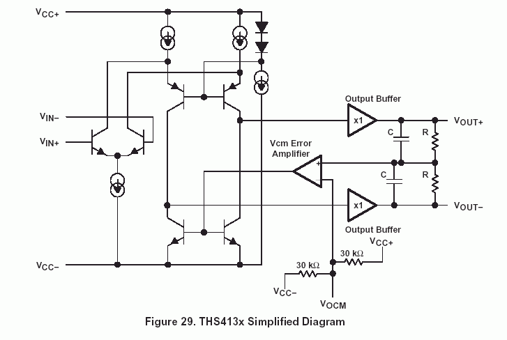

Sorry, I am not quite get it. Is it folded cascode like this AD opamp offended the Master's SuSy patent? What are the other resemblence besides both using folded cascode? I tought the SuSy patent stressed on distortion canceling with 180deg output stages, not folded cascode.
Since being granted the SuSy patent, we have seen a SuSy
precedent in Hadley. Although Hadley did not describe his
circuit in this way, in my view this restricts the claims of the
patent more narrowly, and the most unique example uses
folded-cascoding. 😎

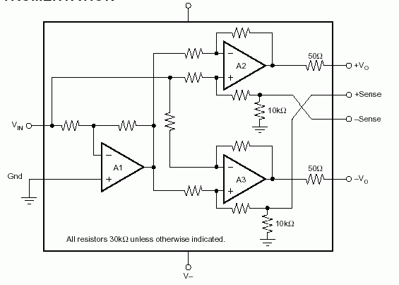

npvfb.gif possible formula
Thanh how about this.
The general case is four equations, four unknowns.
I got it down to two equations, two unknowns and
then simplified them to the given special case.
The general case is a real mess to solve.
I checked it on paper for some cases and ran it on
spice and it seemed to be ok.
The equation can be played with to look better perhaps.
The SuSy equations are easier than this one.
Hopefully I'm right.
Hope it helps.
Tom

Thanks Tom2!
Can it operate stablely?
One pin of R2 (R4) often is wired to ground .In fully ... ,it is connected to Out

Thanh,
I went back over deriving the formula and it appears correct.
Stability, I do not know.
I ran it on spice with the opamps modeled as a difference
junction connected to a gain block.
You could connect R2(R4) to ground then you would have the standard two opamp front end of a instrumentation amp. Although R1 and R2 (R3,R4) act as a voltage divider attenuating the input signal.
In fact let R2(R4) be open circuits(R2=R4=infinity) then the equation becomes the gain equation of the standard two opamp, three resistor topology. Math is so cool.
I have experimented around with some two opamp circuits.
Circuits like the SuSy are very pathological(unstable), others circuits can be stable or unstable depending on the voltage gains chosen.
Also input offset voltages and input bias currents can cause large dc offsets and even latch-up at the outputs due to all the loop gain.
Ultimately, you really need to build the circuit and play around with it.
