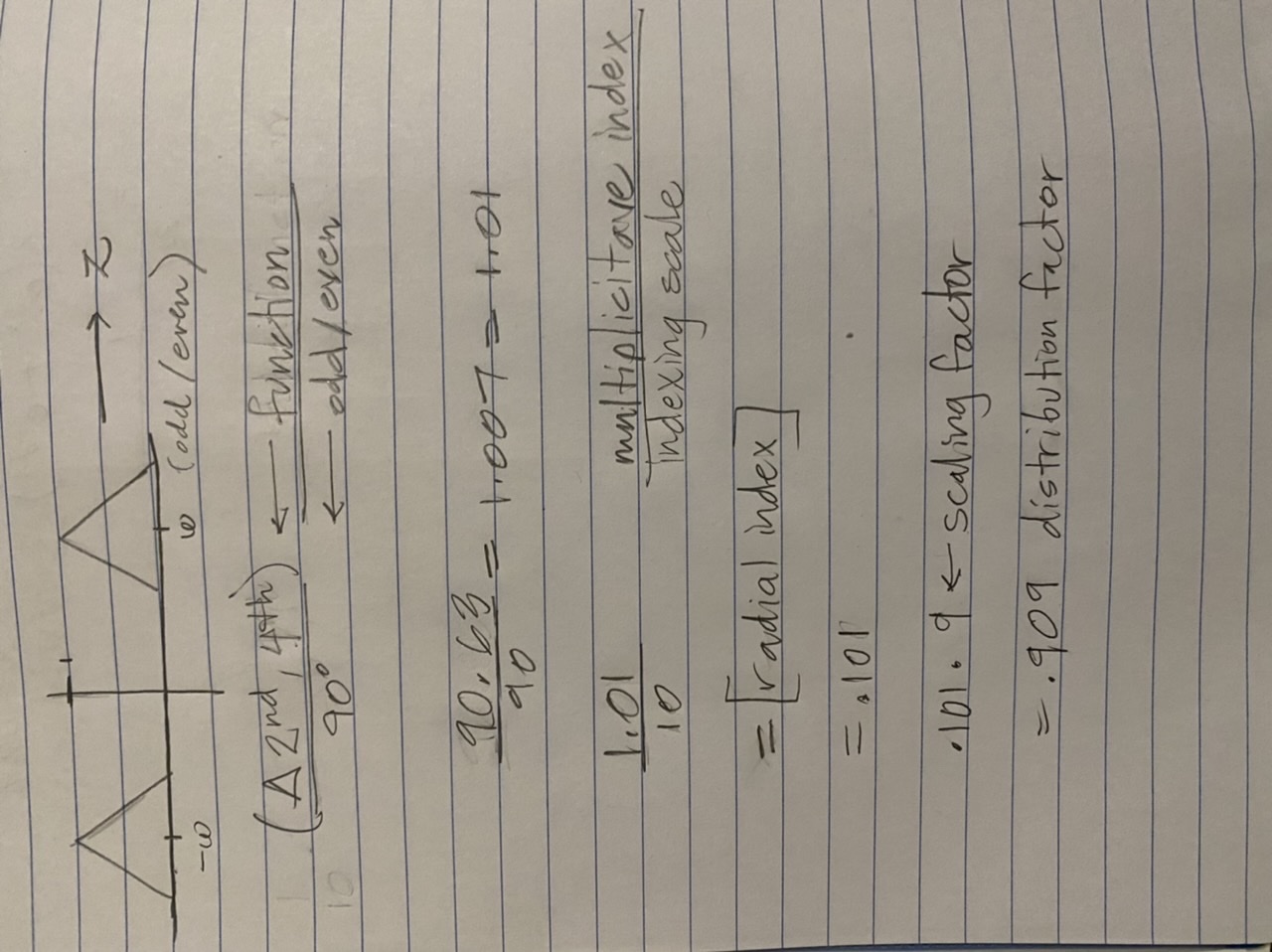

the system couldn't resolve at 1k
run at 4k and 64k
anyone is square law up for a diff eq to approximate 1k thd
(f^n)*(n^n)
[(f^2)*(2^2)=f1, f=1k, n=2;] //(2VRMS 😕)
[(f^2)*(2^2)=f4, f=4k, n=2;]
[(f^2)*(2^2)=f64, f=64k, n=2;]
my coding is in need of a c++ update for sure
