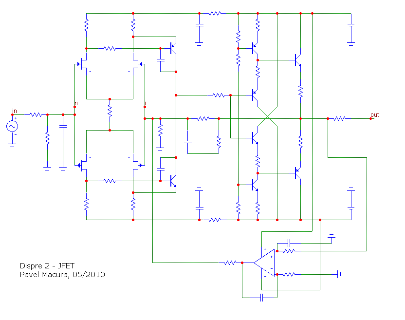

The "VUELO" schematic calls it a Fully Differential Hybrid Amplifier but doesn't mention headphones at all. Maybe the title of this Forum discussion is incorrect?

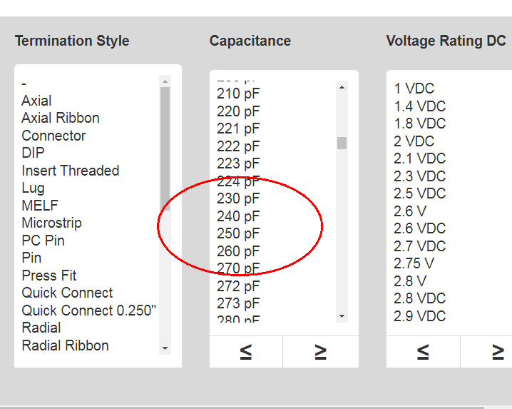

I checked mouser.com to see whether C2 and C4 (245 pF) were in stock. Unhappy news: Mouser doesn't even have a part number for those capacitors. You'll have to buy them elsewhere (attachment below).
What's the advantage of connecting resistors R23 and R24 (each are 741Kohms) in parallel as shown here? Why not simply use one 370K resistor instead? With 15 volt supplies those resistors can't possibly dissipate more than 2 milliwatts; cutting the power dissipation in half by installing two parallel resistors seems unnecessary ... ?

Please specify, why at +-15 supplies not to use THS4131 buffered at your choise.

But yours Vuelo have 1k input impedance, and resistor tolerance aren't specified, so probably you need at least good-CMRR input based on something like LT5400 or put any instrumentation opamp as good-CMRR input.ideal op amp infinite input resistance
Next you need to have a volume reg.
And last will be your Vueno in single-ended input config.
