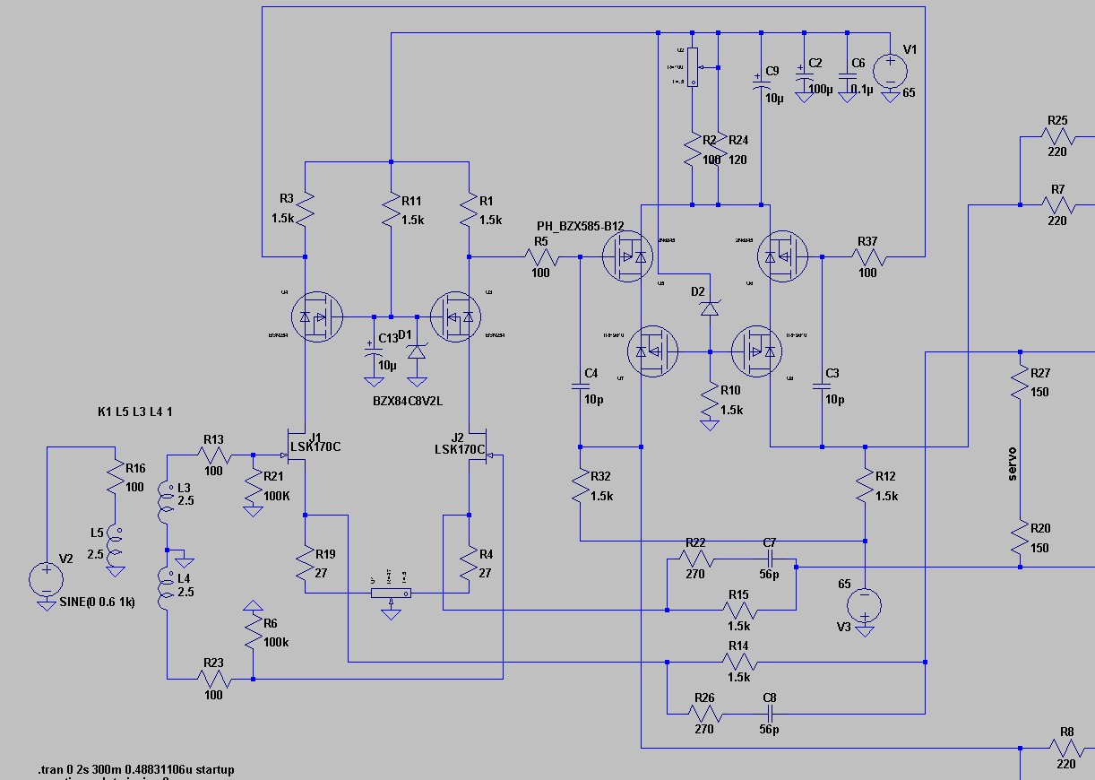

This is a old thread but maybe someone can give tips to get low distortion on this circlotron differential vas. I see it is not quite low, but on output it is -80dB.
So I do not understand it completely, maybe unbalance because of current feedback on the Jfets, I maybe need local feedback on the VAS, how?

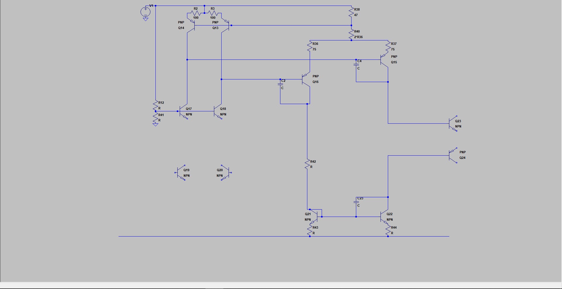

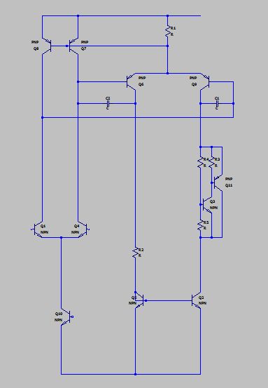

Great minds? Been thinking about this too. See image of a way that the bias current of the VAS is independent of the input diff.
Also, when the VAS is dual sided, the signal current peak is Ivas*2 instead Ivas/2, so you could save on VAS heat and maybe 2EF OPS instead of 3EF.
Others cascode the vas current mirror, but I used a resistor so that signal voltage on it allows a compensation pole of that signal path.

Oke, I have a circlotron so I need two opposite fases, you dit post a vas for complementary output inclusive a Vbe multiplier.
But I can do use two? with a nulling ground, voltage feedback is then also possible but I do not like, I use most current feedback it prevents all kind of feedback related distortions but is dc offset unstable, for a circlotron it cancels out so here it does work fine.
Q6 and Q9 has a Cdom cap, these do put also negative feedback, special for HF.
I have use the cascode because of miller capacitances, I use a allfet amp, special here it is of benefit, yes I need higher supply voltages, but not that muchbecause of the circlotron itselfs do x2 output.
I do see much distortion on the allfet when drive hard, with low 10 watt signals it get much better, swap the circlotron itselfs from source foller to drain follower did lower distortion also, now because the circlotron itselfs do amplify making open lo0p bigger.
Most long tail pairs and voltage to current amps like the input transconductance amp can introduce distortions, there is so much readings about it, just find the right one like I have to do.
Yes that one ive beeen playing with and have ended up using beeng well satisfied. Thou emitter resistors in all vas transistors and a pot on Q7 Q8 emitters ease the job.
Vas stability is also improoven when using base colector load to Q2 in your principle drawing.
Remember recovery and catch diodes help when overdriven.
