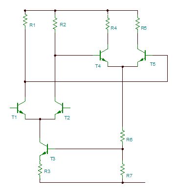

I was looking over a project inspired by one of Anthony Holton's designs (aussieamplifiers.com), and I had a question about the input differential stage and the VAS stage that follows.
Mr. Holton's topology has a truly differential input stage (with tail supply), followed by another truly differential VAS stage (another differential pair with another tail supply). I would think that this would improve CMRR because of the two differential pairs.
==> Does this topology have other advantages, as compared to
Fully differential input followed by a pseudo differential VAS (which would be two single ended VAS stages following the differential input stage)
Conventional Fully differential input stage, output taken single-ended into a regular VAS stage
I was just curious...
One advantage would be that the diff input into diff VAS topology has strictly defined stage currents at all times, their maximum being the tail current of each stage. If dimensioned correctly and perhaps augumented with some diodes, it is quite easy to insure no part of the amp goes into heavy saturation when overdriven, which will give you very good clipping performance.
On the oposite end of the scle you have a single ended VAS, which in it's simplest incarnation has no limit on the VAS transistor current save for beta * tail current of the input differential. This is often a rather high current, and often completely overlooked, to the point where there are amps that will smoke their VAS transistor when the output protection engages. Whereas the differential VAS swings equal current both ways, a single edned VAS rarely does unless measures are taken to limit the VAS transistor current - which in turn implies some sort of emitter resistor for it, and consequently degeneration, which we don't necesairly want.
Pseudo-differential VAS stages would not work well without some means of local feedback or modification to the VAS stages as one would normally view them. This is because with no defined tail current as in the differential VAS, the two oposing VAS stages have no DC current defined, not even with feedback. So, again, we either have to add emitter degeneration in order to define DC operating points, or there has to be another means of setting it (usually they are all forms of feedback). The disadvantage is that you have lost another stage capable of differential amplification, which is what you really want.

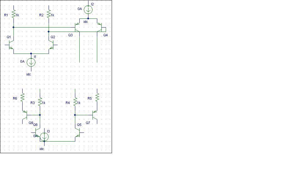

==> As this terminology is not very clear, could you provide some schematics to help the discussion ?

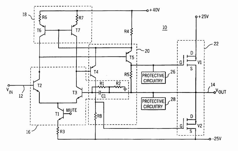

Certainly! See attached...
The top circuit is what I'm referring to as a fully differential input stage followed by a fully differential VAS stage, while the bottom circuit is what I'm calling a "pseudo differential" VAS stage, because the two VAS transistors (Q9 and Q7) do not share a common tail supply current source.

Yes! This is the main point of what I'm trying to experiment with in my simulation - a method of common mode feedback so that the DC bias points of all points in the circuit are well defined. I can find many references on CMFB for IC opamp designs (opamps that are powered by less than 5V), but I can't find anything on CMFB methods for high voltage, high power fully differential amplifiers (such as an FD audio amplifier). May I ask, how did you implement your CMFB?
Ultimately, I would like to successfully simulate this kind of circuit (FD means fully differential for my shorthand notation):
An FD input stage with a current mirror tail source (for high CMRR) and an active load for each leg of the diff pair (this active load would also be made with a current mirror)
This would be followed by an FD VAS stage that also has a tail current source and an active load for each VAS transistor. To date, as I simulate the circuits in TopSpice with my methods of CMFB, my DC bias points are terrible....

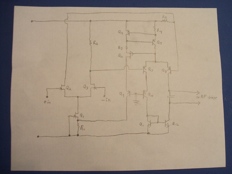

Certainly
Here is a simplified drawing of what I’ve done. By simplified I mean my circuit uses cascode input stage and VAS, along with a more complex mirror for Q’s 11 & 12. I prefer J-fet inputs but I guess BJT would work also. I’m using very low current J-fets in an attempt to increase or eliminate R2 and R5. This means the input stage will be biased with just the base currents of the next stage, something around 10uA. In the last proto, the input stage bias is around 25uA.
You might be able to use a 2 transistor BJT CCS for Q1, but self bias J-fet here is simpler.🙂 R3 is chosen based upon the Pch J-fet’s Vgs @ Id for the correct current through R1. I used http://www.fairchildsemi.com/ds/MM/MMBF5460.pdf for Q6, but I suppose it doesn’t matter. Since a J-fet has no gate current, the gate can be used to sense the voltage on the CCS, Q4 & Q5 without affecting the CCS. When too much current tries to bias Q7, Q8 too heavily, the J-fet increases in conductance increasing voltage on R1 so current in Q1, and Q2/Q3 are reduced and bias less to Q7 & Q8, CMFB.🙂 The cascode Q9 is because most small J-fets don’t like lots of volts. VAS bias is set by 0.6V/R4. The active bias makes the circuit temperature independent because we all know that when electrons flow through a transistor it creates heat and the temperature rise increases gain and reduces Vbe, and affects bias. I’m sure there are other ways to implement some type of CMFB, but this seems to work for me. Simulation results might be interesting, I haven’t a good simulator so I just made a real circuit.😀
PS: I remembered that I made a thread about it a while ago. Not much discussion on CMFB though. The compensation isn't quite correct here but is too much hassle to change since there is a new circuit in the works, with some minor circuit changes, but more towards transistor arrays instead of completly descrete. Less component packages and better transistor matching with an actual PCB instead of veroboard.😀 That POS still works and sounds great though, believe it or not.:xeye
http://www.diyaudio.com/forums/showthread.php?threadid=90847&highlight=
Hi
One good thing about this circuit is DC offset is low, at least in the circuit I built. It depends on how well you match the devices, but IMO not needing a DC offset pot is beneficial. The proto-topology check circuit has about 15 mVDC with an Av of 65. In the new PCB(still only in existence on my computer🙄 ) there is a place for the R2 & R5, but I would like to not use them and bias just base current through the input LTP legs. I left options like this in the PCB so as different compensation techniques can be experimented with. The circuit in the link uses both Miller compensation and Miller feedback. Would like to try a 2 pole scheme. I am still doing some final clean-up work on the PCB though. I always hate the anxiety when ordering boards.:apathic:

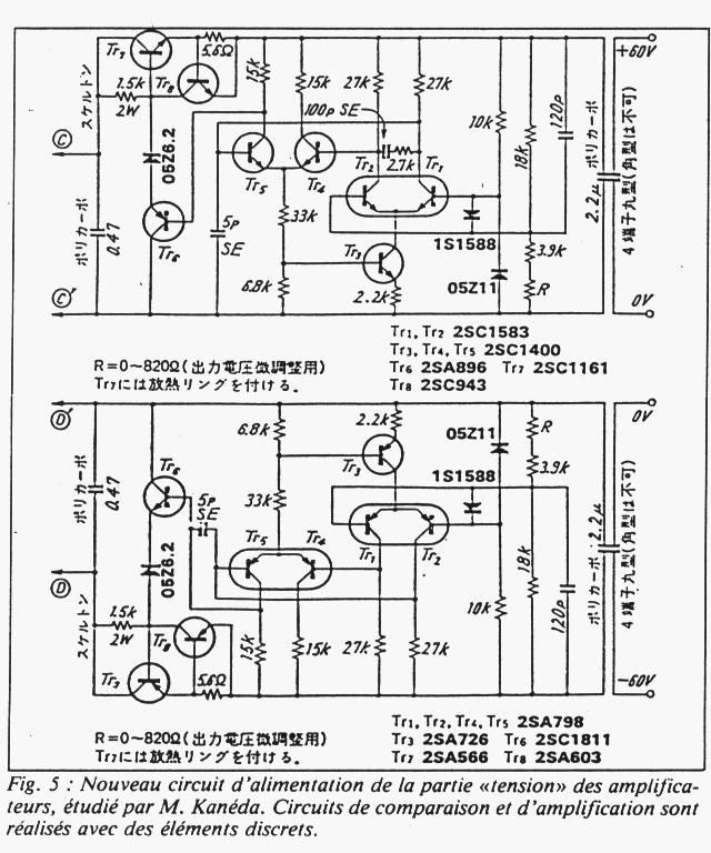

Here are the circuits of the Kaneda power preamplifier and amplifier power supplies. A rare example of CMFB in high end audio, an't they ?
Preamplifier power supply

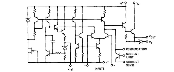

I wonder if that circuit in post 12 could be re-built to be better than say a 723 or similar regulator IC, maybe using some J-fets? It would be easier to create positive and negative regulators this way. For comparison, the simplified schem of a 723...
Hi CBS240,
I am very familiar with the 723 which was wonderfully conceived some 40 years ago, I recently built a new lab power supply with it.
I think the Kaneda circuits are faster. Note that the voltage gain stage is entirely powered from the regulated side, in a somewhat incestuous manner, Ian Hickman should have said. I have no data at all on its performances. I would like to try a rather similar circuit in an amplifier.

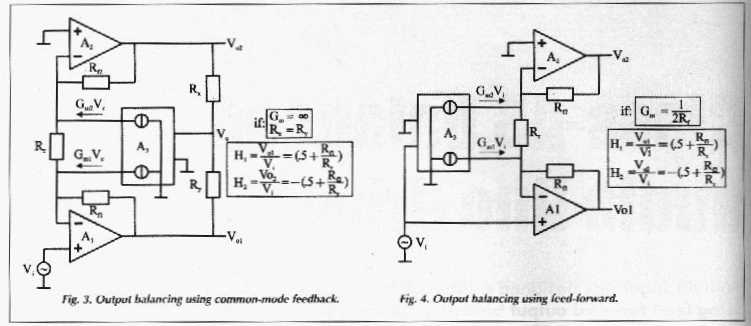

I then dig out an article written by Win de Jager from my Electronics World collection. It presents a parent concept of CMFB, even less known, the Common Mode FeedForward. I am all in favour of feedback but analysing this circuit could inspire some new ideas.
First, the general concepts of CMFB and CMFF
