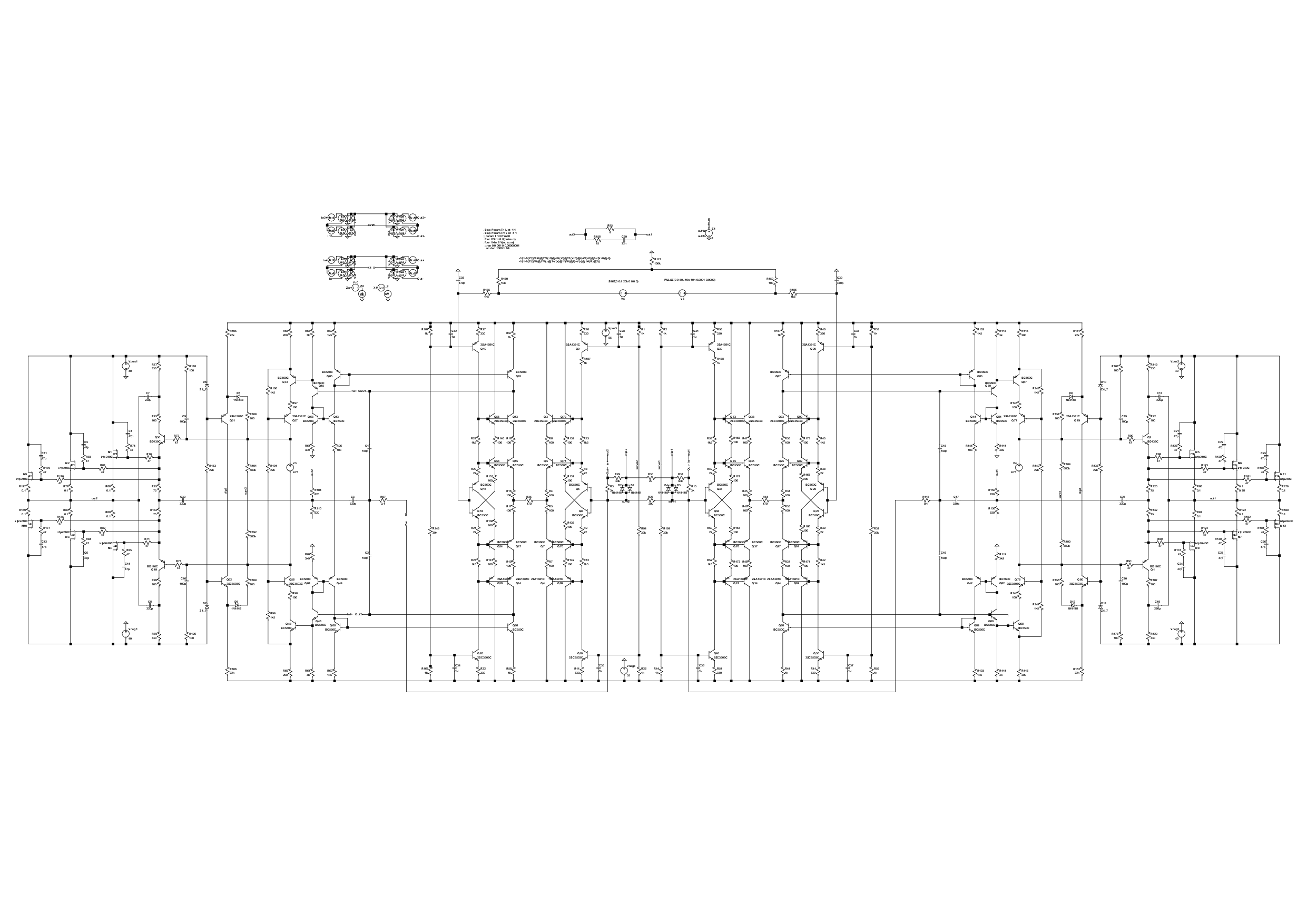

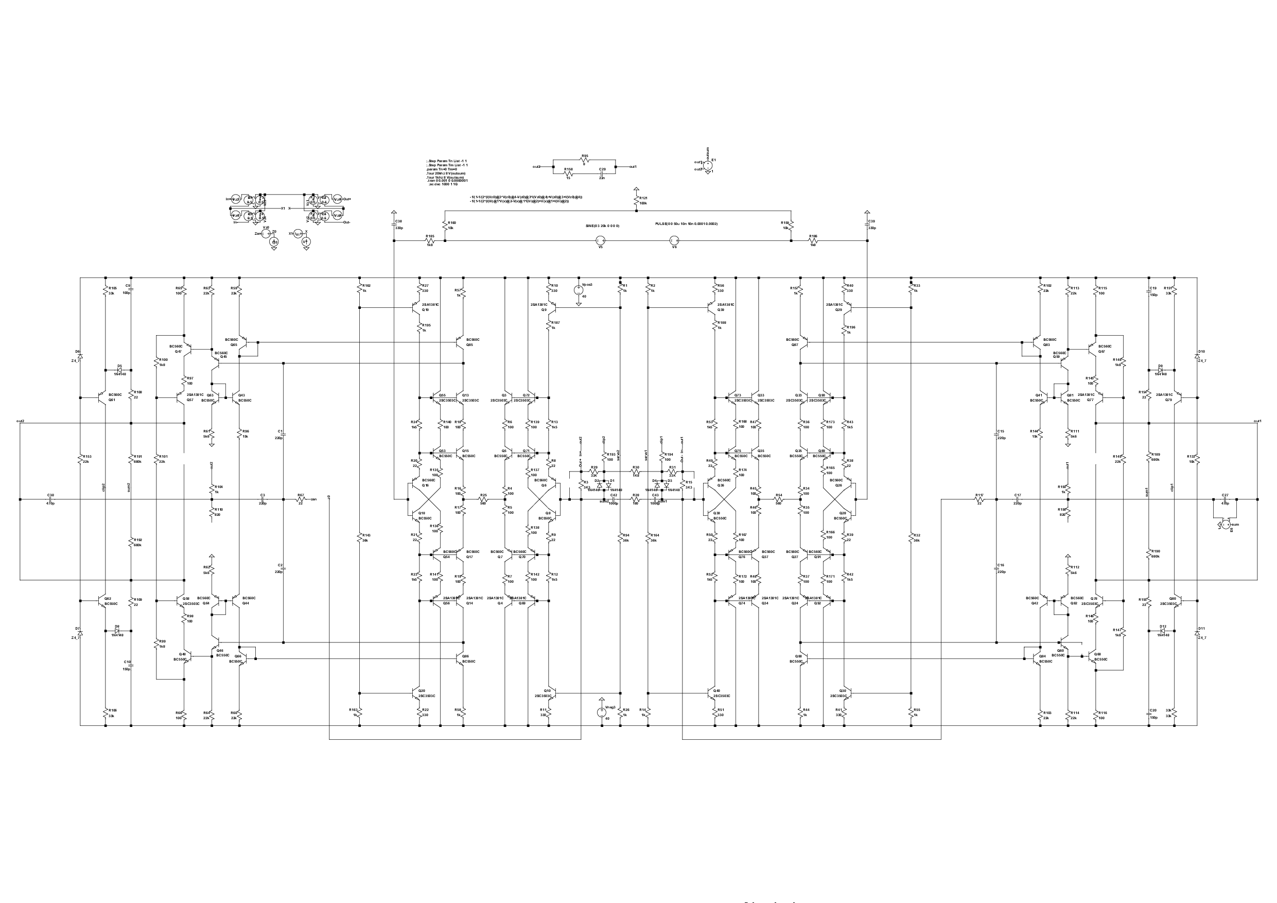

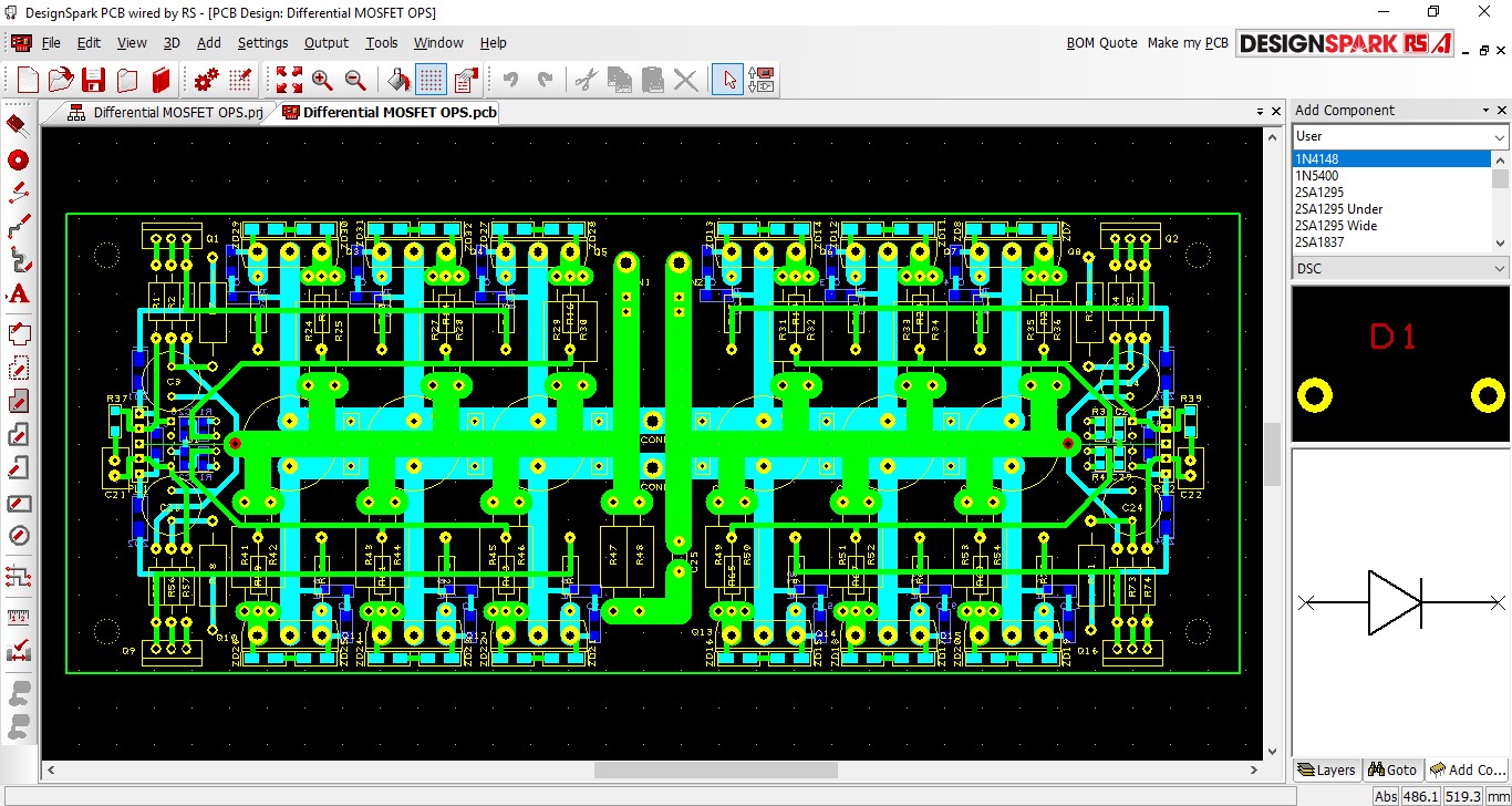

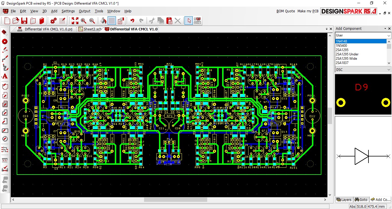

Have processed the information and acted on some of it. Although have been quiet been busy in the background. Have laid out two PCBs. One IPS and one OPS. They have been sent off to a Chinese PCB house just in time to get them made before the Chinese new year. :)

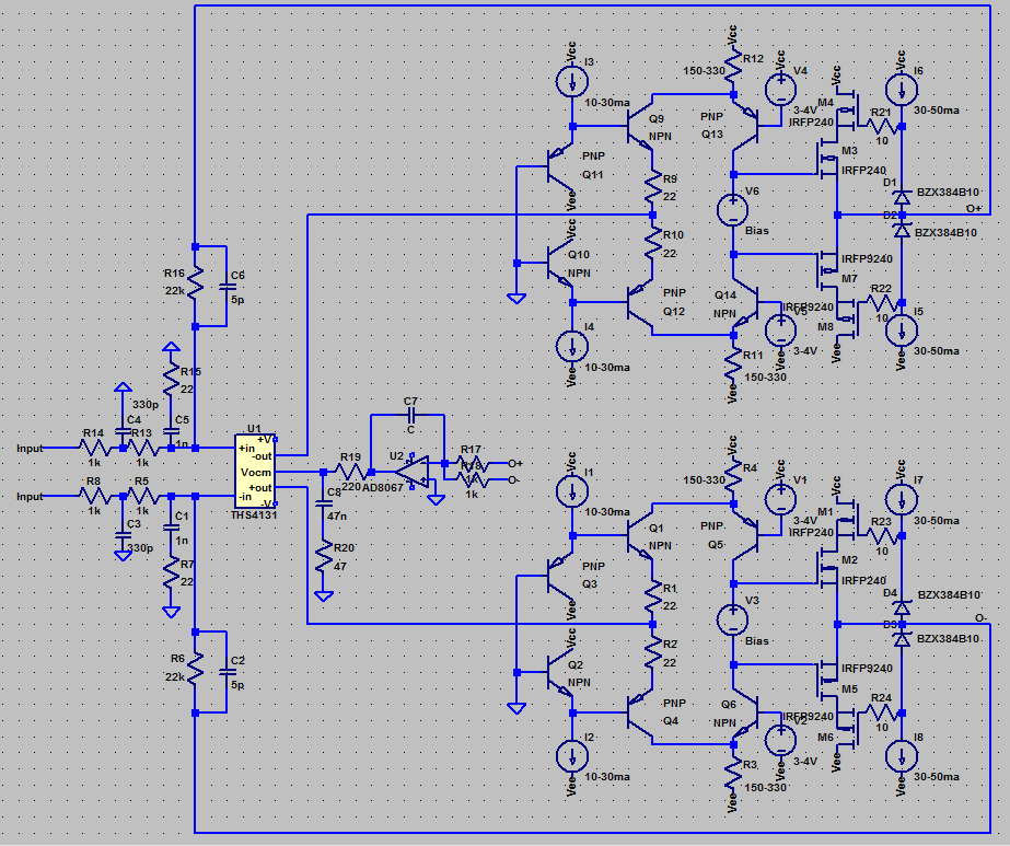

The basic design is as per attachment except the OPS PCB has been laid out for the LT1166. This is not a final decision but at least allows some basic evaluation. Have not decided what biasing method will be used in the final version. Could be a Vgs multiplier with a Vbe multiplier.
The big IXYS MOSFETs look interesting. Paralleling two pairs of those with independent temp compensation may be looked at. Just wondering how to drive them. Push pull drivers?
As per previous discussion I have been using BesPav's method but now have moved to David Zan's method. There is a discrepancy between the two. BesPav's gives a more "conservative" if less accurate result.
I would like to be able to simulate two differential loops at the same time but my understanding is not great enough to get it to work. It complains about floating nodes....?
Would like to optimise the loops in preparation for the first prototype build. Probably some non obvious issues hidden in the design.

That is quite close to what I was talking about, but again I have to say that reading a low resolution jpeg is quite meaningless.
Comments to the H bridge IPS.
There is no need to cascode the cascode.
You can also remove (most, maybe all) of the resistors in the collectors in the H-bridge.
All the best
Reodor

Hi, Dave!
Let me suppose, that we could remove significant capacitance by cascoding OPS devices.
So, we can use cheap as dirt IRFP140/240's or transconductance-matched FQA36P15/FQA28N15 pair.
And, of course, try simpler drive stage.

Hi mlloyd1,

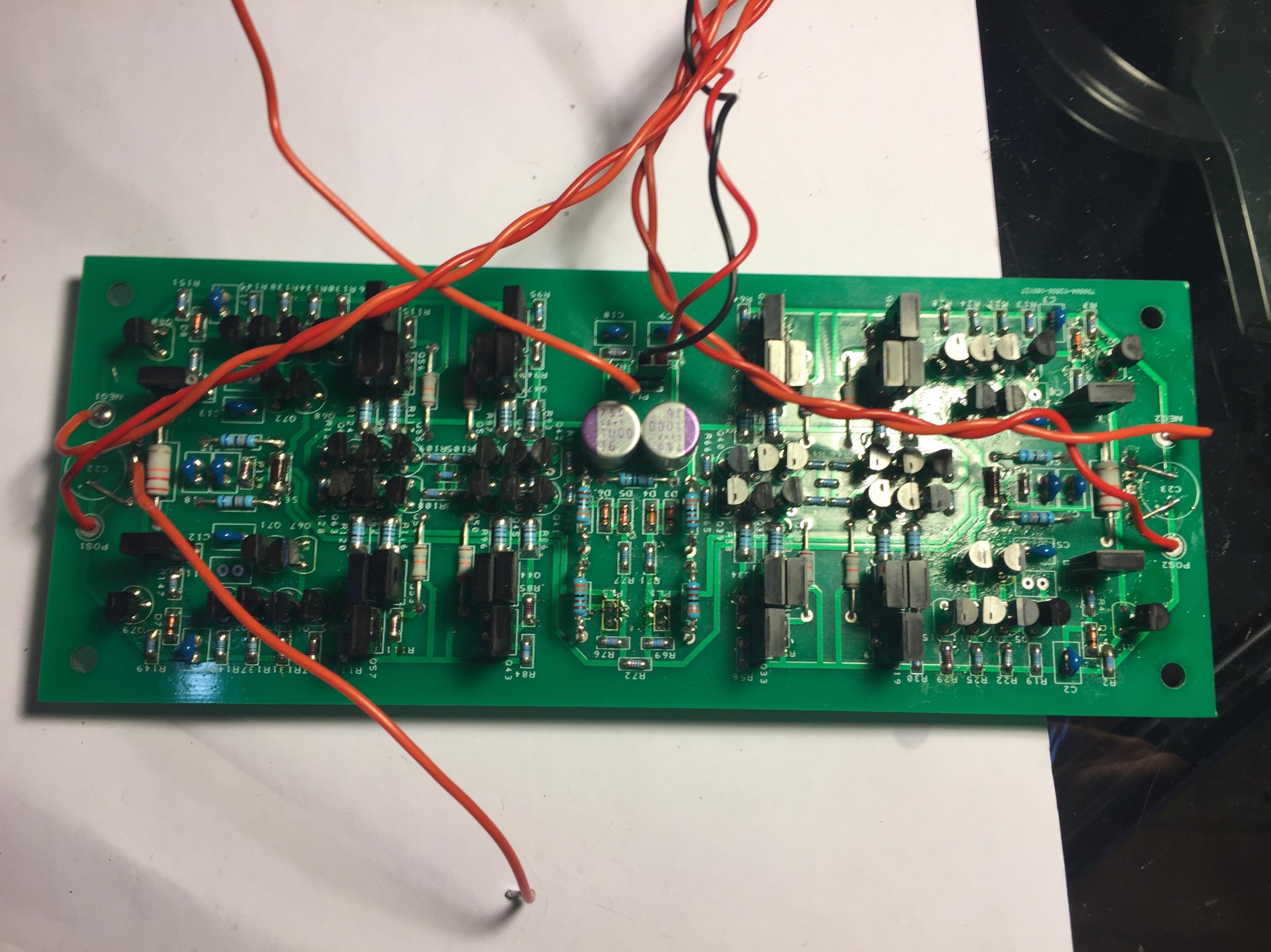

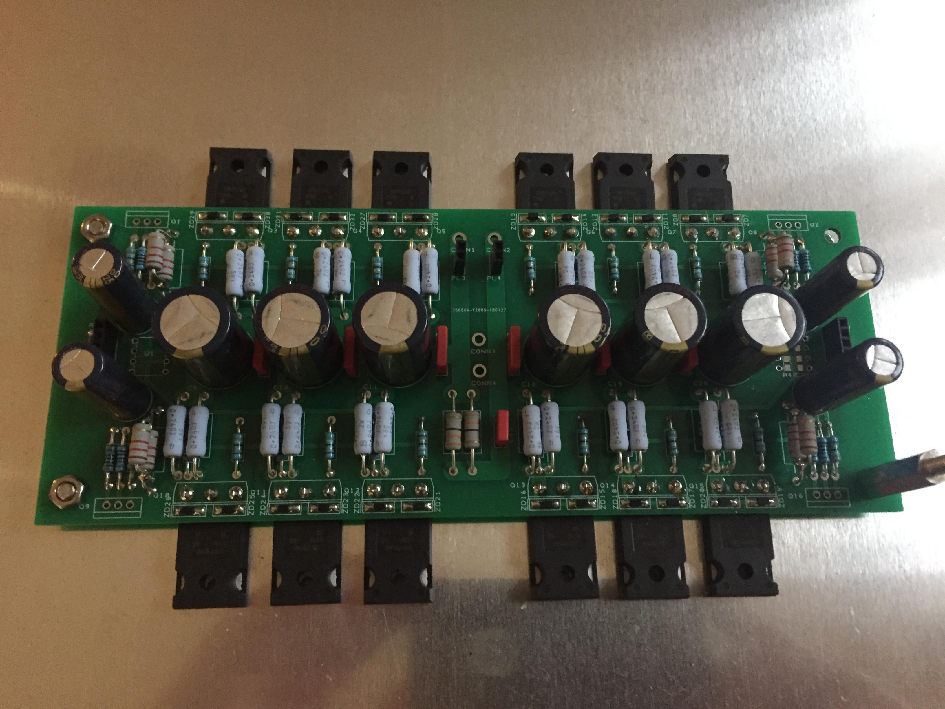

As requested an update. Not too much spare time but have made some progress. Have populated the IPS PCB and debugged it. having found that Farnell had labelled some of the component bags incorrectly. The BC546 were labelled as BC556 and vice versa along with some of the MELF resistors. Lesson learnt, never make assumptions. If it wasn't for this misfortune the PCB would have worked first time. Shows that LTSpice is pretty accurate. So now onto completing the OPS PCB i.e. soldering the drivers and completing the temporary metal work. First run will be without any biasing (LT1166).
Here are a couple of pics. Not the best quality but will give you an idea of what I'm making :)
Bespav,
Your circuit looks interesting. I keep looking at cascode OPS. Could use one on this design. The amount of voltage swing available even after taking into account the loss due to the cascodes would be more than adequate. But so far in simulations have yet to see any significant advantage. That's not to say there isn't any just nothing I have seen in my limited experience.
