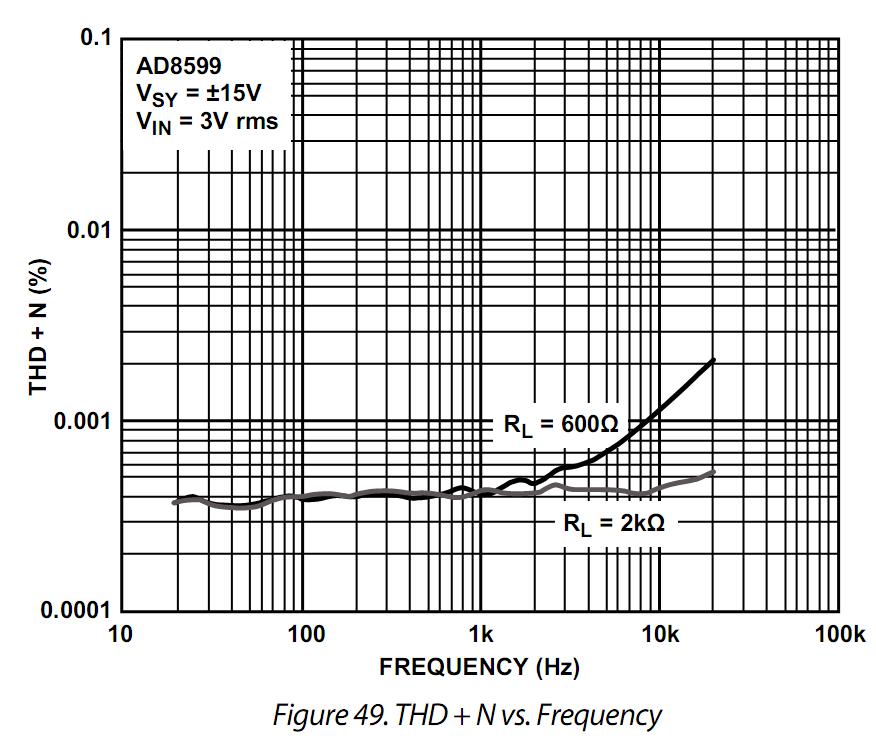

I currently designing preamp/headphone amp. I have some problem with design fully balanced input. It should accept balanced and unbalanced signal comming from input selector. This unit will be driving relay volume control.
Relay volume control input is about 2,5kOhm, but it would be great to lower is as this will lower output impedance and overall noise floor.
I would like to use AD8599 in this unit, but if you look into data sheet there is showed that THD vs freq for 2kOhm
load is much better than for 600Ohm. So I want to have load of AD8599 no lower than 2kOhm, but also I want to have S/N ratio better than 120dB. This is main problem. Gain for this input should be 10dB (best swichable to 16dB for unbalanced inputs).
I was thinking about using voltage followers (maybe on AD8397) in nested feedback on main outputs.
Can you help me with this design ??
U1, U2, U3, U5 it will be AD8599, and U4, U6 it could be AD8397.
For now I have two solutions:
1 - not symetrical, and U4 load is different than U6 load, noise is different on + and - output
2 - symetrical - it could be good, but S/N would be lower by about 3dB. I prefer this version.
Do you have some clever idea how to make this better

the AD8397 isn't totally happy in unity gain and its input doesn't like to swing full Vsupply so it should be used with gain of +2 or more - this can still be done inside a feedback loop

Why not use a fully balanced OP-amp like AD8132, AD8137, AD8138, LME49724 or OPA1632 ???
Even better:
THAT Corporation 1606/1646 OutSmarts Balanced Line Driver ICs
I recently ordered parts to build a couple of those (circuit in datasheet).

I am a little bit afraid of fully balanced op amps, not from technical reasons, but from sonics.
You know AD8599 have very good opinion, about fully differential op amps there is less information.
Which one would you choose:
AD8132 - cheap, easy to buy, very fast, seams low THD
AD8137 - my supplier don't have it, cheap, very fast
AD8138 - cheap, low noise, fast
LME49724 - my supplier don't have it, impressive datasheet
OPA1632 - cheap, low noise, fast
SSM2141 - cost like others, but specification is far worse, higher noise, big resistors in feedback
THAT1646 - it is amazing for me, but my supplier have it, cost is ok, specification is ok,
For now I would give a try to OPA1632. Which one you would choose.
