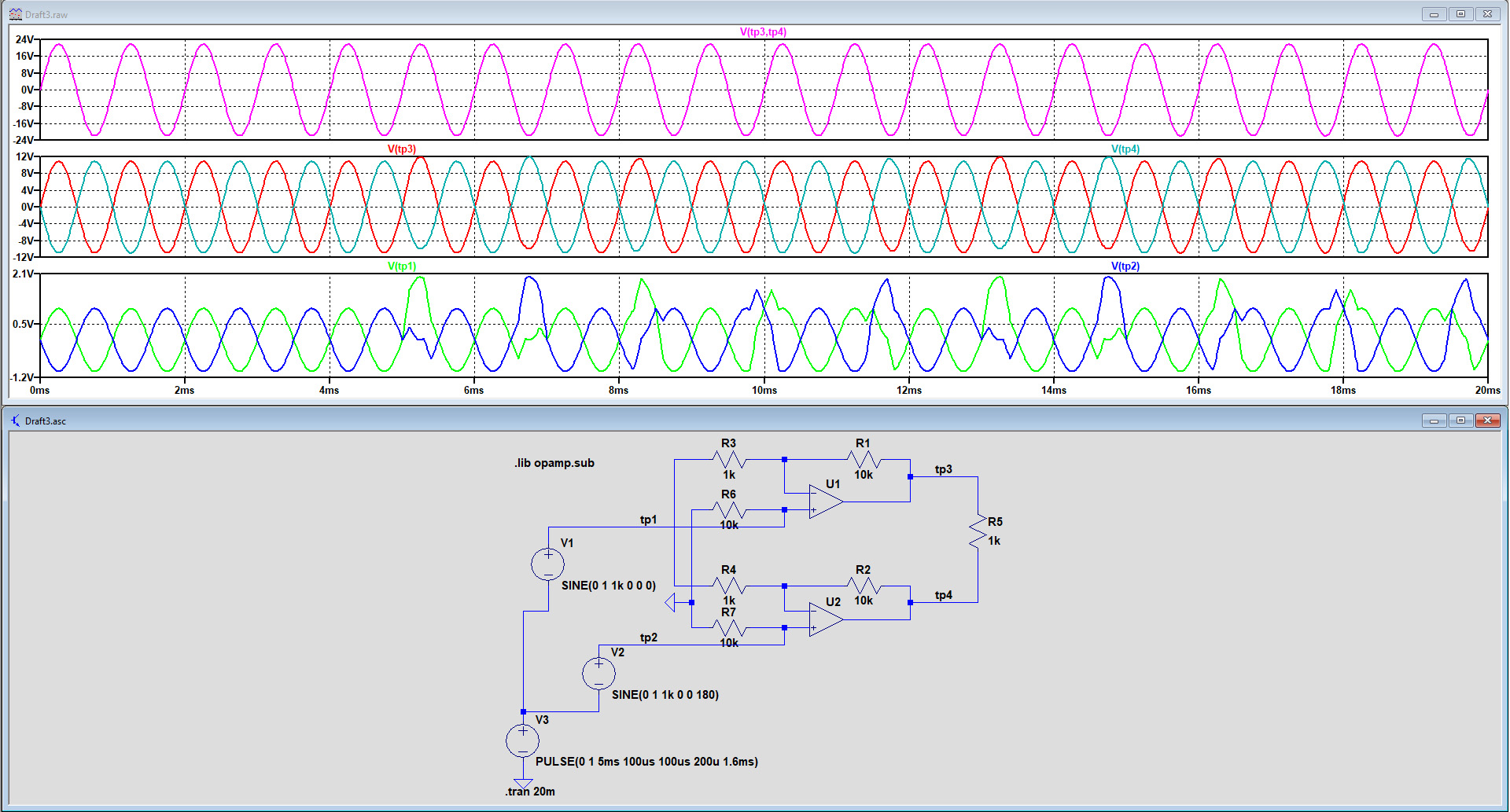

I'm sorry Mark, but you are wrong.
It is correct that common mode gain is one, but on both sides of the speaker, the end result is no signal to the speaker.
Put things in LTSpice and you will notice what wrong in your opinion.
Hans
I disagree, there is no need for this additional complication.
The circuit diagram as shown has a perfect CMRR, see image below.
V(out+) and V(Out-) are common mode polluted to the main amp's input.
At the speaker output, in this image divided by 40 to get the same scale, this common mode signal is completely removed.
Indeed, but that's not what I'm talking about, there is a common-mode signal injected into both amps, shifting the cross-over point and the clipping threshold.
Hans
I am not saying the differential signal seen by the speaker is affected directly, but that the system is not balanced, and will be indirectly impacted by the shifts.
A standard diff->SE conversion will handle > +/-25V of common mode (assuming standard opamp rails and circuit) without any shifting of clipping or cross-over point and is standard practice for this reason (and because not all setups are bridged of course). Basically no common-mode signal gets into the system past the input differential amp.
Your approach pushes the common mode signal right through the amp and out the other side. From the point of view of the speaker signal the common mode input is directly injected onto both power rails. Its not balanced unless the input is balanced and originating from a system with the same ground potential. If the systems were at the same ground potential there would be little need for a differential signal in the first place.
Run your simulation with 25V mains hum as common-mode on the inputs and look at the behaviour.

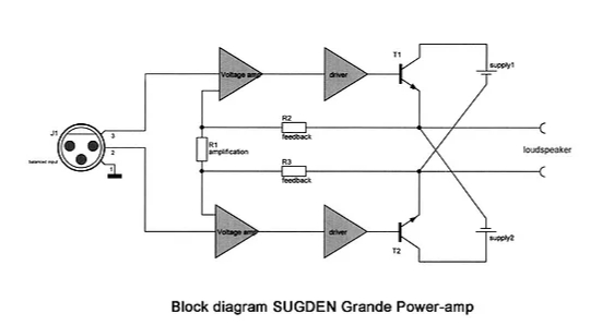

The words "Fully balanced" occur in the subject line, I guess the question is whether this means "roughly balanced depending" or not (!)
Sugden Grande monoblock amplifier A class.

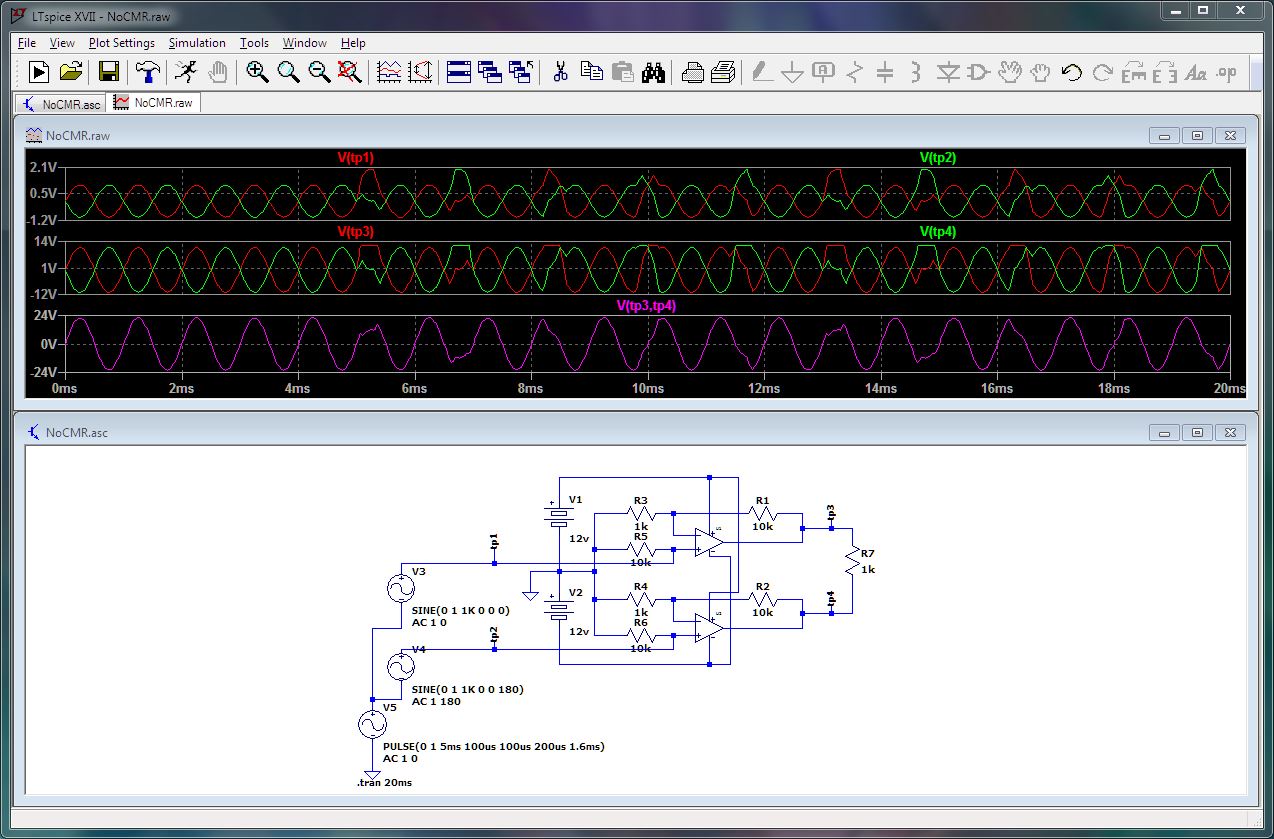

Okay ... take a look at the thumbnail... Here we have a pair of amplifiers in a BTL configuration being fed by a balanced (i.e. out of phase) input pair. As you suggested I am feeding the input signals directly into the amplifiers.
The top two traces are the inputs which start out clean and then suffer some common mode noise.
The middle two traces are the amplifier's outputs... I see the noise, I see clipping, I see distortion. Since the amplifiers are clipping, the common mode noise is not filtered at the output... and it will become audible along with the clipping.
Finally the bottom trace is the BTL output... not so good is it?

^How on earth could a balanced source produce a 1V common mode signal, IF the source reference (ground, or whatever you may call it) is connected with the amp with a low impedance link? 1V over 1 Ohm produces 1 A of equalizing currents....
In your example, you are using ground as a rock solid reference, but if a real world source references to the same ground it would not be possible to produce such an extreme CM signal.
It's rare, but I've seen XLR cables with 10 and 20 volt spikes riding on them from being passed near high voltage tubes, motors, transmitters and other noise sources.
It's pretty easy to ignore outside interference, but that is exactly what the XLR cables were developed to deal with.

Ok. I appreciate that you tried to come with some prove.
Unfortunately you have connected the junction of R3 and R4 to gnd.
Take it away, and the result is below, output is clean as it can be.
I have left the power supply because it takes no part in the equation.
