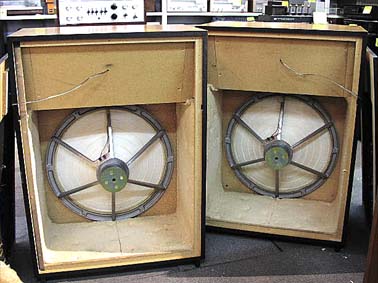

Koinichiwa,
taufern said:
hey all...ive been rotting out here in the middle of the indian ocean for operation iraqi freedom and i cant wait to get back to my new speaker projects...i am really thinking about doing some more dipoles i.e. a dual 15" dipole sub with a either a fullrange Infinite box on top or a two way dipole or infinite box on top...
Hartley build such a system with the Concert Master. This has a dipole 24" Woofer and an attached sealed enclosure with a 10 Inch "Fullrange" and a 7Inch "Tweeter".
The resultant behaviour of a moderate sealed box 10" Fullrange with a dipole Sub (and likely some overlap between Dipole and Monopole) makes for a rather nice directionality down to fairly low frequencies and with a Baffle around 30" wide and around 45" high and an 8" active cone the front radiation should remain controlled to an angle of around 160 Degrees from between below 200Hz and up to past 1.5KHz.
However, I suspect if the dipole Woofer is crossed over with a simple 1st order lowpass the dispersion will be modified and be much more cardiodic up to the point where the attenuation of the Woofer comes very large.
To make something similar with modern drivers, maybe Eminece Legend B102 might suit as "fullrange" - it is low Qt and hence needs some form of rear load.
http://editweb.iglou.com/eminence/eminence/pages/products02/pdf/legb102.pdf
Using a sealed rear load of around 30 Liter will give the B102 a resonance of 70Hz with a Qt near 0.5 (IIRC).
An Eminece Kappa 18 Woofer is a nice affordable choice for a dipole (A friend uses it to good effect), especially if driven via coil with some notable DCR to push up the Qt.
http://editweb.iglou.com/eminence/eminence/pages/products02/pdf/kap18.pdf
The Kappa may still need an active Amp to compensate the Dipole rolloff and match sensitivities, but I think I would keep any X-Over to first order any which way.
Adding a tweeter to B102 is clearly needed, I personally would likely just modify a Dual Piezo Horn, but many other options exist.
Sayonara
