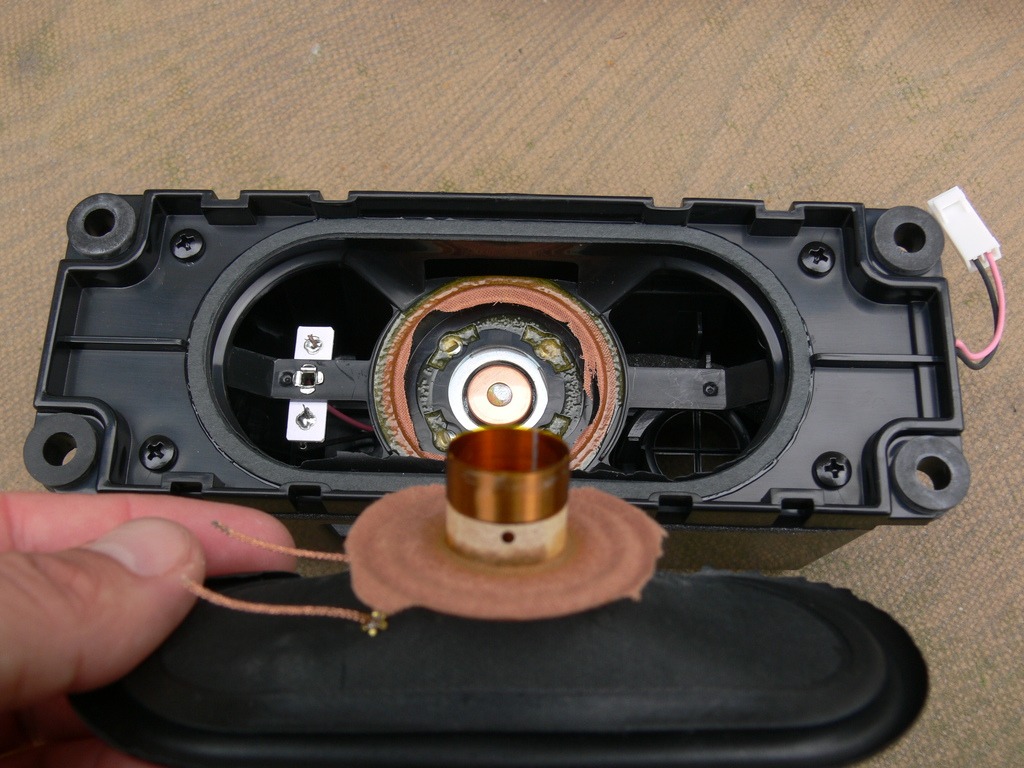

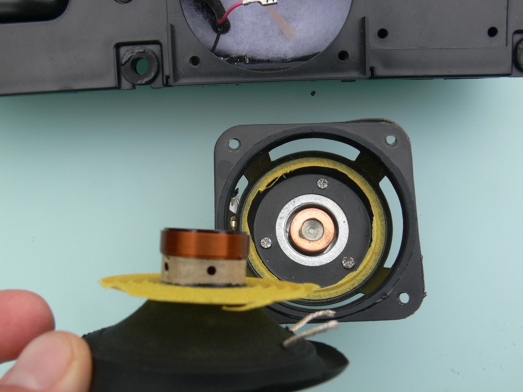

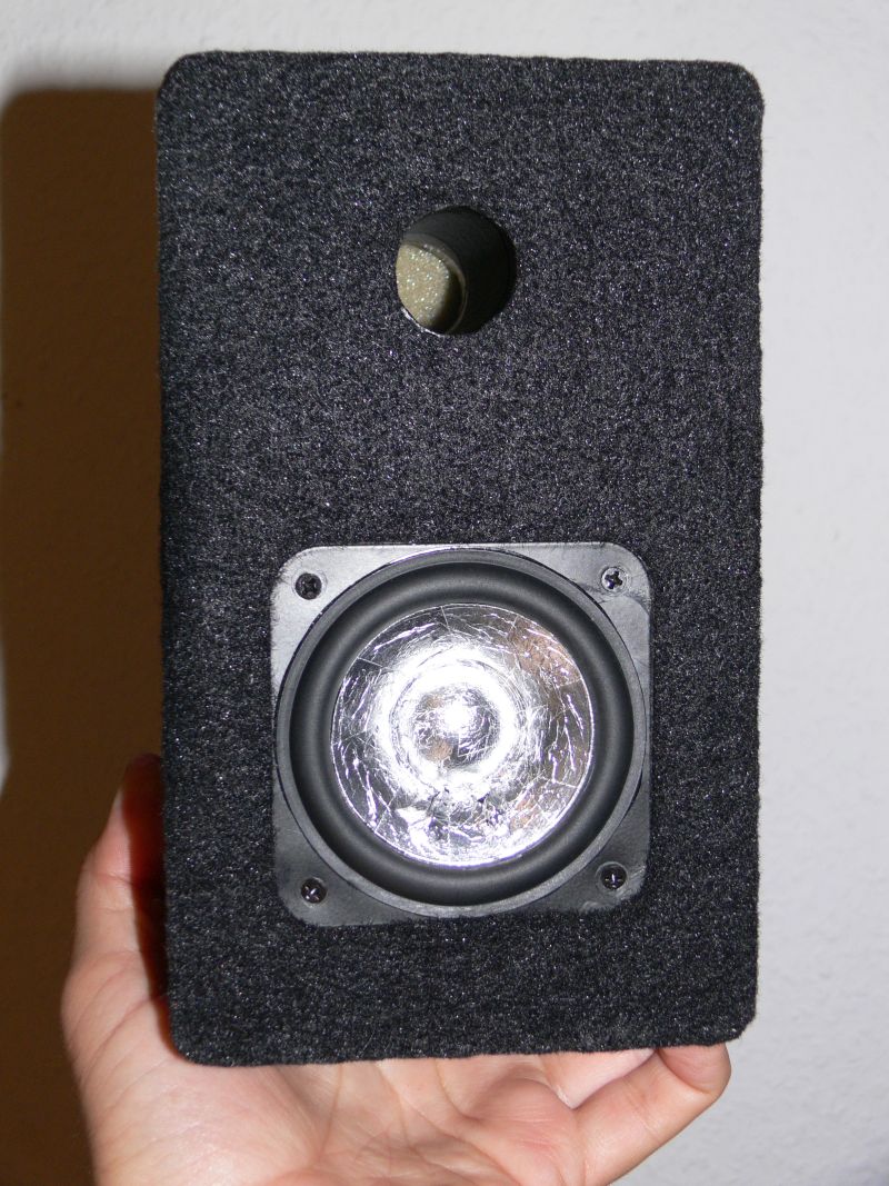

I luckily found after long search decent fullrange loudspeakers for little money.
They were sold as a rest and are out of production.
15cm fullrange which goes up to 12khz.
An 8 cm fullrange with Faraday ring which goes up to 18khz in a ready plastic bass reflex box. Drivers for only for 2,5 Euro each. I still own some dozens of them.

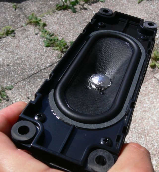

What I do is covering their paper diaphragms with aluminium foil one or both sides.
Now I use current drive amplifiers which makes fullrange drivers sound much better in frequency response and distortion behaviour
I like Pioneer polypropylen fullrange drivers made for car Hifi, they are good value for money if used with current drive amplifiers as already the diaphragm has a high sonic quality

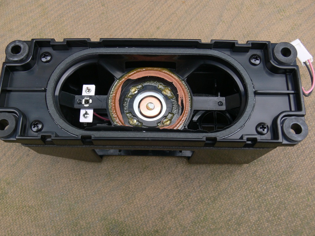

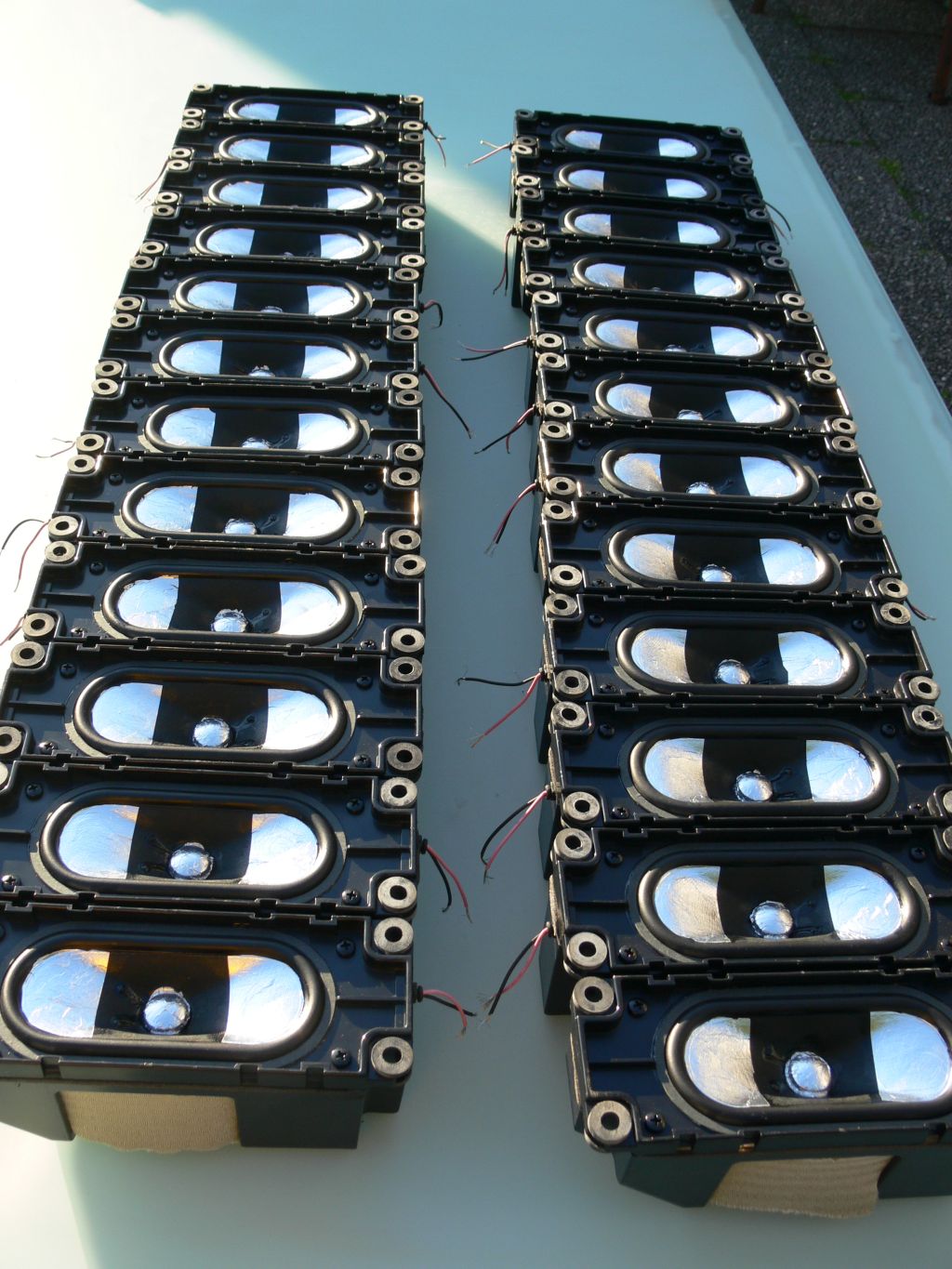

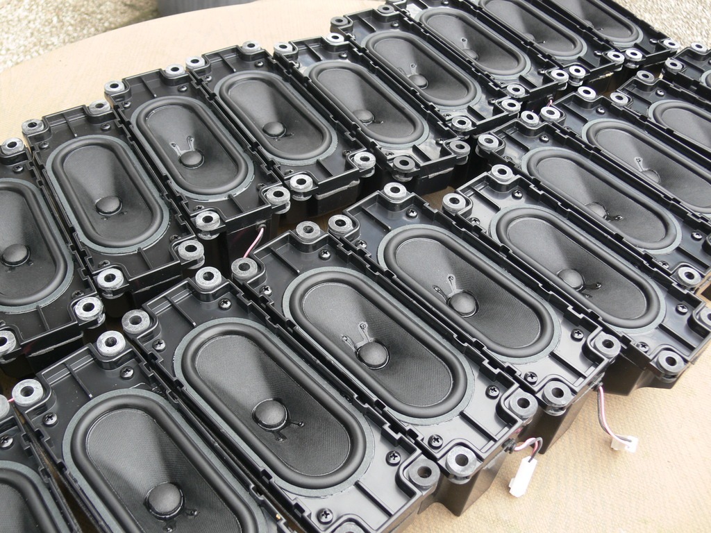

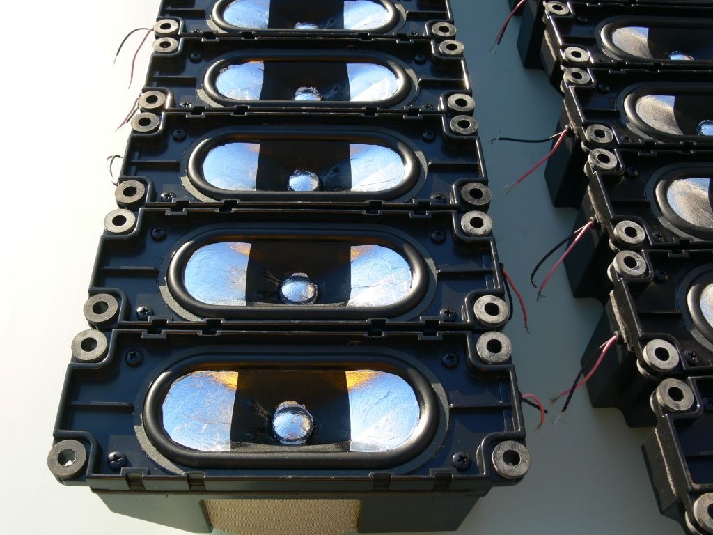

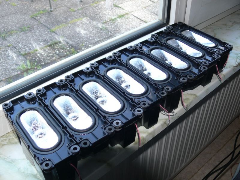

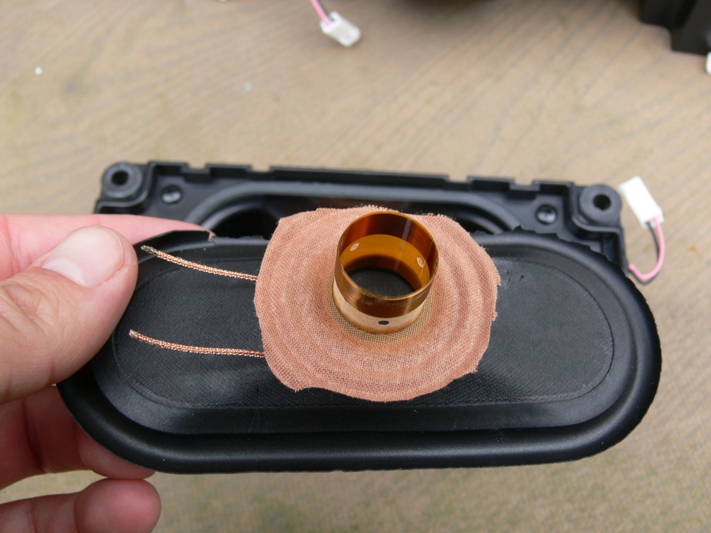

Here some fotos of cheap fullrange drivers covered with aluminium foil.
I also got some oval ones, also with faraday ring, the small drivers are from JVC and they made them for televisions named "RSP ...." .

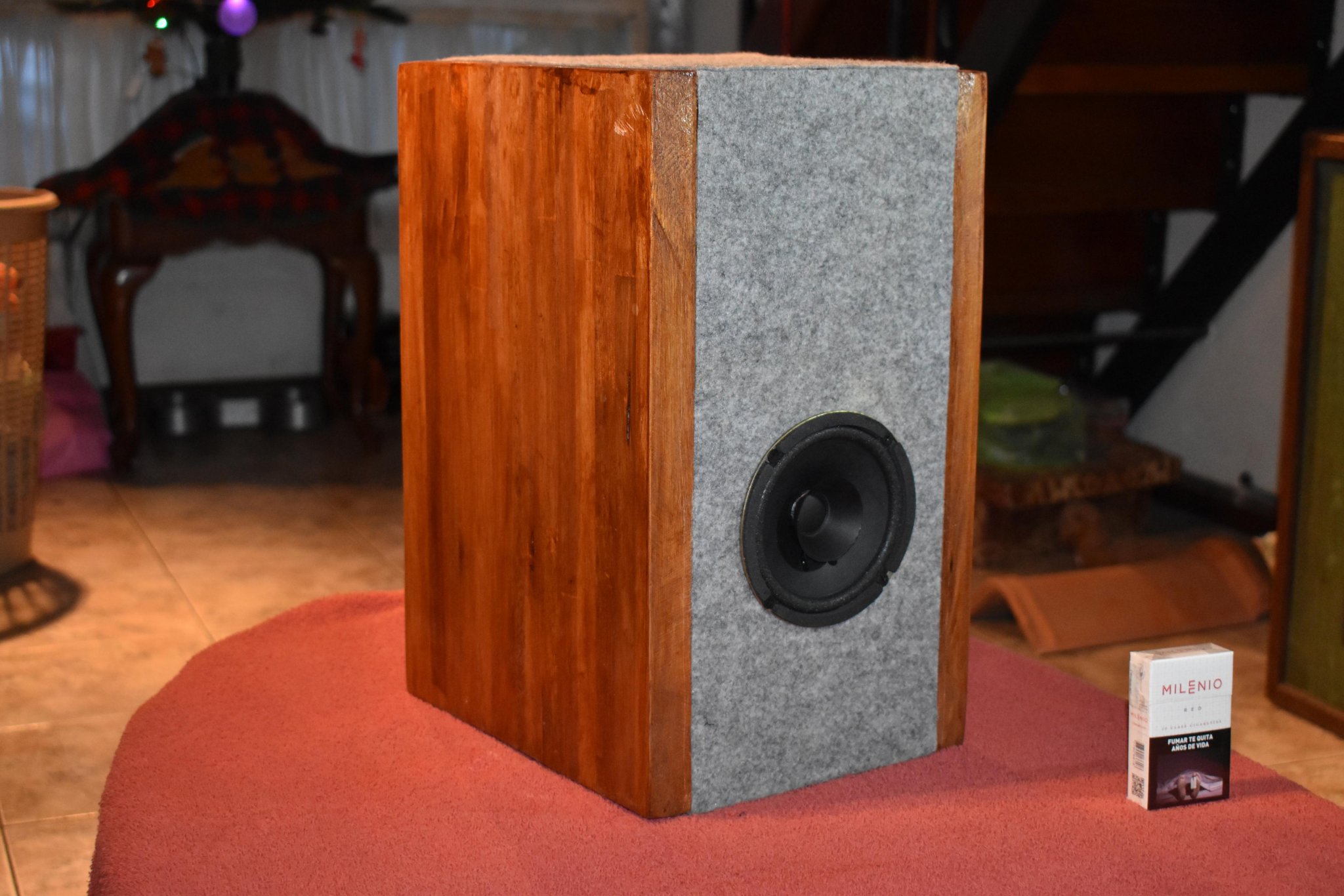

My foray into full-range...sounds beyond my expectations. As one who used this driver way way back in 1984 for my car, it always impressed me, the Radio Shack 40-1284 five inch driver.
Since then, this driver had been experimented with extensively, trying to squeeze its performance at its best. What others had found was a 17 liter aperiodic enclosure...it worked great...but sucks up power with its low Db rating. Considering such low sensitivity, that three-inch driver noted here would be even worse & should be used only for a desktop application.
At less than $20 each NOS, truly a bargain.
