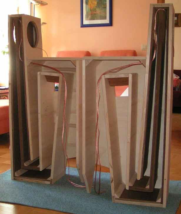

one important fakt i miss,
best result you get with two different horns,
a bipolar double horn, with a invers bassmid driver would be a
superb solution.
