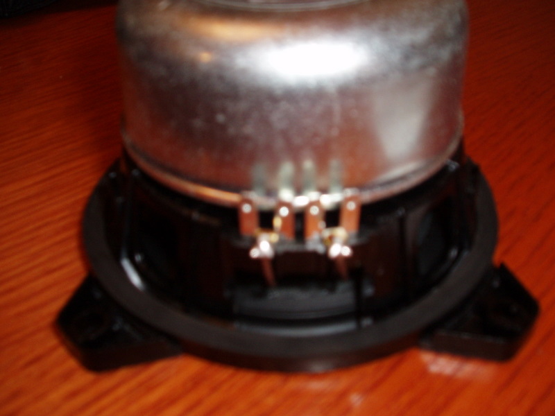

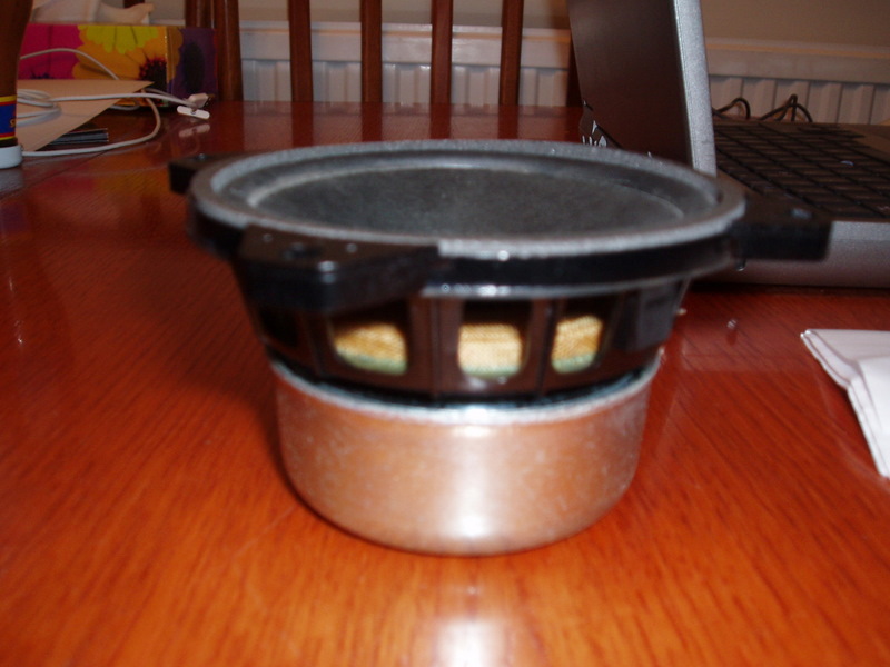

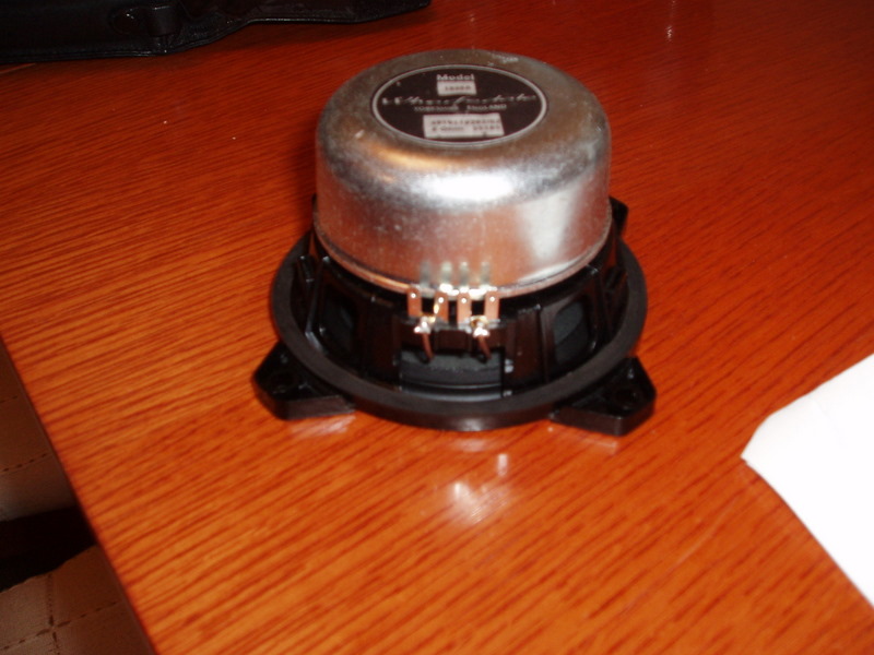

I have 3 of these drivers (pretty sure it's the same ones), they sound Ok, but not brilliant. This may be related to their past - someone I know was clearing out a recording studio - most of the equipment had already gone, but I got a 15" 'blown' (long story) woofer and 3 of these cubes.
This info will definately help.
Just noticed - mine are the 1038A version.
Paper cone, surprisingly long excursion for the size of the surround, plastic basket, magnetically shielded, 8ohm, foam gasket on the front, rubber seal on the back.
Have some pics anyway - let me know if they're the same or similar.
Chris
PS - I know the pics aren't good, but the digi camera's flash can't be set to half-power, so it was a combination of zoom and covering the lamp with paper etc.
Chris

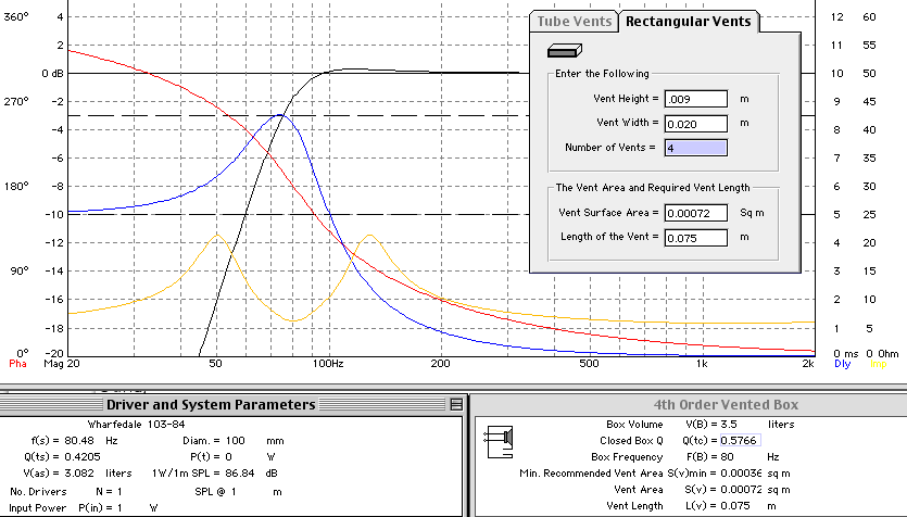

Here is a 1st pass sim of a Fonken-style box. The high resistance ports will lower the system Q, if you want a small speaker bump to get the illusion of more bass than they have, raise the tuning a bit (this will also shorten the port, so you have a better chance of fitting them in the box. With a box this small you will need to calculate the net volume quite accurately
dave
Not the old Wharfedale 4" with the giant soup can magnets. These would date from the Rank era.
With a plastic basket, there is likely a good chance they are Audax OEM units. A standard set of cone mods would probably do wonders to the sonics.

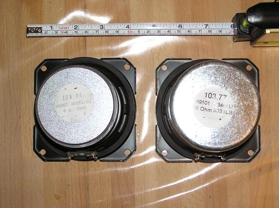

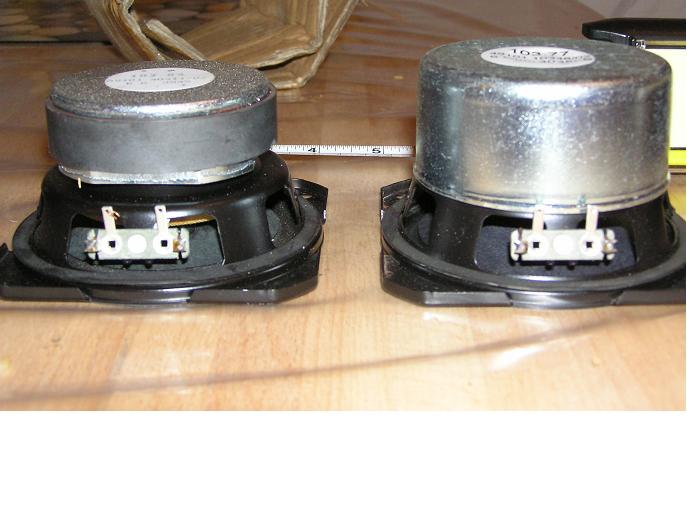

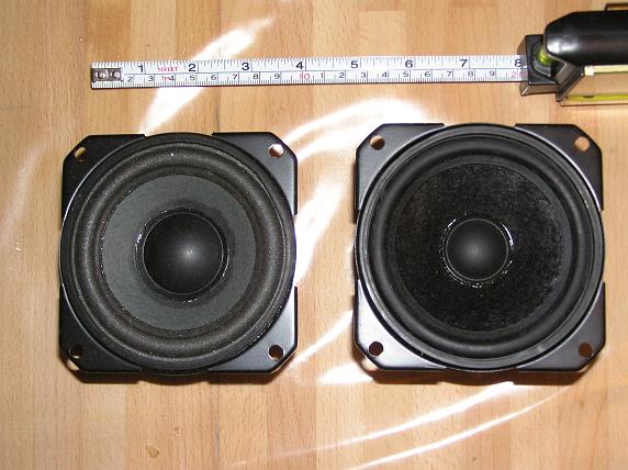

Here are some pictures.
I have two different types, more of the unsheilded 103.84 type (left on the photos) and some of a shielded type (103.77) that I was planning to use for the centre channel.
Chris - the drivers that you have look similar but possibly more modern than the ones that I have. I'm not sure how relevant the T/S parameters would be, however the ones I measured (for the unshielded 103.84) are similar to ones that I found on the web (for the shielded version).
Thanks for your replies

Hi Dave,
Thanks for running that sim - so if I'm reading it right then the box volume is 3.5L (not including the ports?) and 4 vents of 0.9 cm x 20 cm in length. I have a feeling that I came up with something similar to this in WinISD where the vents were so long I couldn't work out how to fit them in the box.
Jon
Jon
3.5 litres not including ports, back of the driver & the driver brace.
4 ports 9mm wide x 20mm high x 75 mm long (i chose 9mm wide because i understand that is a common material width in the UK). They could also be 6mm wide x 30mm high. From another recent post 6mm is also common. 6mm might be best use of sheet material -- port slot spacers could be 6mm, the panels could all be 2x6mm and a 3rd layer of 6mm added to the baffle to create a rebate (with sufficient material left to probably build a 2nd pair).
When designing these kind of boxes i go thru an iterative process to get the right balance of vent height & length to fit the box.
dave
dave
