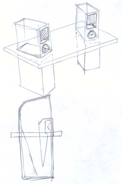

Maybe this is a little over the top for a computer system, but I like the idea and I'm a bit tempted to have a go myself if I get the time one day. How about using horns, but integrate a pair into a desk joining the two speaker cabinets, like the picture? and just sit the bottom of the cabs on the floor to support the desk and monitor etc.
Steve
