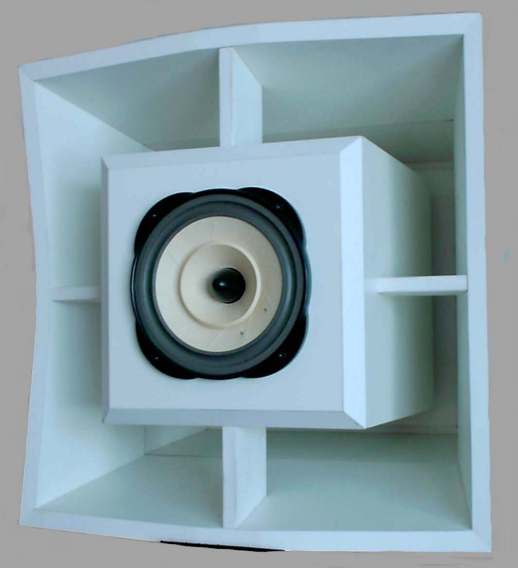

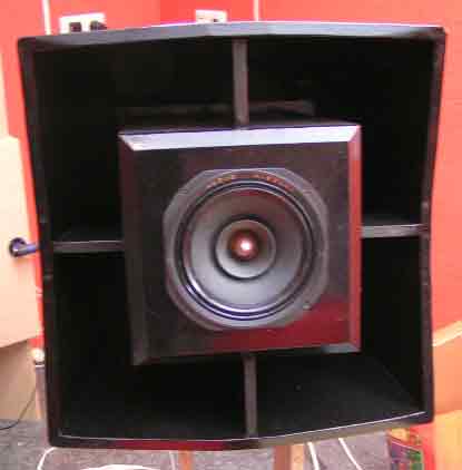

Hello,
for 100-105 dB
i would try something like my HORN-Sat,
with FE206, AN super 8", Sica 8" 1100, B 200

Thanks, I imagine that would be *Very lifelike
though I just want a simple box
having said that, the fostex 208 could be a good option
I realize I need at least 94 db sensitivity, so that reduces the options that I'm aware of to the 208, 166; the B200 or the new driver I linked to
for non horn loading, the B200 might be best??
