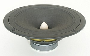

full range without whizzer cone
hi guys, im looking for an 8" full range driver, preferably with decent efficiency, that i can put a chrome dust cap on. bit of an odd request maybe but its for a particular application. it doesnt have to sound amazing, just good.
any ideas?
It's likely that the metallic dust cap will resonante badly, colouring the sound of any driver you fit it to.
Two modestly priced units that spring to mind are the Visaton B200 and the Fostex FF225K. The latter however is a WR unit, not an FR, with very limited excursion, so you'd need to horn load it, and add a tweeter. Q on the B200 is high, but it can be used in a variety of ways if you're careful enough.

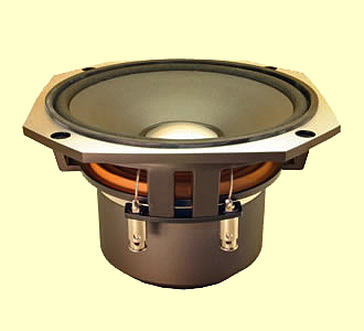

Fostex F200A would be ideal, but at a cost....
i have the B200's, very expensive and i couldnt make myself fit dustcaps to them. the fostex look gorgeous but i imagine they weigh a ton (portable project) and cost a lot, the bogens are deff the favorite at this stage. cheap, light and hopefully cheerful

The B20 does have a whizzer and not very good efficiency, probably still your best bet. salvage a plastic chrome dustcap off some junk drivers.
You won't find much, 8 inches is a bit big for a fullranger even with a whizzer. 6 or 6.5 inches would open up a lot of options.
hmmm. maybe the beyma 8ag/n, and cut out the whizzer and glue a dustcap in, theyre pretty sensitive.. would that sound horrible, how much damage will that do to the sound?

de whizzering a driver is a possibility. you might have problems with the depth of the drivers you buy too.

>how do the Bogen S86's sound?
>theyre industrial type speakers right?
Right.
They have fs~100 Hz Qts~2.2
sort of an industry standard ...
they sound very lively ....
the thing that differentiates them
from the other easily available 8"ers
is the efficiency ... AND .... (for your app)
lack of whizzer .....
They sound very good.
Designed both for 'intelligibility' (intercom)
and 'foreground music' (involving muzak)
But just down to 100 Hz .....
If you want to go down to ~50Hz .....
