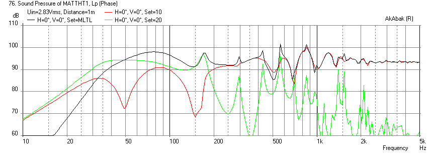

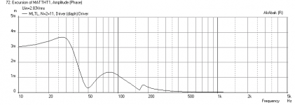

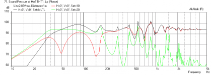

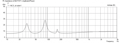

Simulation results and proposed design
Matthtvr,
These drivers need a slightly bigger box so I increased length to 1.2m and depth is 38cm width is 28cm. The vent at the bottom is a 4 in dia hole cut in 0.75 in thick material. The speaker stands on 2 in tall feet to allow the bass to escape from the vent. You can use rectangular slots if you wish, just keep the cross sectional area about the same. The driver is located 24 cm from the top. I simulated the foam as increasing amounts of damping internally over 4 segments. It is tough to model that but I guess the bigger the pyramid of foam, the less bass amplitude you get but with smoother mids. This speaker requires floor and wall enhancement for the bass so place it about 4 in away from back wall to boost bass output and flatten response, otherwise bass will be a bit under emphasized. This design achieves a -3dB point at 42 Hz and an overall 94 dB average efficiency at 1m and 2.83V input. The design uses a 1.0 mH and 4 ohm resistor BSC circuit to flatten the rising response.
I ran the simulation with both the ferrite magnet and cobalt magnet versions. Save your money, there is very small advantage in bass extension with the cobalt version - probably not worth it IMO.
The plots are for the ferrite version: SPL vs freq., cone displacement, impedance, and last plot is the cobalt version SPL vs freq.
If you move it away from wall you will start to get cancellation dips and reduced bass extension.

Im a newbie on this so what do you mean with 1.0ohm, 4ohm resistor, do i need it you mean? if so which parts do i need to buy for this circuit? I have found 1.0mh part, but which awg is best? And any particular brand? or doesnt it matter? How should it be put together?

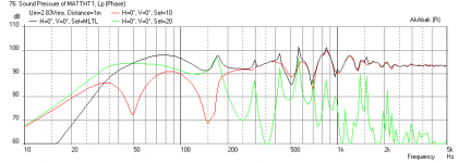

I add the Spl diagram of both Ferrite and alnico here, and as you said they behave almost identically, but i have heard that naturflex style/alnico magnet is very organic sounding and fast without clipping, saw a descrip that it was like a tube amp and ferrite as a SS amp, and also the good diffusor at the drier back/12cm big sphere magnet, but maybe it isnt worth it as the ferrite seems fine?
SPL Ferrite Alnico - Ladda-upp.se
