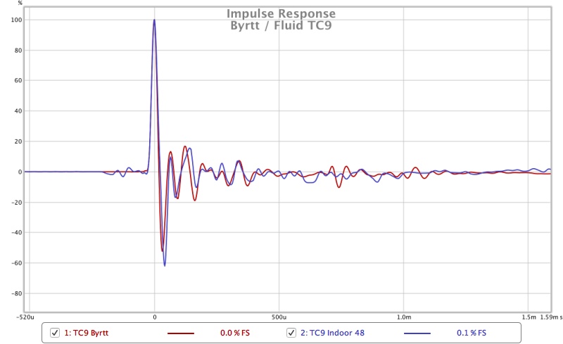

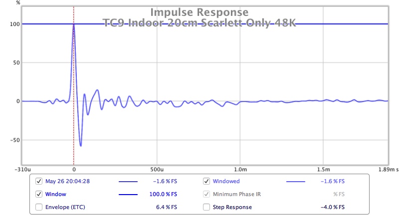

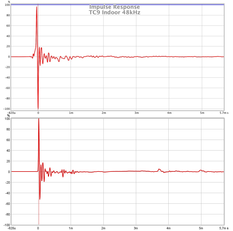

If it can help here comparison between fluids new single TC9 at 48kHz IR on presumable Australian cardboard as upper one and mine 192kHz chain of single TC9 onto European cardboard as lower one, tried again tweak same scales and color.
Not only take off at attack side of IR looks non textbook also as wesayso spottet agree bit strange how high downward peaks, if we look at below visual guidance from think it was Wikipedia then there got to be some enormous VHF frq boosting taking place somewhere.
It's strange though, the peak that hits 100% is the downward one....

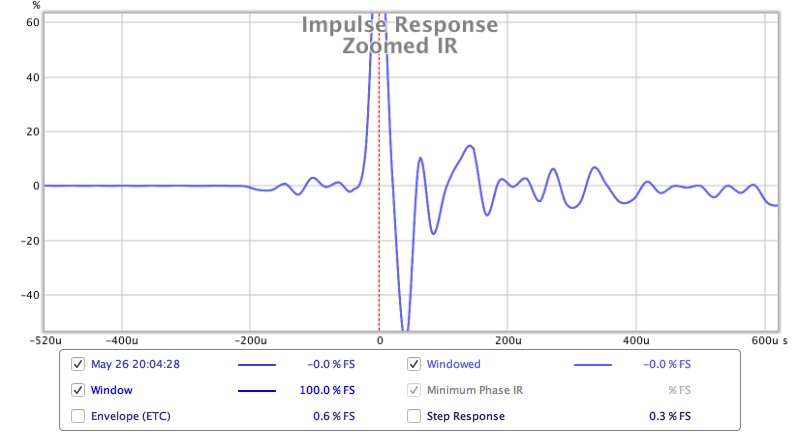

I ran a loopback on the Scarlett to make a cal file at 48K balanced to balanced using the same mic input.
I then ran the measurement again with the input gain turned down a little and the level up, I think that helps to reduce the background noise as I was seeing -60 on the REW meter with the mic open whereas before it was closer to -45.
This is the impulse, much better still a little bit of a wiggle before the peak but nothing like before so I think we can say that most of it was coming from the Najda.
I will do a loopback measurement of the Najda through the Scarlett to see what it looks like and also the impulse of the Scarlett by itself but I have run out of time tonight.
The mic mount could be part of it too and I will just strap it straight to the stand to see if there is a difference. I thought I had a standard mic clip but if I do it is hiding. That mount came from a Behringer studio mic that was made to look like a Neumann U87, not for a slim measurement mic!

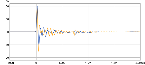

...This is the impulse, much better still a little bit of a wiggle before the peak but nothing like before so I think we can say that most of it was coming from the Najda...
Wow much better a little pre ringing is much more normal at attack side and downward peak at decay side starts look normal too, glad we move forward spending time on this. On Windows using two USB soundcard interfaces at same time can also sometimes be weird even they when run each by each bench a loop perfect, sometimes changing to another physical USB port helps and often think its IRQ sharing related on that platform, but lets see where next test brings you on a fresh new day.

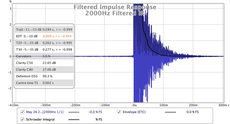

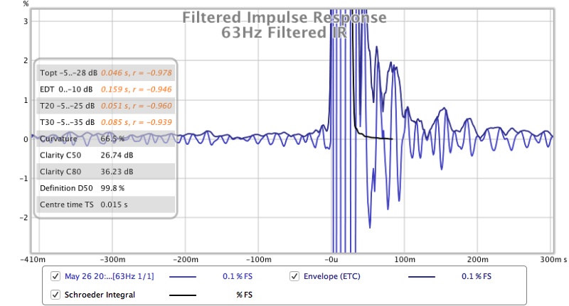

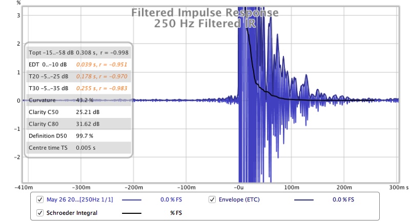

What does it look like on the filtered IR tab? It doesn't look like the pré ringing from buffer settings to me, that's more regular in shape like this:
It looks like some pré noise before the start of the measurement. It should show up before the peak in the filtered IR tab.

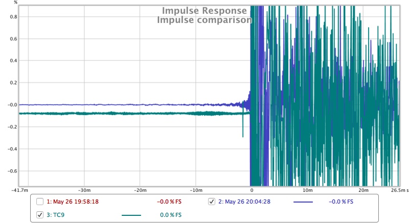

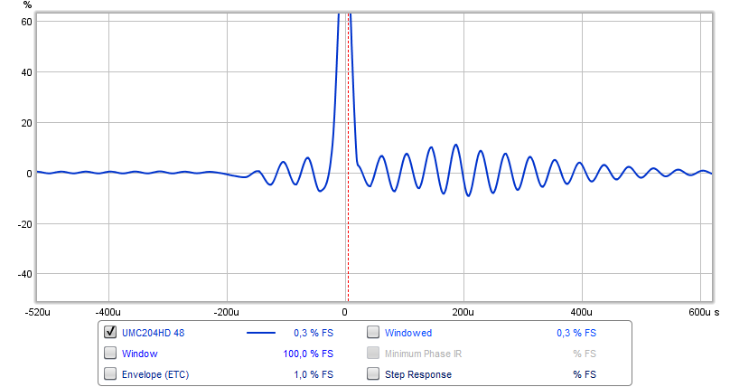

This is the impulse zoomed in to show a clearer view of what happens before the peak. There is a very straight line until -200u when the wiggles start...

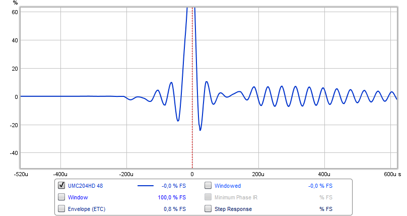

Could be wrong but if you ask me and that FocusRite have the fine Xmos USB asynchronous chip combined Cirrus converters as is case for Behringers UMC204HD it looks we get modern looking ringing schemes, look at first below for that interface I/O looped when IR is not aligned with button "Estimate IR Delay" from minus 200uS -100uS it looks exactly as yours but it change look when IR is aligned with "Estimate IR Delay" button as shown in second visual, sample rate was at 48kHz and for this interface I can't stand the weird ringing schemes it perform at various sample rates, only exception is up at 192kHz it start look fine but then can't use it as native player card so its only for measurements or parked on a shelf.

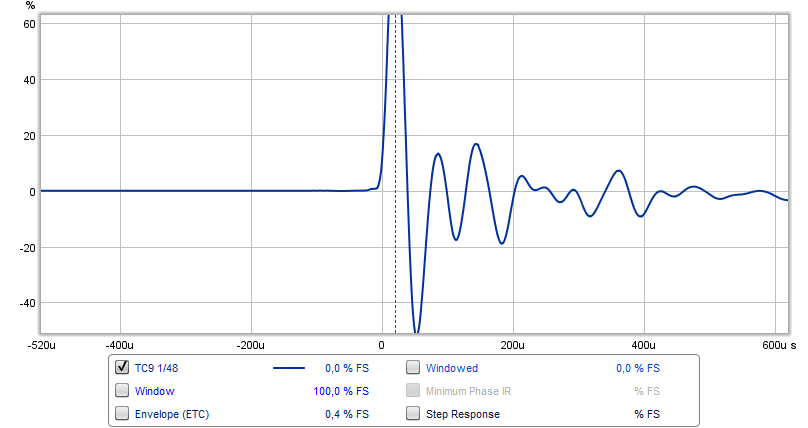

Third one is good old M-Audio AP192 measuring TC9 at 192kHz with new zoomed scales as yours, this card performs great at whatever rate its run and why i use it on player and measurement computer.
EDIT: wrong words used above in 200uS -100uS don't look exactly same but scheme is very close.
These are some graphs from the filtered IR, is what you mean?What does it look like on the filtered IR tab?
63 is probably power line hum
I will check the pure loopback IR to see what it looks like. It is possible that a linear phase brickwall filter has been used in the DAC section and that is what is causing the pre ringing. It may be that your m-audio uses a minimum phase reconstruction filter which does not have pre ringing. I can check my other DAC's too to see the differences.it looks we get modern looking ringing schemes,
To compare our two single TC9 IR in overlays window hang on exportet IR below and actual think they looks close, file extension was renamed from zip folder to dot asc because size extends limit for zip files, when downloaded rename extension to dot zip.

This will work . I figured to look at it in %dB instead of %FS but you've gone searching for the separate components creating the disturbance.
It does look like that hum is the cause of the most benign pré ringing. I't still rather low as should be seen in the %dB mode (change it within graphic's window upper left).
It might be some power line hum as you indicated or being caused by DAC filters.
If you let REW center the peak does it look more like a growing sine instead of this irregular wave shape? Like in BYRTT's example?

Ha ha grass all over there was thinking of more normal IR view as shown earlier on ala in below example between TC9 and SB65.

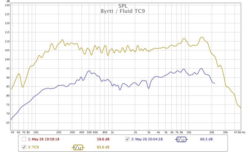

When we are into IR land exchange here are a fun view discovered if we like see IR without acoustic grass as being outside probably also lifted above surface : )
Set REW measurement window to FDW 1/6 width in octaves and after that divide on "All SPL" tab with DC-light speed IR offset in amplitude to zero dB, and to get that either create it in Rephase at same sample rate or divide own measurement with itself will out put a perfect IR.
Below FDW 1/6 up front measurement is two way FAST as its tonality is set for now to get best room cooperation so far being a on wall system. When divided its nice data to look at and dream about : ) in below i didn't divide with perfect IR but used my player computers soundcard loop IR where its input filter is not staying into listening chain at playback mode, for other soundcard sitting in computer steering speaker system doesn't matter because it sits inside DSP correction and stay there, and REW had microphone correction file at measurement time. One late night sat try predict at what points chain could produce bit of excess phase and divided them then sudden it was also changing amplitude response of speaker and it looked so scary close to my microphone curve even it wasn't used at exercise, ha ha was so tired at that time that have hard to remember what i did and learn from it. Have lately got some nice hardcore EQ correction up running performing excellent waterfall and sound except where foam core enclosure starts ratling its grass, expect when fluid and wesayso down the road gets tamed this threads arrays we will see once more excellent array performance out at listening position.

I'm more convinced that it is the DAC filter now but I suppose most measurements will have some amount of power line hum if you look that closely! If I set estimate IR delay it looks less symmetrical.
I have exported the IR and attached in a zip. Mine was much smaller in size so no need to rename.
Maybe you could download it and show me a screenshot of what you mean in the filtered IR? I am by no means an REW expert so we could be going backwards and forwards otherwise.
I have a few DAC's that have selectable filters so it will be interesting to see the measurements when compared. If it is only pre-ringing from a linear phase filter then I am not worried because that is baked in and I can't change it. If it was a setup problem then that would be more of a concern.Probably right about reconstruction filter is mostly using digital filters to save on component numbers and in its lower cost soundcard they also save on better intelligent firmware that shift to best filters based on sample rates but instead use one and same filter for all rates.
Oops, forgot the zoom. I exported an imported mine because your's was normalised they look more similar now. I think your cardboard must load the driver better because you have much more low frequency output and a smoother response overall. I think the balance of more high frequencies is what is causing my impulse to swing lower than yours.Ha ha grass all over there was thinking of more normal IR view as shown earlier on ala in below example between TC9 and SB65.
