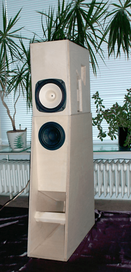

look the SCHALMEI SAT + ALPHORN http://www.hm-moreart.de/9.htm
