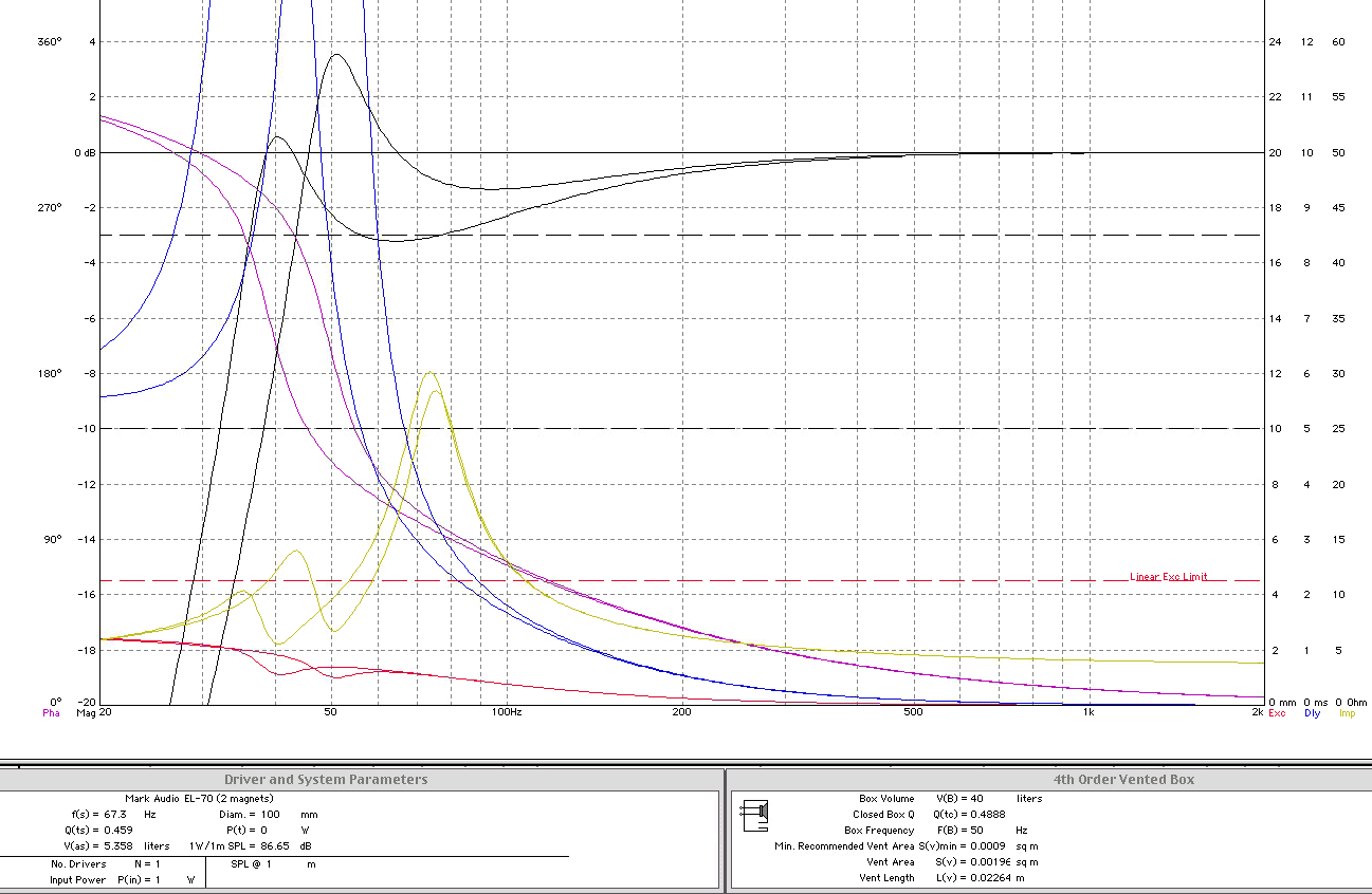

The original design I had them in a 40 litre enclosure tuned to 40 or 50 hz, basically looking for about 50hz output at moderate levels. They would only take about 10 watts and manage about 90db at 50hz. The response doesnt look that flat either which may be a result of trying make them dig that bit deeper.

A reflex that size for the EL70 is too large. As can be seen in the sims, your proposed design gives a pretty ugly response.
attachment.php
I feel that the optimal volume for the EL70 in a reflex box is around 13 litre. Quarter-wave designs (TLs) are required to take advantage of larger volumes.
There are MANY proven designs for the EL70, i would suggest going with a set of those. or at least look at them.

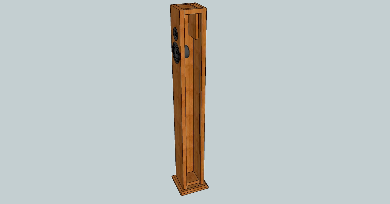

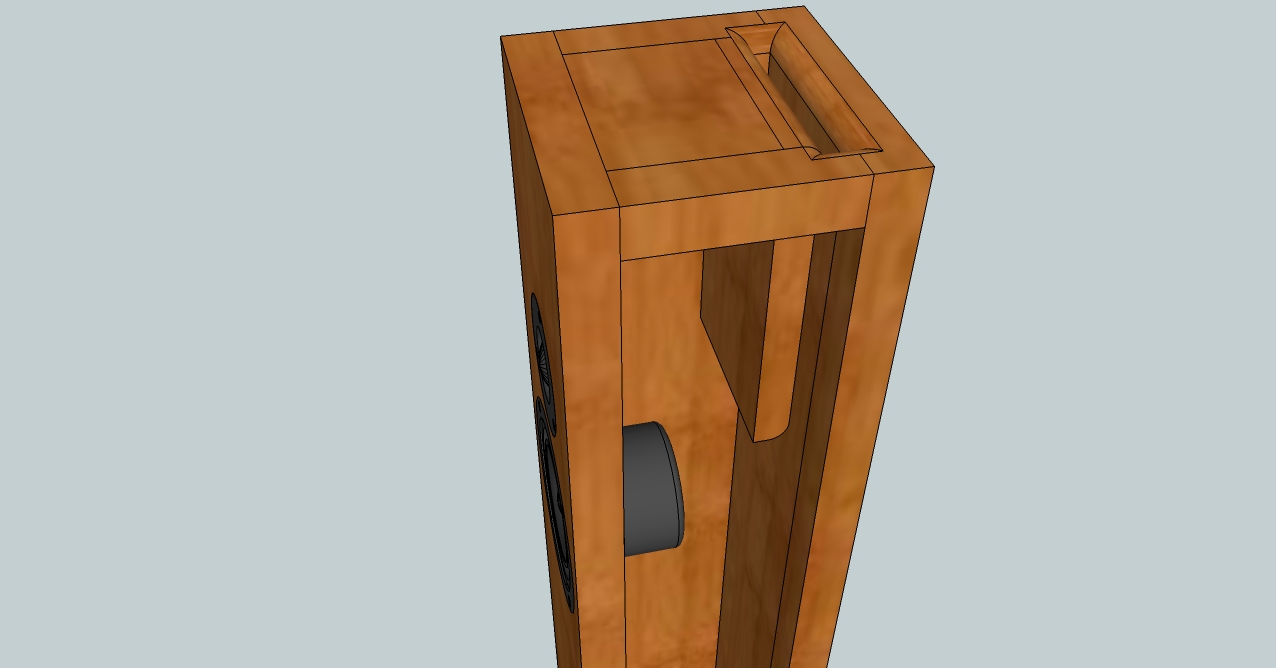

Some images of my proposed build, which also used the ERT26. Ive no idea where to really start with the crossover though.

You know, the kit has sat there for ages with me thinking that I'll probably be disappointed with the results and after my original goal for them didnt really happen, just kinda left them there doing nowt. Your comment has actually got me interested in doing something with them now. What about the model I made, does it look ok? What about some sort of crossover from the main driver and the tweeter, and should the crossover include a HPF as well?

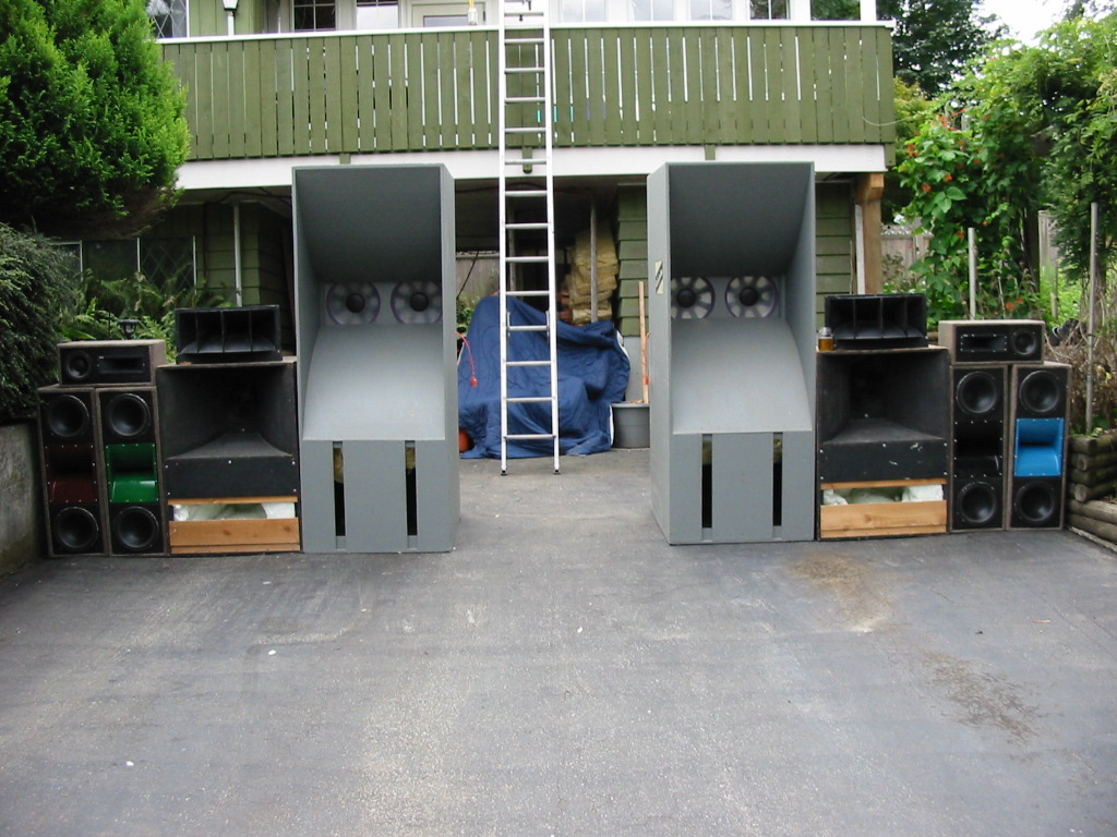

Moonfly, I have a set of the FH MKIII version and yes they are impressive for the size, no doubt. I use them and nothing else for my bedroom TV and music and they don't disappoint. Mind blowing? Well, I guess that's up to the beholder and I don't want you to be disappointed so let me just say they are good. I won't say more than that because I am a large speaker kind of guy and for them to even qualify as good is saying something.
refresh our memory with some photos of your big boy speakers for context 😉
I think some of your big compression drivers might have diaphragms not much smaller than the EL70 cones. 🙂
