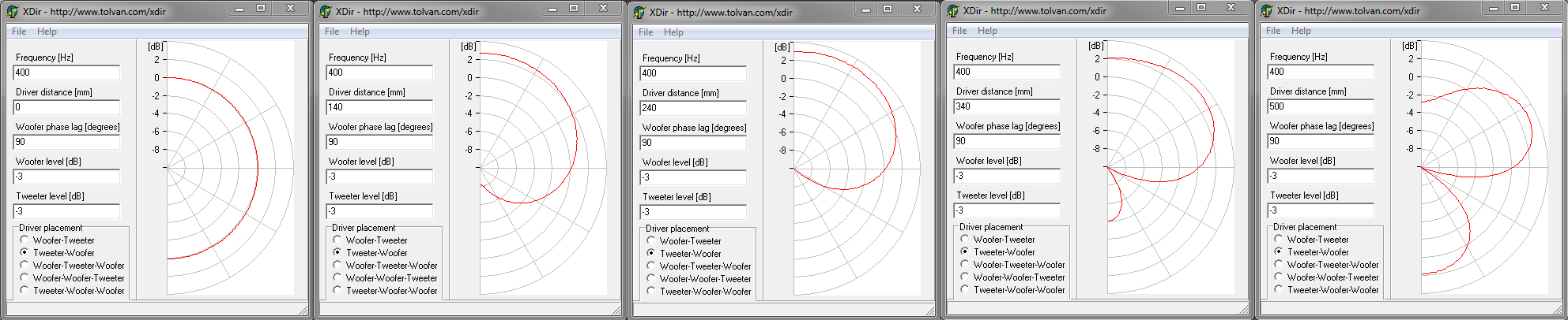

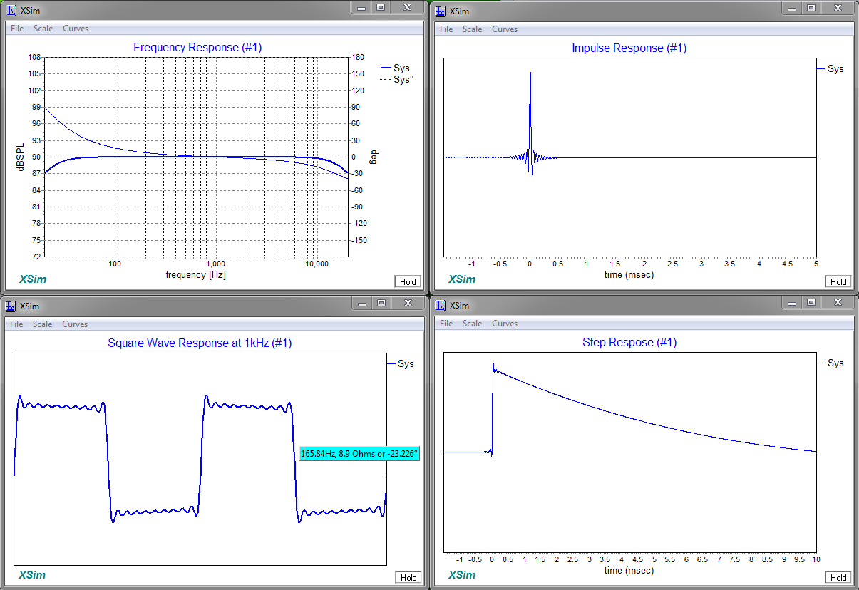

Some visuals, in picture 2 you see one passband device 20-20kHz that is very good preserve waveform, in picture 3 you see same system passband 20-20kHz but blended from two passband devices with a LR4 XO at 2200Hz point as your LS50 have, XO adds a phaseturn that ruin waveform so it now is its own signature and not same as input.
Picture 2 performance is what one can dream of going full ranger but problem is get a driver to cover so much bandwidth is not down the road, a example is response seen in picture 4 which is a Audio Nirvana Super8 Cast Frame from this link Loudspeaker Raw Driver Measurements. HF reach and response is often a mess with big diameter full rangers and probably why first suggestions this thread pointed to less diameter full rangers with woofer support. In picture 5 datasheet from three small diameter full rangers is side by side stretched to same scale and in two X/Y ratios and as seen they better in HF area than 8" diameter.
A XO for small diameter full ranger X'ed to woofer will also add phase turn, arguments for that is alright is normal that the phase turn is below important 700-7000Hz mid area and then better compromise than traditional 2-way with XO point in middle that area.
Using DSP for speaker system XO/EQ/Offsetting can if it has FIR power too repair XO phase turn. So actual if you end visit Overkill Audio it should be possible he can dial in so LS50 gets flat phase as in picture 2 and add one of his subs so when dialed in to rooms mode will replicate fair close to picture 2 on design axis.

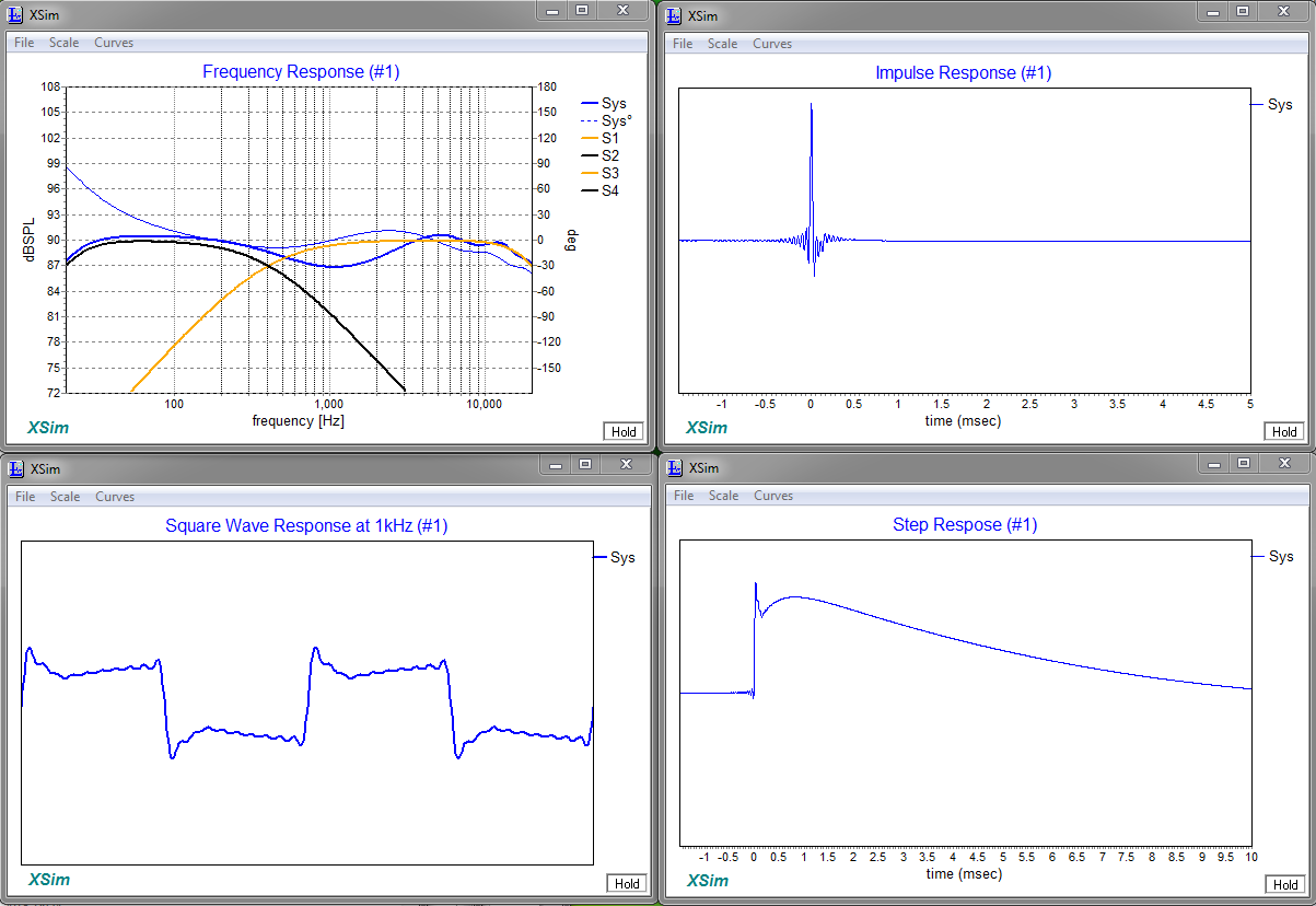

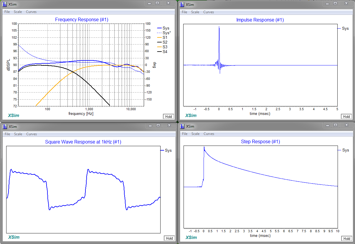

Don't sum as perfect as same filter in electrical domain seen in first XDir picture where ctc is set to zero to model filters electric circuit sum, setting real ctc distance as next four plots show adds tilted lobe and in that XO slope is so shallow that XO power profile is spread over relative wide band.
Slopes needs to be smooth deep over wide octaves but having XO point set low is problem because hard to measure exactly real response in real world room below 500Hz.
Picture 2 BW1 in perfect sum, picture 3 and 4 tweeter respectively 2 inches delayed or in advance show wide band errors.
On the other side DSP can XO in a hurry and repair ringing so XO area power response errors is less.

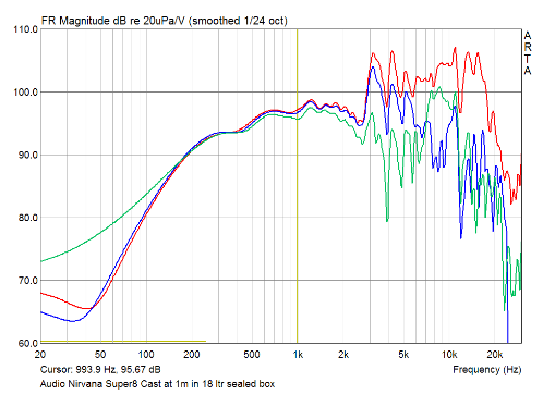

Valid being the key word. All we ask is for substantiation by data of how FF85WKeN has more low level detail and how that data would show TC9FD being "lifeless" and how it loses all the low level detail from the music.
I really didn't want to say anymore, but if we have the pot calling the kettle black...
We have no test for (at least nothing accessible) for measuring low level detail so no graphs or measured data can be presented (by me, you or anyone).
And if we are asking for valid data where is yours? If we believe that the data you have presented is OK, you are making your declarations based on data that only includes the top 5 octaves. Is that valid?

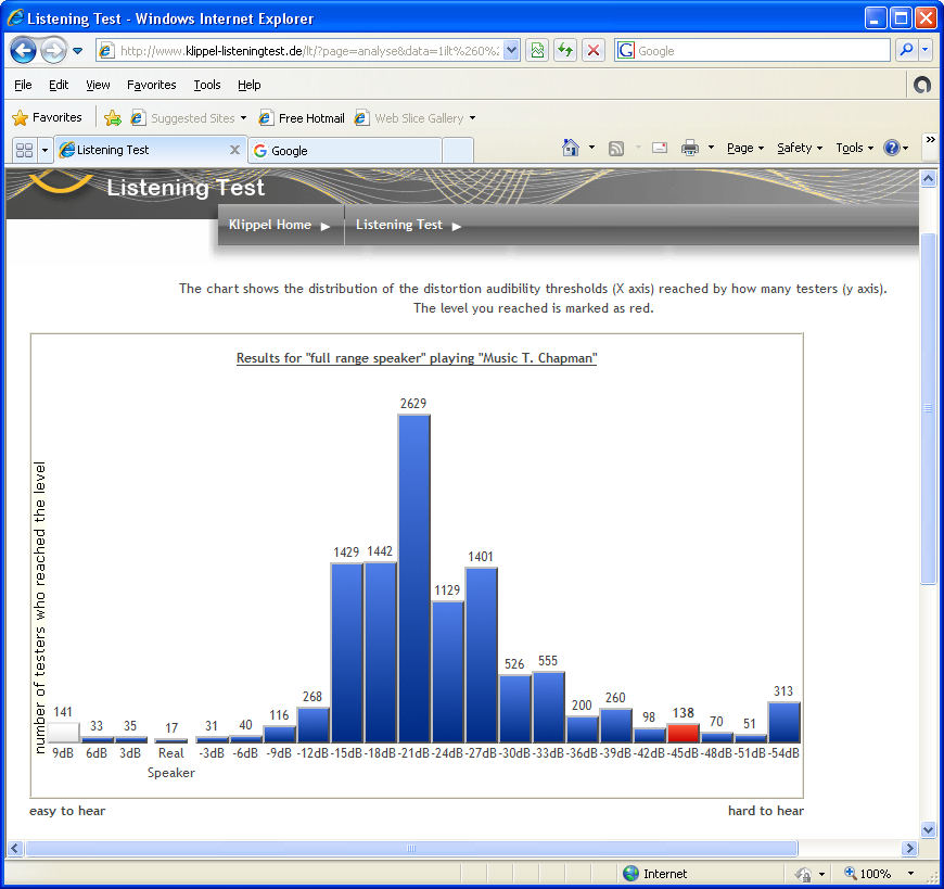

The 10F and TC9 may have similar frequency response shape. But that's where it ends. The measurements show it has much lower levels of HD. Perhaps one of the best 3.5in drivers ever. It also has a cleaner CSD and a tighter IR. All measurable. So to say those two drivers measure the same but sound different is not true. So don't keep pointing that out as an explanation because it's not.
As to availability or feasibility of measuring this so called low level detail. I don't think Planet10 has said that it can be measured ( if it's a real intrinsic property of a driver).
The ear hears frequency response shape as the dominant voicing feature. We are indeed beyond just the FR.
The ears hear harmonic distortion quite well. Despite Planet10 misquoting Gedlee on saying that "distortion measurements are meaningless". In the context of Gedlee's study of a small sample of college students who were asked to see if they could hear the differences in compression driver horns given various levels of HD while listening to the Talking Heads track ( distorted rock music to start). And like all good scientific studies he had a control group? No.
Very good scientific double blind test of HD was developed by Klippel. You should take it. Everyone should know where their HD tolerance baseline is. Mine is -45dB listening to Tracy Chapman on headphones.
I am not taking the decades of experience that P10 has away from him. But if his experience provides guidance of design choice based on unfounded or unproven or unmeasurable quantities of a certain driver while denegrating another driver without data to back it up - then that isn't right.

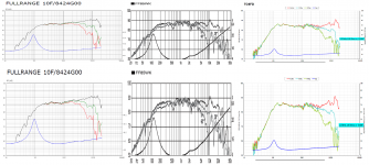

I have a proposal to make. I will personally buy a pair of Enabled FF85WKeN from you, assuming you have some in stock or can make them, and judge for myself how it sounds in a FAST. I have heard nothing but praises for this driver and want to see what it's all about. If not available immediately, it's not a big rush. I will send you PM.
Who knows, maybe I will have a new favorite driver for the reference monitor 10F/8424 RS225 FAST?
