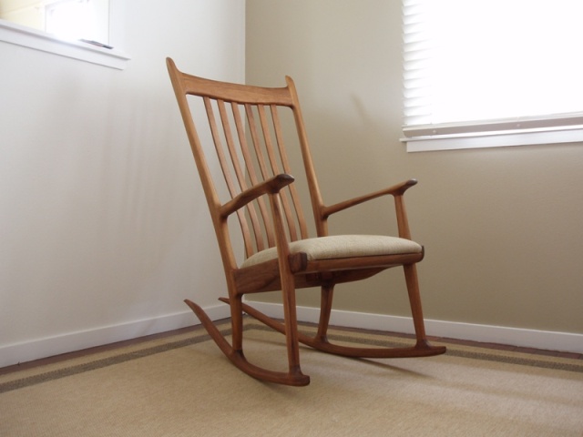

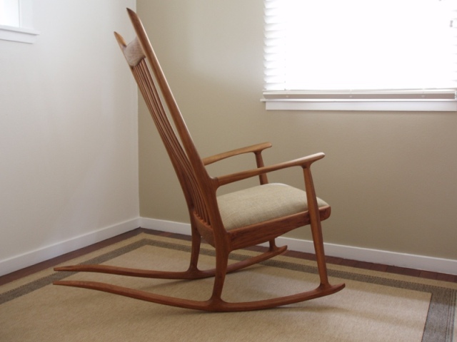

I have attached a couple of photos of my latest woodworking project.

That my friend is one nice rocker! Excellent work. I too work with wood, as a hobby, and am interested in building speakers. Mainly because I just built an entertainment center and now would like speakers to match.

Tasmanian blackwood. Wow! What's that rocker made of?
Hi tdr1213,
Thanks for the compliment.
The rocker is also made from Tasmanian Blackwood. Highly regarded as one of the best timbers Australia has to offer for instrument making.
