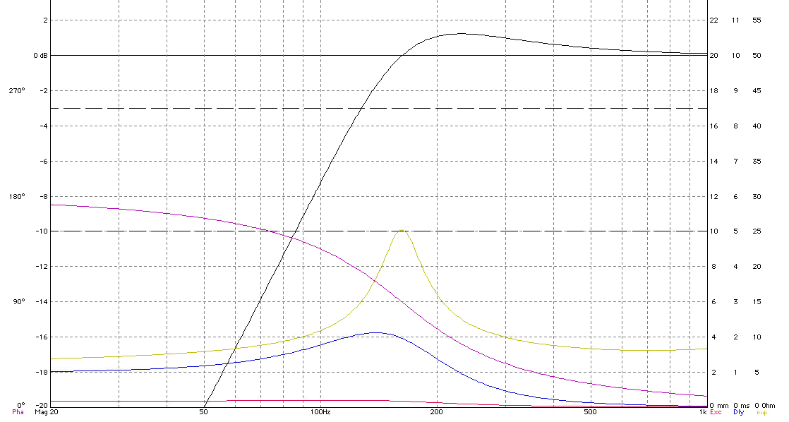

A PR is a port substitute in a BR. Neither the Visaton or Beyma are suitable for BR.
Attached is the sim of BG 17 in 10 litre sealed. F6 about 105, F10 88. This is not as low as the FF85wk in an oprimum reflex and it is considered to have no real bass.
A bit of extention and a bit less of a hump could be had with aperiodic loading, but the hump is not as bad as i guessed. Itmay be enuff to give the illusion of bass.
Trying to make it BR would make it worse, so no PRs no ports.
dave
