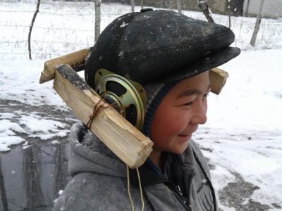

something like this ?
(joke of course)
Only slightly cruder than the set I made.
