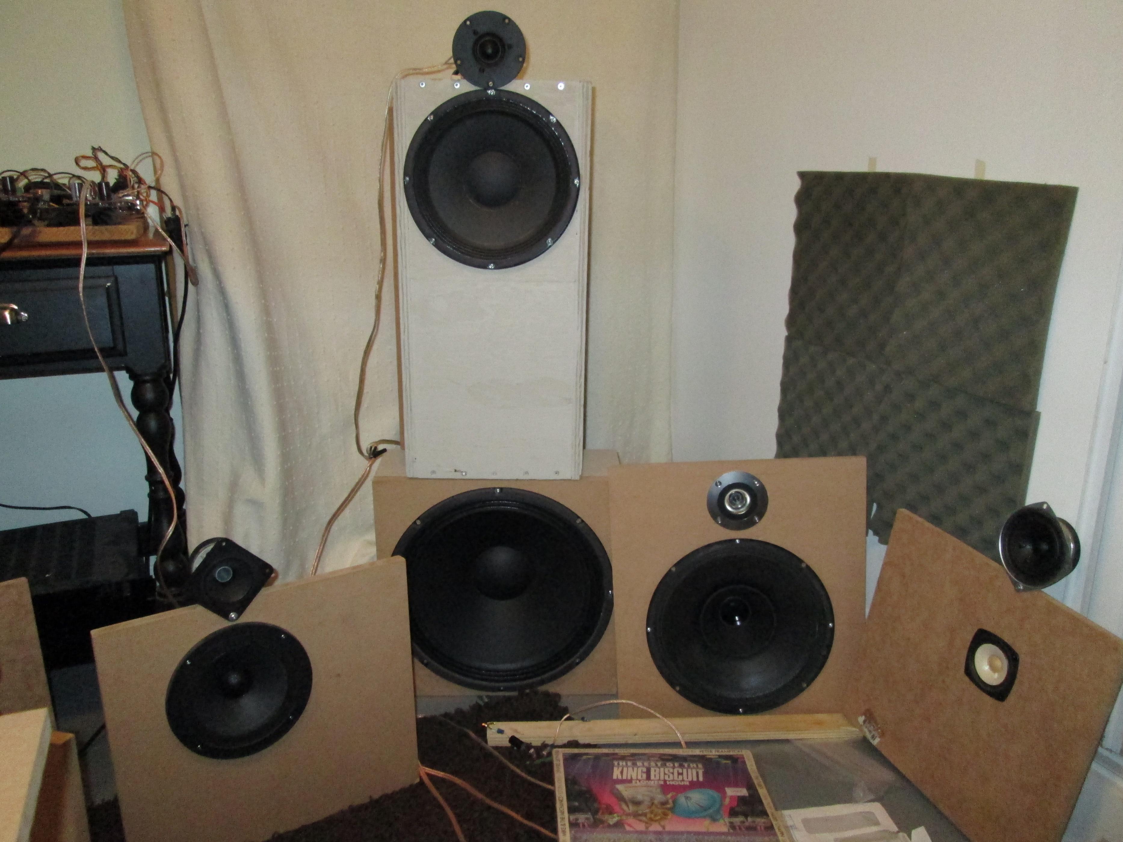

This is an interesting topic. I hope more can chime in. As a newbie to OB and with my recent OB experiences, I used to think like you. So my previous baffles is always big. I tried 20''x40'', 24''x48'', 32''x38'' only for the FR and Sub in a separate H-frame. The sound is good.
A few days ago, I tried out an experiment by mounting an 8'' FR driver on a smaller baffle at 16''x18'' and put them on top of the H-frame woofer. The sound is much more open with wider soundstage. I'm very surprised with the sonic result. I will try to experiment with the rest of FR collections that I have to see what the difference does it make b/w big and small for each driver so far my experiment going from big to small is significant for 1 FR that I tried. Edge software also shows a flatter response with the small baffle that I tried, it has a high peak but at lower frequency which can XO with a sub

How big can your baffle be?
I have to admit, that is actually why I thought about open baffle.. Less woodwork. I mentioned I'm rehabbing a house, and was actually hoping to 'throw something together' with some sheets of plywood and a couple drivers, just to have some music while I work. But speakers are complex! (at least to me.. I'm better w/ the EE amp design stuff than speaker physics.. maybe I should just build a more powerful amp for the woofers (but I can't until after the house project))
It'll be in a big open hardwood floor, high ceiling room. No furniture or anything in it now..
So, now nothing really matters.. I could make wall sized baffles and it won't get in the way at the moment. But, after construction for my speakers I'm going to live with.... I don't know. Maybe between two and three feet wide would be the max the wife would put up with.
So, the baffle/cabinet can change later.. But I don't want to waste money on drivers I won't use for my final speakers. I'd probably use a big flat panel for now to keep it simple, then design a U or H frame for the woofer to get them smaller later.

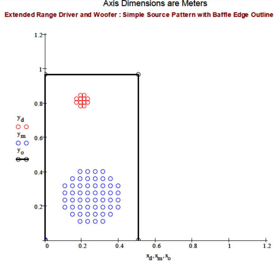

Absolutely. The OP should start here Electro-acoustic modelsBasically I assert that mounting a full ranger centrally on a big planar OB is bad (or at least has some big flaws)

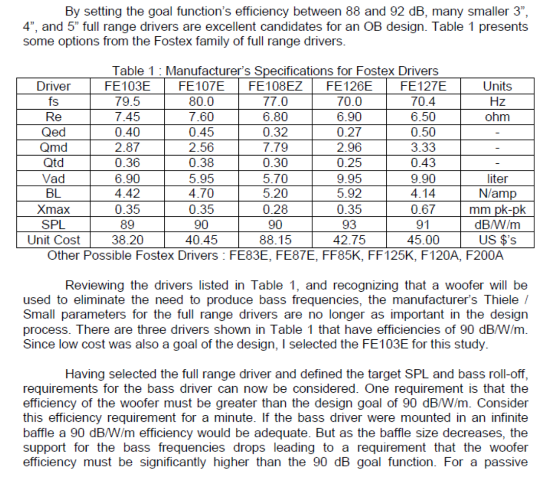

View attachment OB_Design_Part_1.pdf

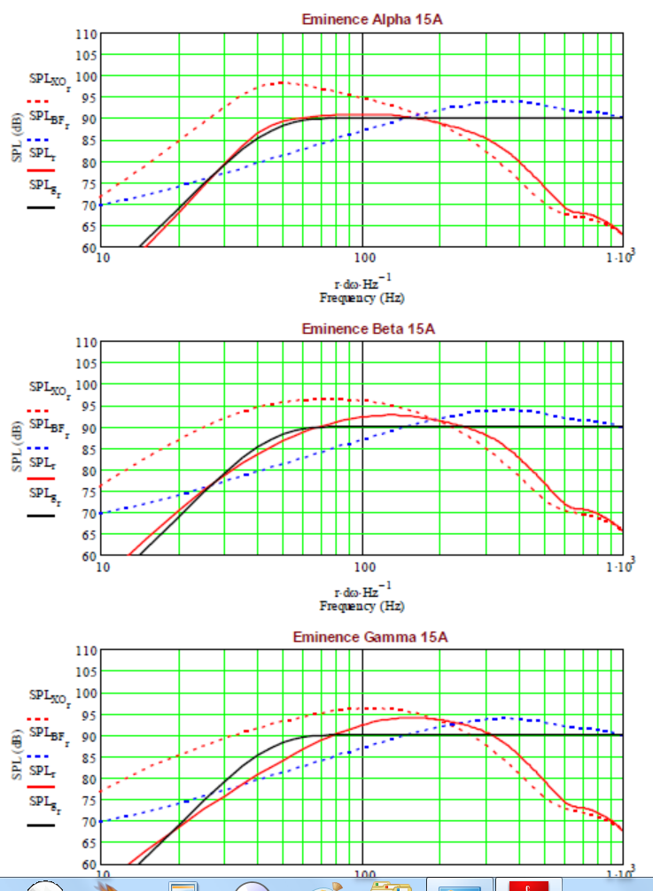

Nelson liked the B15s
In his slot loaded:
In his slot loaded:

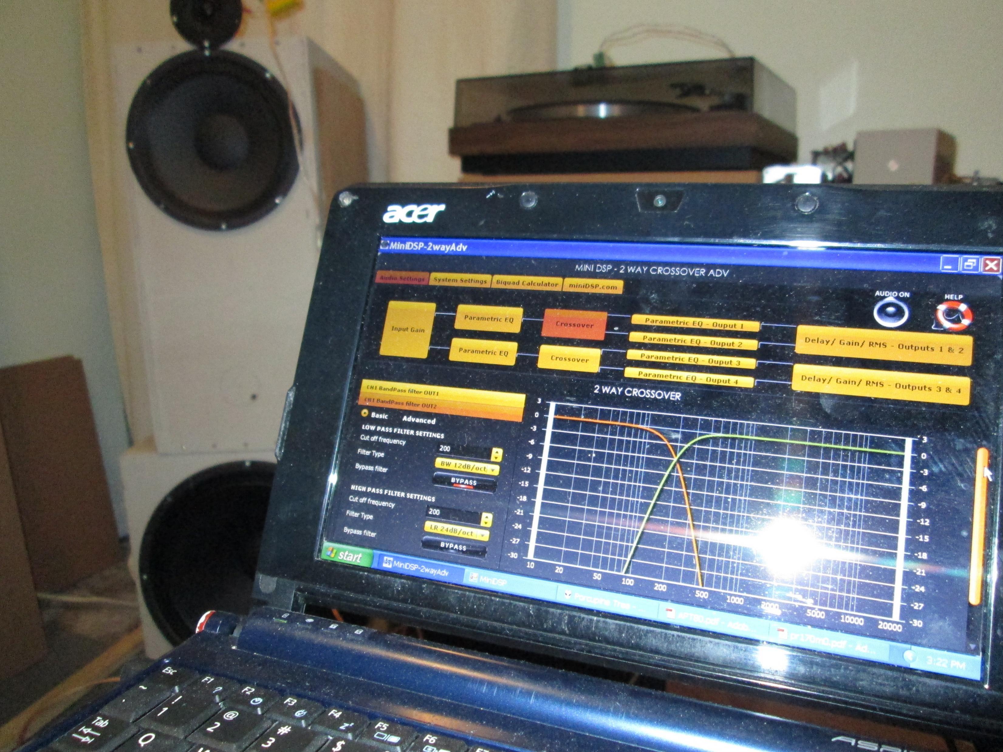

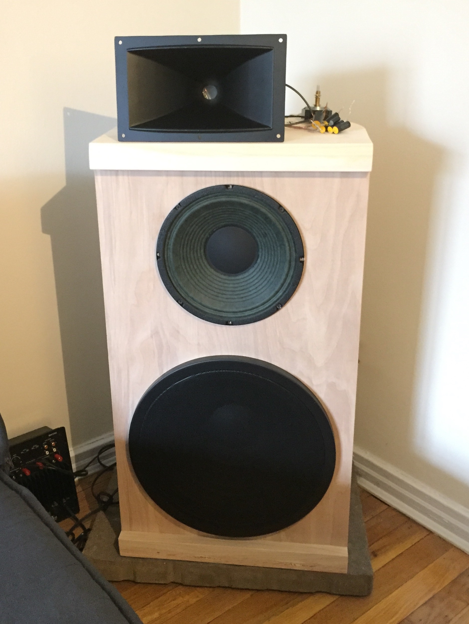

I ended up making H frame's. I'm powering the woofers w/ a 60 watt per channel amp. My dads old Sansui 881 that I cleaned up and recapped a few years ago (and never really used). The full range on top is powered by a 6ish watt per channel single ended amp. I've been playing w/ a lot of different speakers on top. From some 3" - 6" fostex, to some other random drivers + tweeter, to some commercial small bookshelf speakers.
The H frames gave me a lot of trouble when I first tried them. Some spots in the room sounded good, but others were lacking bass. Moving them further away from the wall made a big difference. They sound great.
The minidsp HD, with FIR filters is amazing! I'm an analog purist in some ways, and don't think I'll be putting it between my turntable and tube amps, but for digital music, why not add DSP... It's a very fun toy.
I'm quite happy w/ my first experience bi-amping with a digital crossover, and DSP room correction.

Today, after listening to a few more types of music, I added a good ole' boxed (ported) sub. At some point the H frames give up.. I haven't measured yet to see exactly where.
I listen to all sorts of music.. a lot of classical and jazz, and love piano of both those genre (Chopan, Bill Evans, etc). That's what I've been listening to, and they sound amazing. But, I also love electronic music. And today I needed to get some work done and put on some bass heavy electronic music, and at some frequencies the woofer cones are violently shaking, but I don't hear anything. The subwoofer immediately corrected that issue.
I think a sub is simply a necessity in a lot of situations (maybe most...). Not necessarily a boxed plate amp style sub.. But something else to reproduce the lowest frequencies. I haven't ever heard a horn or open baffle type speaker that can reproduce the full spectrum, all the way down to 20hz, with a flat volume response. I have very limited experience, though.
Are you sure that minidsp FIR sounds good? I personally feel IIR sounds more analog filter like in many cases...
I'm using IIR for the crossover and most EQ and everything. Then a bit of FIR to finish matching it to the room and correct some phase issues.
