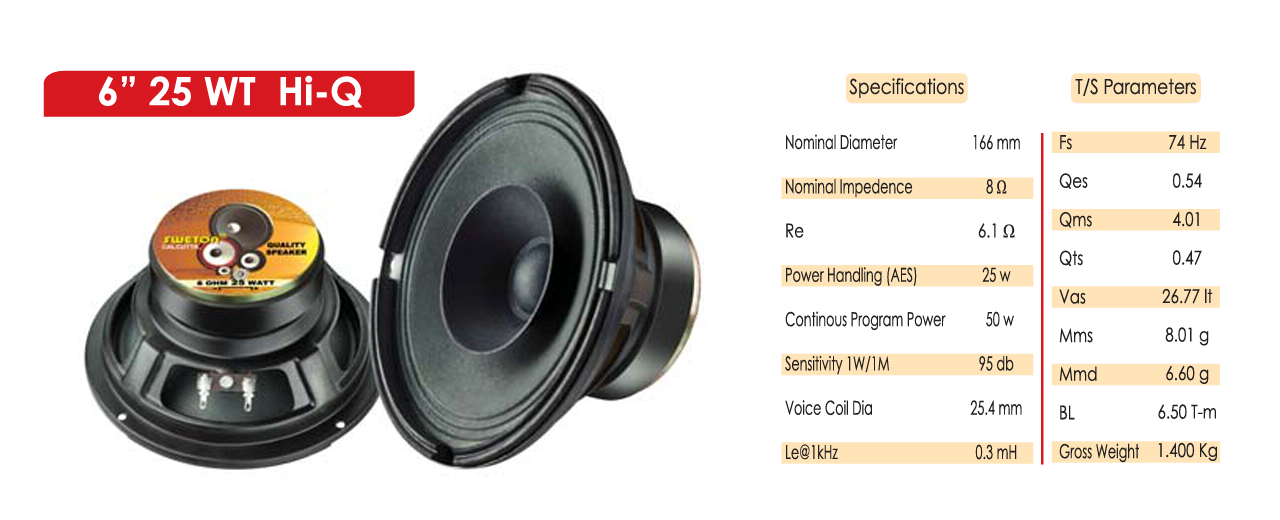

Hi everyone🙂 Straight to the question, although it has whizzer, lighter cone, low mms and mmd; there is no information about that on the manufacturer website, not even full t/s parameter and frequency graph. Is it a full range driver?

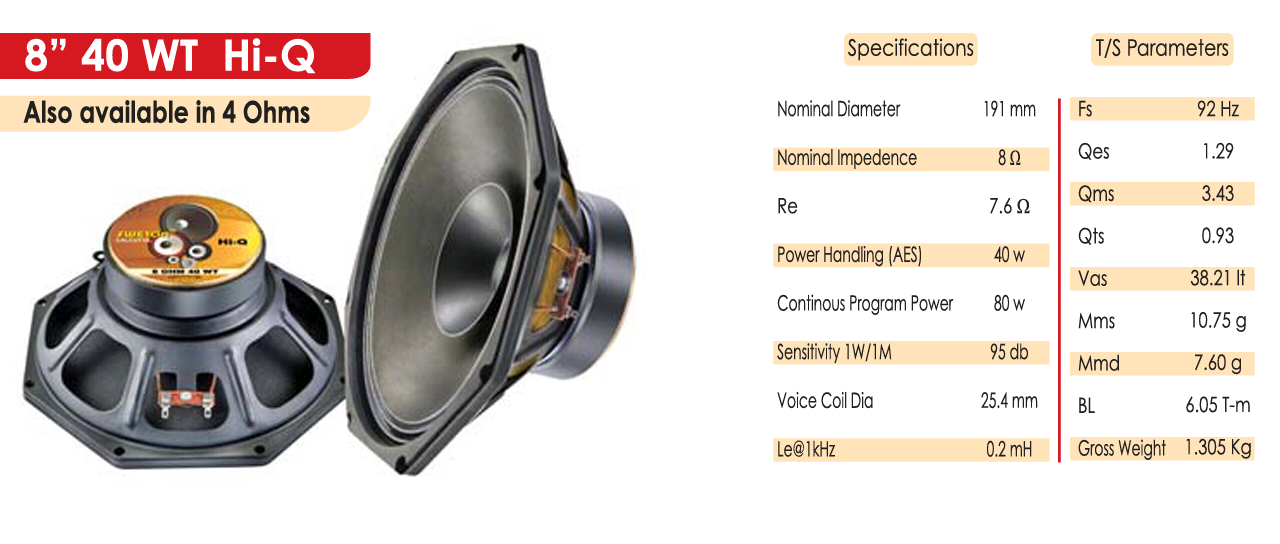

The 8"40WT Hi-Q is referred to by the manufacturer as "FullRange Speaker. Ideal for Cinema halls, Auditoriums, Malls, Public announcement system etc."
There's no specific suggestion that this driver is intended for use in Hi-Fi applications and no reason to doubt its efficacy in its intended applications.

Hi, it's nice to talk to you again 🙂 Sorry but i think you did not read my posts properly. i was saying about the former one (6inch 25W HI-Q, please see the attachment). Actually i want to make a woofer assisted wide-range system(woofer+fullrange). Do you think it's a fullrange driver? The manufacturer did not provide any information in this regard.

No, it doesn't help. Nor (obviously) do you want to hear that. Unfortunately, it happens to be a fact. I understand your question perfectly well. You asked if it's a 'fullrange'. The answer is
1/ There is no industry definition for 'fullrange', so manufacturers can call anything they like a 'fullrange' product, and
2/ It doesn't have any meaning beyond the obvious fact that it's a 6in driver with a nominal 25w power rating.

I did read your posts carefully. 😎 The similarity of the 6" version with the 8" version leads me to believe it is purposed for exactly the same applications as the 8" version.
But they do. The fact that the 6" driver features in the 'Full Range Speaker' section of the manufacturer's catalogue implies that they think it is a full range driver!
I think you really want to know is exactly how full range it is and, as you realise, there's no way of knowing without a frequency response graph.

The 2nd driver looks very much like a clone of the old Philips 8” FR.
From looking at them i would chose the 6”, it likely is more extended than the larger one. With the accordian surround it should be good in the midrange, potentially somewhat limited on the bottom. But if you are adding a woofer it is a good place to start i would say.

When I went to the home page Sweton -Transducers Since 1982 :: Pro Loudspeakers | Home Loudspeakers and scrolled to the bottom I found 'Full Range Speaker' under the 'Recent Tags' heading. You are correct that it takes you to the 'Speaker Series' page, but all the drivers therein could reasonably be called 'full range' (although certainly lacking in bass extension).
Do you mean that there's no difference between simple speaker and fullrange driver?
What's to stop a simple speaker being classed as 'full range'? After all, they are used in radios to good effect. The question is, how full range is full range? Unfortunately, the manufacturer doesn't tell us!
If the price is right, I would take a chance on the 6" version for your application. 🙂
