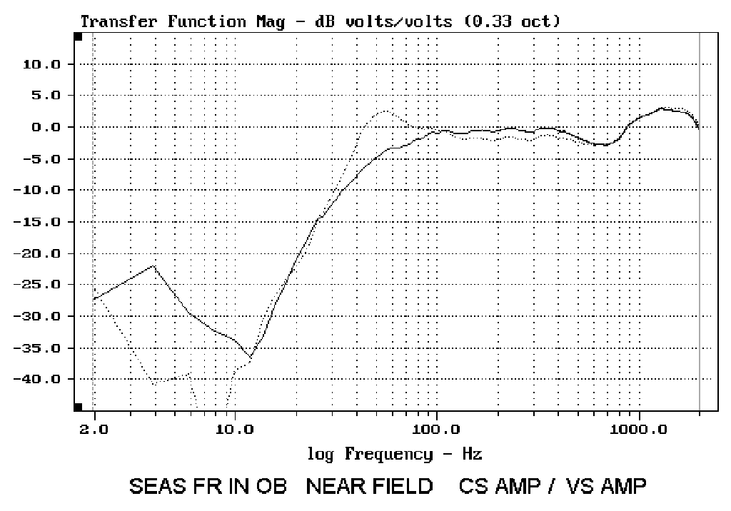

I also think series resistors are bad per se. My main 3-way system runs with a low Qts wideranger and 3.3 Ohm series resistor that brings it to Qts = 0.5. Sounds much less stressed, much more relaxed.
I have run into this observation more than once - Jon ver
Halen has commented that series resistance "sucks the life
out" as an example.
And yet Thevenin equivalency is clear that there is no
difference between a perfect voltage source in series with
a resistor and a perfect current source in parallel with the
same resistor. If there is a difference then we have to
presume that there is either a failure in the perfection of
the cs and/or vs or a flaw in the test / listener.
Sorry, I didn't post carefully enough. Wanted to say "I also don't think series are bad per se. But that too high values "suck out life" is true. The character of this driver before was a bit what a naim lover calls "energy", I don't like that kind of sound. I didn't make such experiments with other drivers, but with this driver +/- 0.3 Ohm was clearly audible (in the midrange, I don't speak about bass response). Are there different paper mixes that demand weaker/stronger motors?

Yes, I tried equalization instead of simple L/R circuits. They do work, but any such circuits would require to be "sandwiched" between two buffer blocks for the best effect, which works well if you use J-fet (or even tube) buffers (I do not prefer opamps). My Open baffle (120x50cm-flat baffle) consists of The Eminence Beta 15 for the bass and Visaton B200 for the highs. It is biamped, so that the the Beta is driven by a voltage source amp (Sony TA-N511) while Visaton is driven by Zen V9 without feedback, i.e. current amp. The whole thing is now actively crossed over, though during the last two years I have been playing with various crossover combination (slopes, frequencies, active, passive, hybrid). The difference, V/I: Current drive changes the damping (hence bass) and the tonal character of the driver, often for the better. In my case, only the fullrange (above 150 Hz) is driven with the current amp, so no effect on the bass here, but some nice things happen in the upper registers as well. Somehow it sounds more musical, there is more "air', it just sounds more natural and less strident. Also, there is a bit of compensation here as well, in order to correct for fullrange nasties. There is Zobel (C+R) in parallell with speaker terminal (B200) to correct for its rising response.
On the paper, you would see that Zen V9 without feedback has actually more distortion than with feedback. However, at normal volumes I do not find it distracting. To me, connecting the feedback (this making it a conventional voltage amp) makes it sound more 'solid' and loose that 'breath of air that makes some instruments sound so lively....

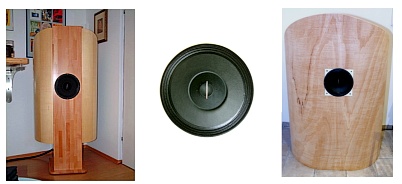

I have TB-W8-1808 in 24 inch wide OB without any kind of filter.
My amp is a factory (kitchen) buildt F4.😉
The low end is taken care of with a pair of Klipsch RSW-10d subwoofers.
It sounds fantastic. But after reading the article about fullrange&current source i was curious.
