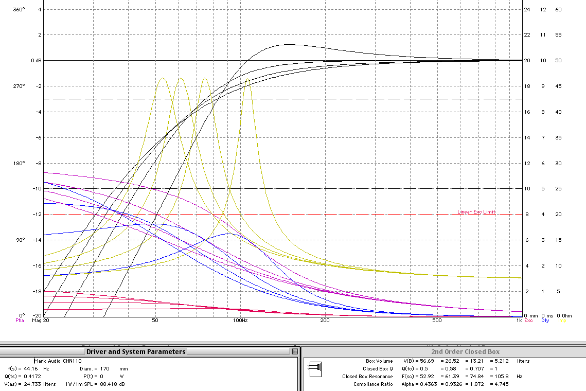

Yes, forgot about CHN-110. A really good driver and not that expensive,
attachment.php
Looks like about a 10 liitre sealedbox for max flat response.
