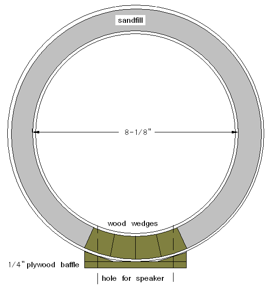

Awesome! I have though of, but never done, a speaker using these tubes. I too thought there would be vibration, so my imaginings were with two sono tubes, 8" and 10", concentric with sand or concrete between them. Just a thought.
That's a terrific idea, jrenkin!
I decided to allow the enclosure to do whatever it wanted as an experiment in minimal design. I've read of speaker enclosure that are designed to resonate in order to enhance the speaker. Seems, in this case, it hasn't done any harm.
I'll have to give your idea a whirl. :)

Very nice. You may want "wood wedges" in the back too. It would help keep things aligned and give you something to mount binding posts through if you didn't want the wires entering top or bottom. I don't like loose wires, so posts at the back seems more elegant to me.
