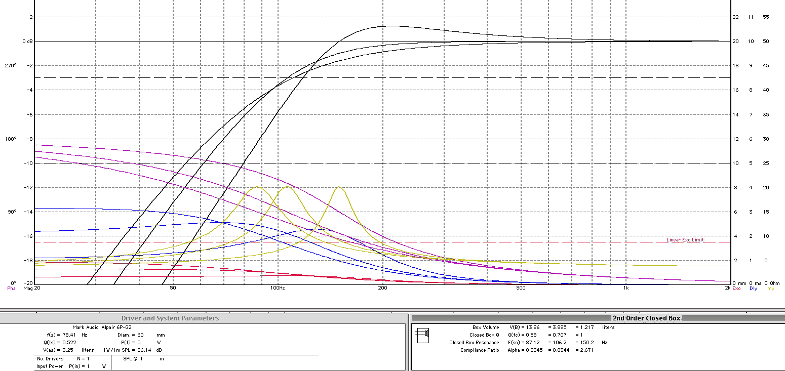

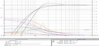

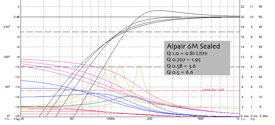

The larger box would allow one to get more out of the Alpair 6.2, my personal pref is the paper version. And i would attempt a vented alignment to max out the advantage of the larger than expected box and using the Alpair.
Sealed sims for both A6.2 attached.
