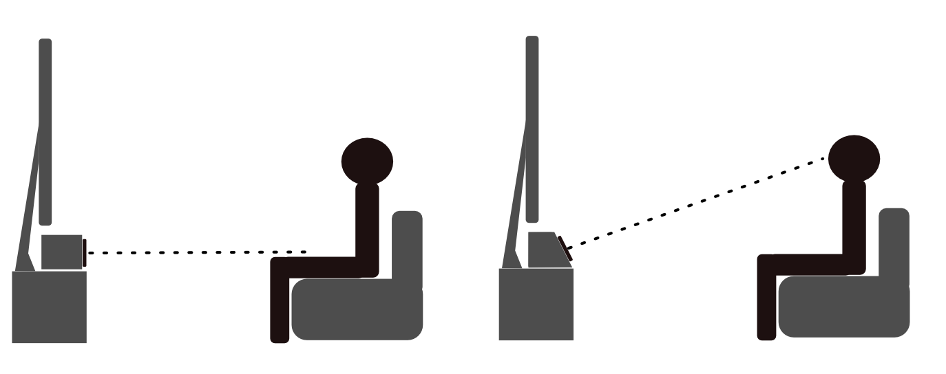

Sorry if I'm dense, but can you clarify? "On axis" meaning the centers of the drivers are on the same vertical axis? or horizontal axis? or other?
"A bit of extra EQ on the top" means more power to the driver that's physically on top? or on the higher frequencies? or other?

Eric,
a picture might be easier here (sorry for the crude pictogram). On the left, the driver mounted under the TV will usually fire too low, and the on-axis is around your waist. That means that your ears are off-axis and the higher frequencies will drop off because most full range drivers will beam at higher frequencies and lose intensity when you move off-axis.
On the right, if you angle the baffle, it will give you more area to mount the driver, and it will be closer to on-axis to your ears.
attachment.php
If this graph of the A10P is anywhere close to reality, then you'd want to have your ears between 5 and 15 degrees off axis. It also will depend on your sitting position's distance from the driver and your listening preferences.

I’ve used singles of both A7.3 and A10.3 as centre channel (Lo passed as high as 100), and would definitely recommend the larger of the two if you can accommodate the enclosure size. Mine is a variation on one of the centre enclosures to which Dave posted a link to previously, with the front panel slanted up at 5dg.
