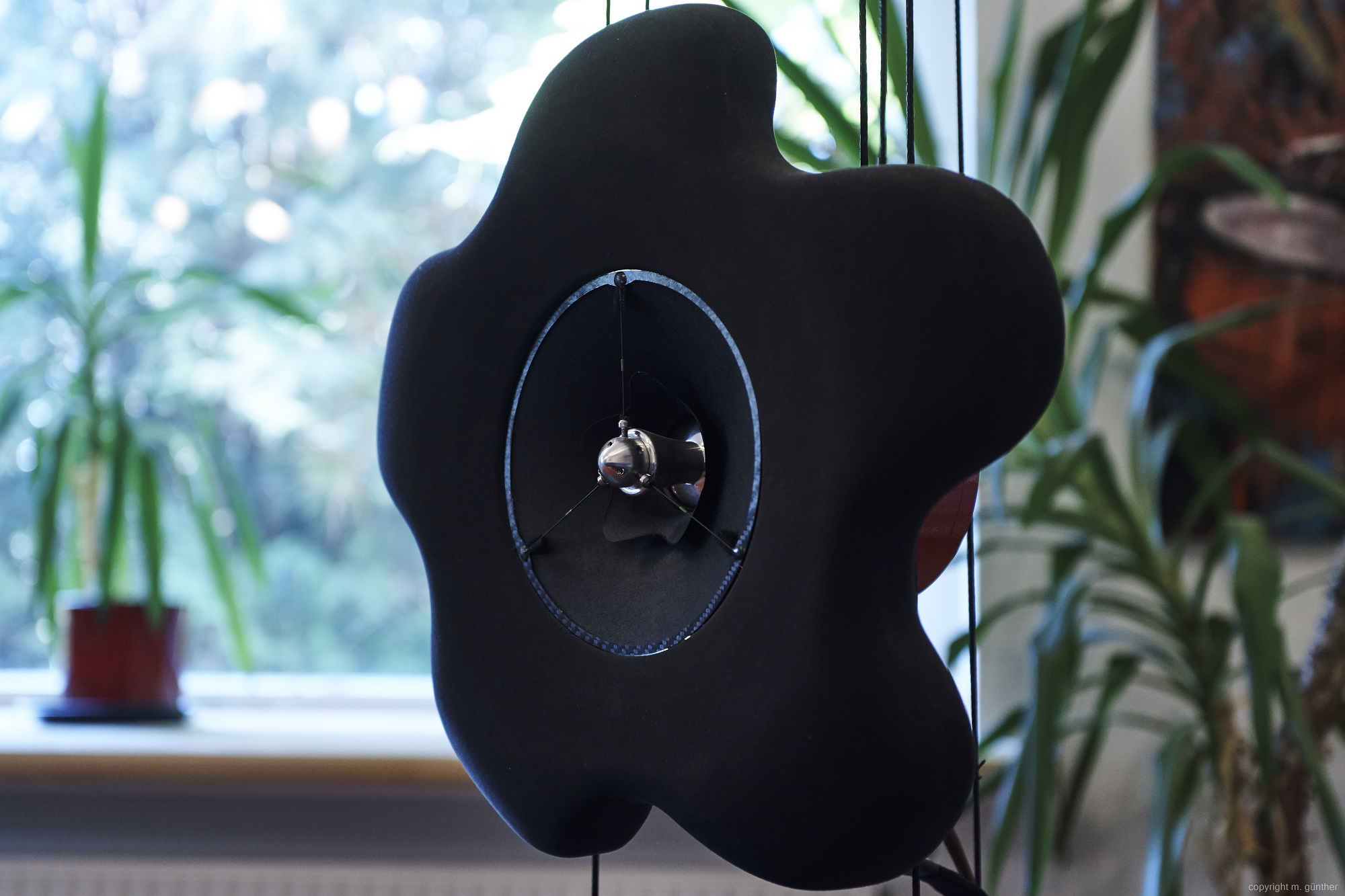

Here is another interesting option. No felt here, but interesting building material and shape to deal with baffle diffraction. Can't find where Mattes gave more build details, but an interesting thread indeed.Well now I’m interested. Would you mind sharing your thoughts on the ideal baffle for full range?
I’ve edited the thread name slightly
EVA foam for performance speaker enclosures
Some have been asking about details here and there, and I gave some details here and there. Some have required a lot of information by PM and have, after receipt of same, never responded again.
The aim of my baffles was to reduce the negative influences of a baffle (as it has been correctly explained by Dr. Lindgren) as far as possible, by choosing shape and material accordingly, while paying special attention to the region where the cone mets the baffle. This should, in my opinion, be a smooth transition without steps, edges etc.
If I will ever make an improved version, I will take even greater care about this area with the aim to have an uninterrupted smooth shape from voicecoil to baffle edge.
All the best
Mattes
